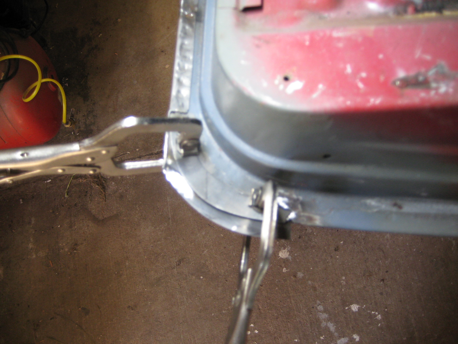

    After a bit of final fitting, tacked in place.

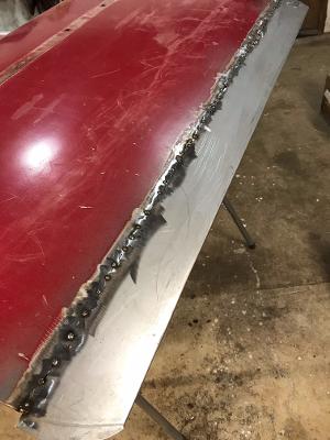

    Since it warmed up to the mid 40's today, did some grinding/smoothing on the welds.

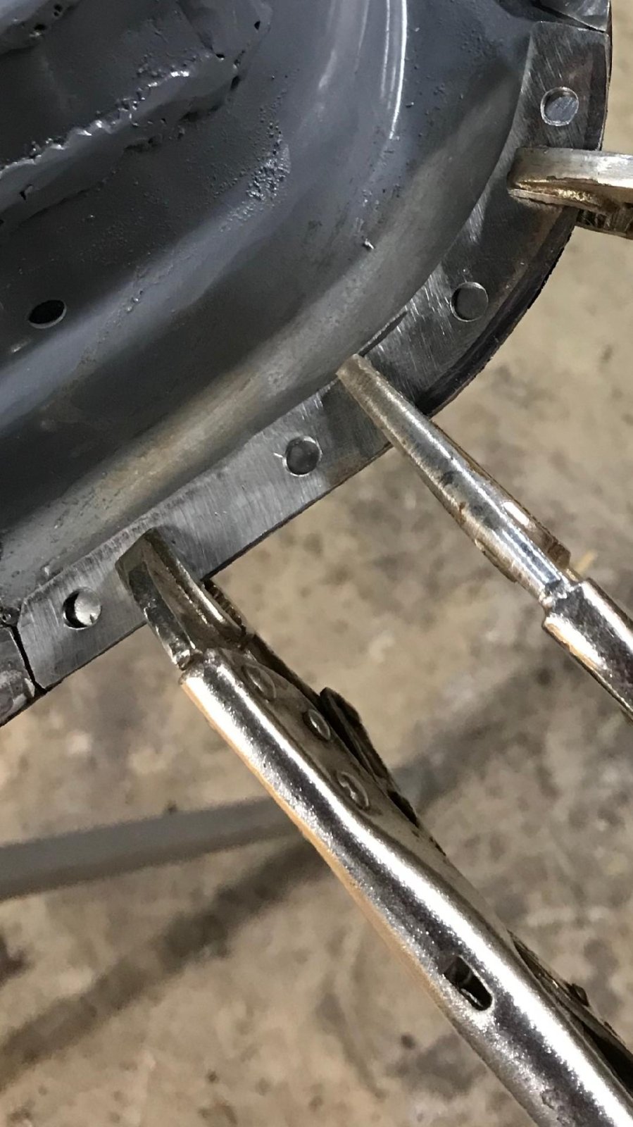

    Back on some more work on the passenger door, just cleaning up the ends where the panel is not a great fit.
    Still more grinding and finishing, will need some filler work before paint, but at least the rust will be gone.

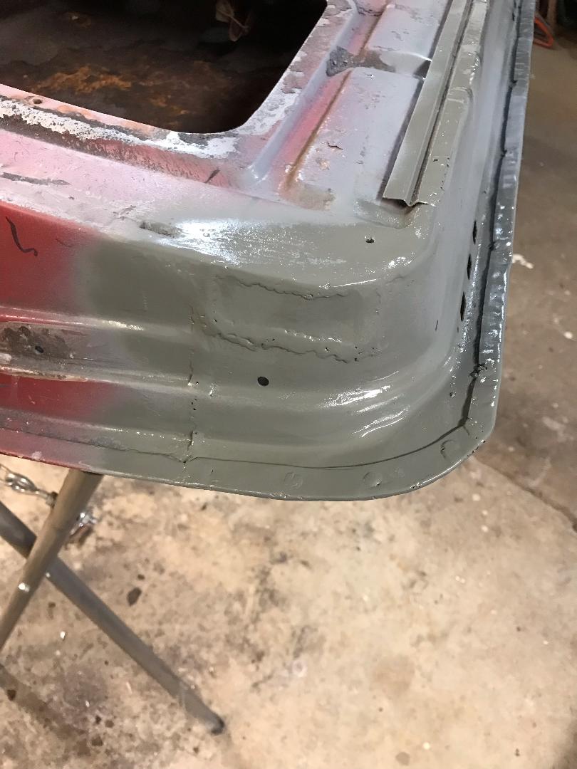

    A little more filling of some pinholes and some primer to cover the bare metal for the time being and the rough rust work on this door is finished.
  8. Vintage Amercian Iron
    Joined: Feb 21, 2017
    Posts: 165
    Some better pics after the primer was done drying.
    Passenger side 53.jpg Passenger side 54.jpg Passenger side 57.jpg Passenger side 55.jpg Passenger side 56.jpg

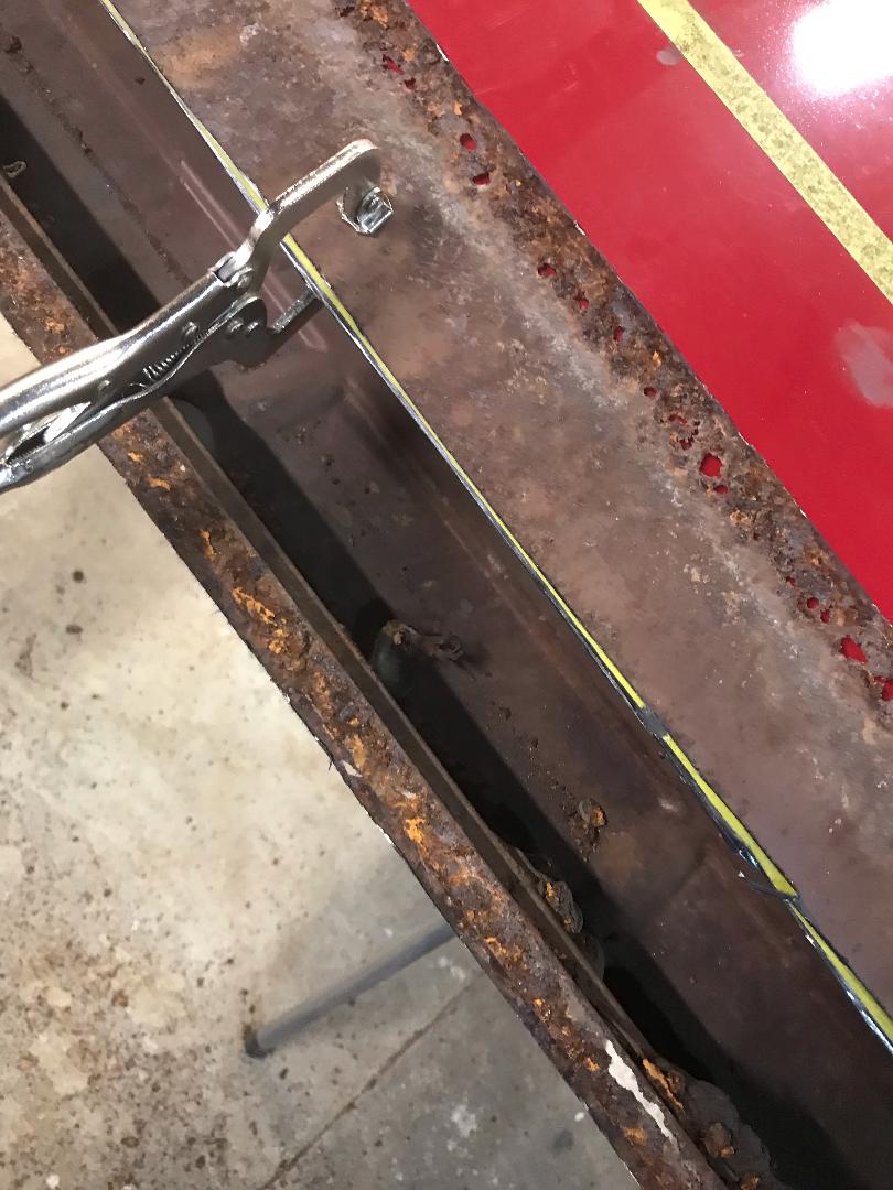

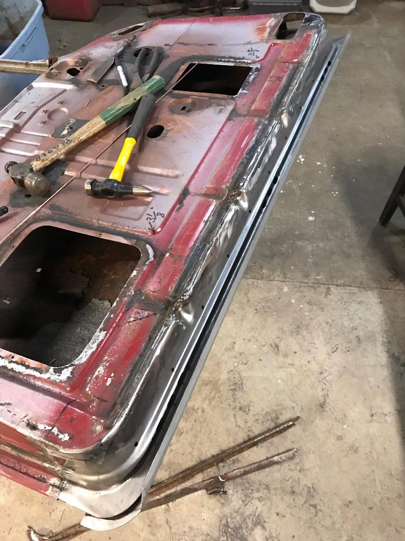

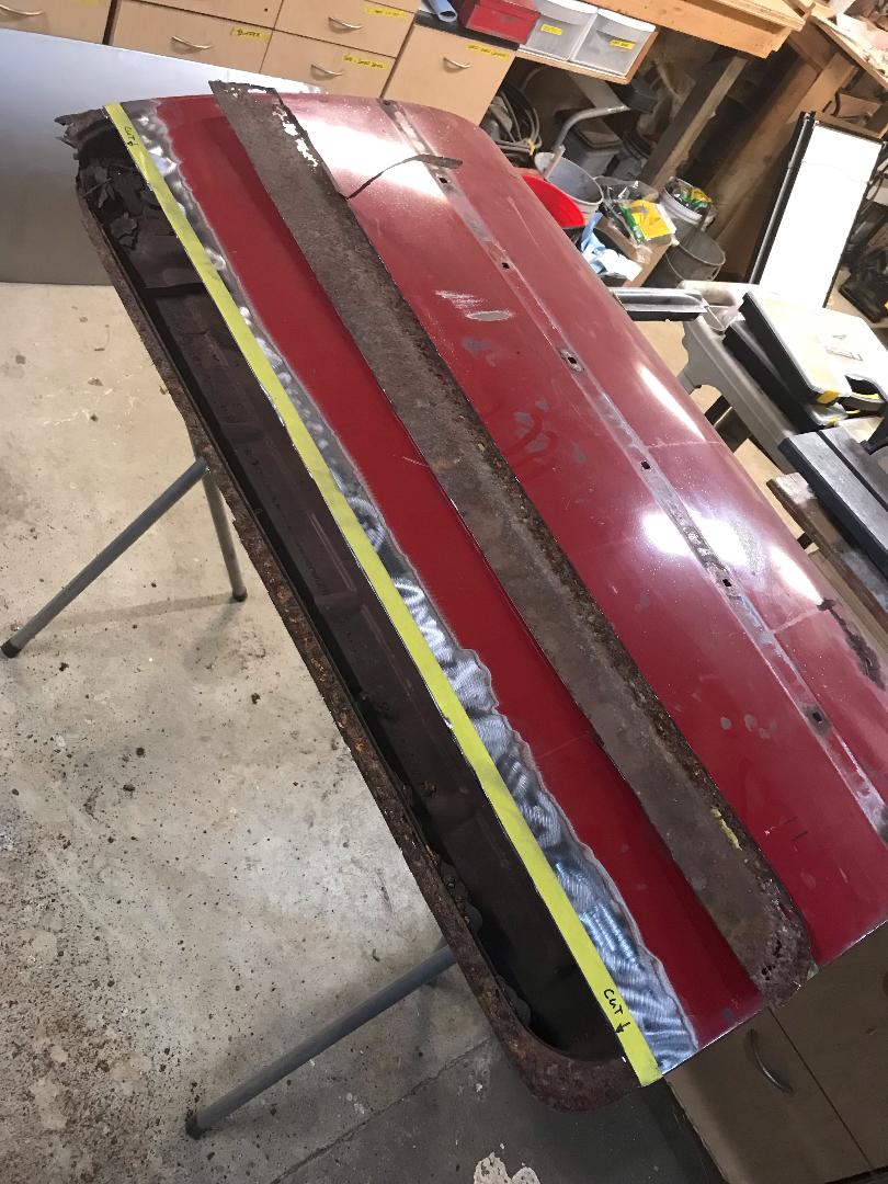

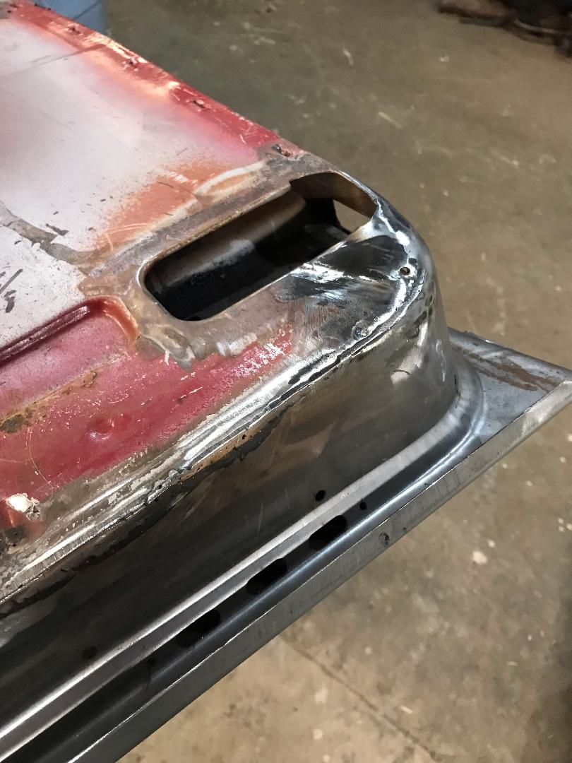

    Break from the "Honey-to-do's," and back to some rust work on the driver door bottom & skin.
    IMG_2687.JPG IMG_2688.JPG IMG_2692.JPG IMG_2698.JPG IMG_2703.JPG IMG_2706.JPG
    chryslerfan55 and Squablow like this.
  15. Vintage Amercian Iron
    Posts: 165

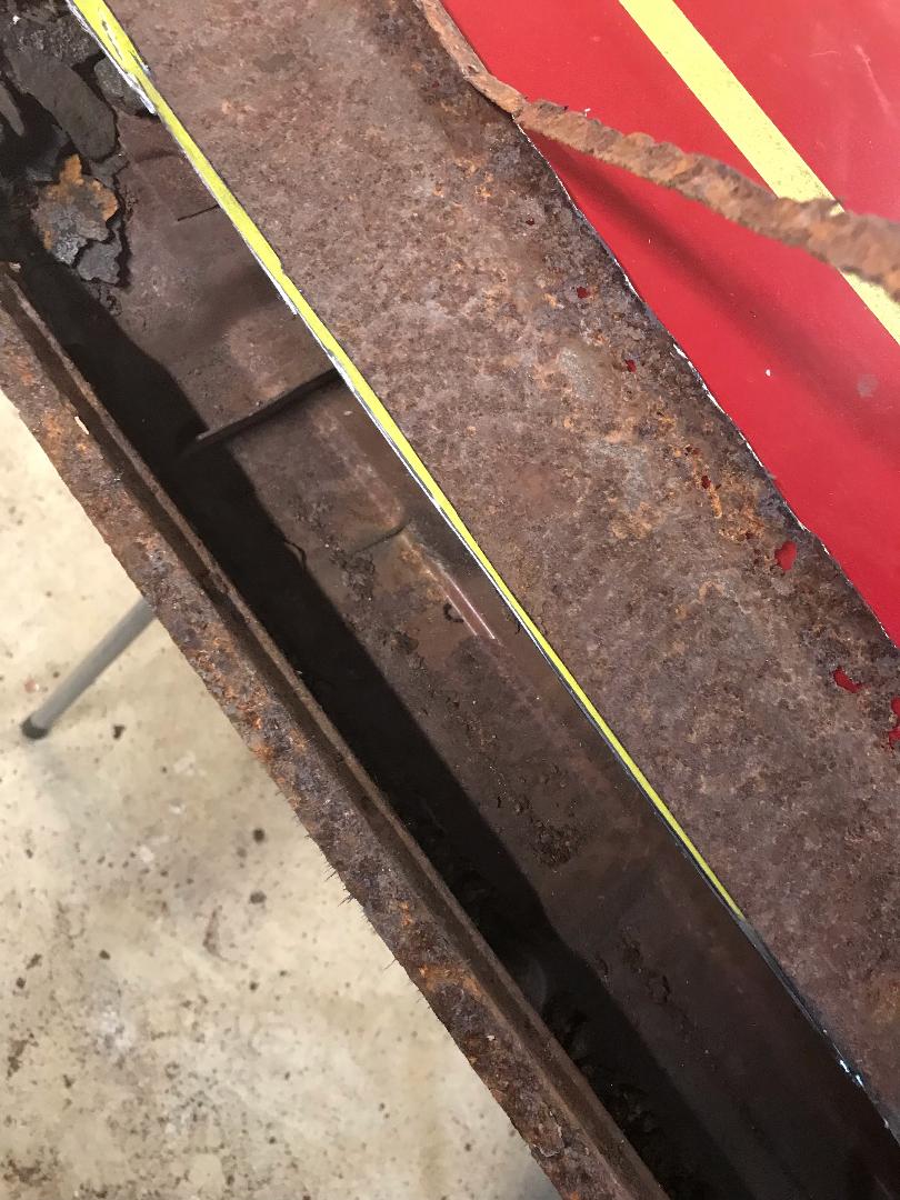

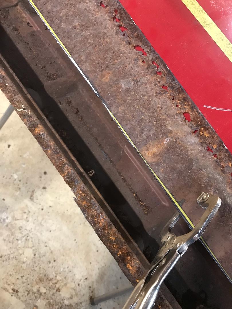

    Looking for some solid metal to cut to...

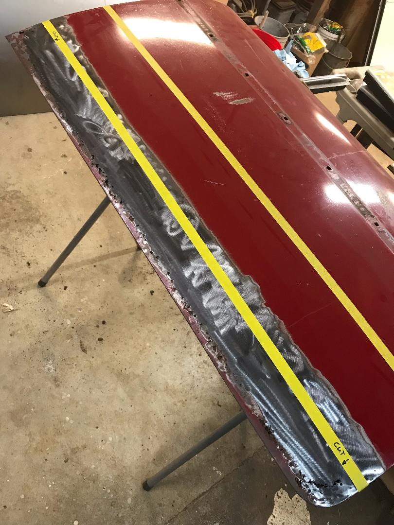

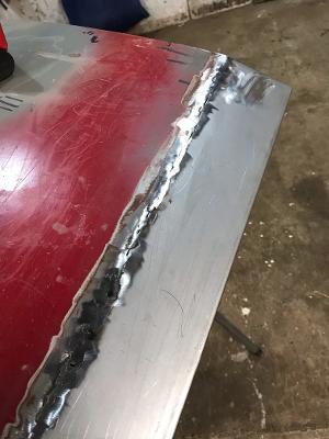

    Spent a little time working on the door skin bottom. Had a few pin holes show in the weld, but will take care of them later, time to flip it over and start on the lower inner side rust. IMG_6174.JPG IMG_6175.JPG

    Had a little time between other projects and after yesterday's primer had dried, I noticed a few more pinholes than I originally thought, so cleaned those spots off and filled them. Sadly, one of my grinders gave up the ghost in the process [​IMG]

    Is that weld-through primer? If it's regular etch or epoxy, you probably should grind it back a bit before welding up pinholes, I've heard the gasses that stuff gives off when burnt is bad for you. Looks like a good repair though.
    Outback likes this.

    Thanks!
    Nope, not weld through primer, like I said above I cleaned them off then filled them, that was when my grinder died...

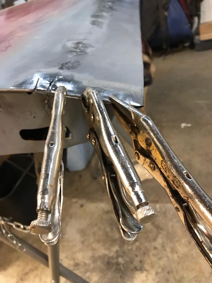

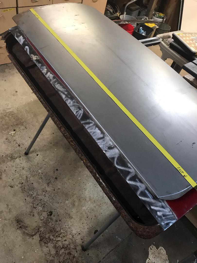

    Started on cutting out & fitting the inside door bottom.
    Got close then stopped for the night while the inner door area that was surface rusted soaks in some Ospho.

    Got the inside bottom cut to fit close and welded it. Also started doing a little smoothing of the weld seam.

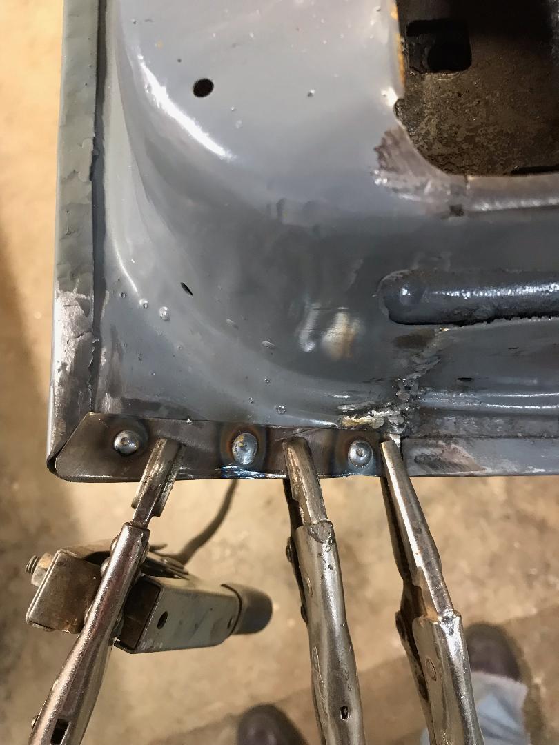

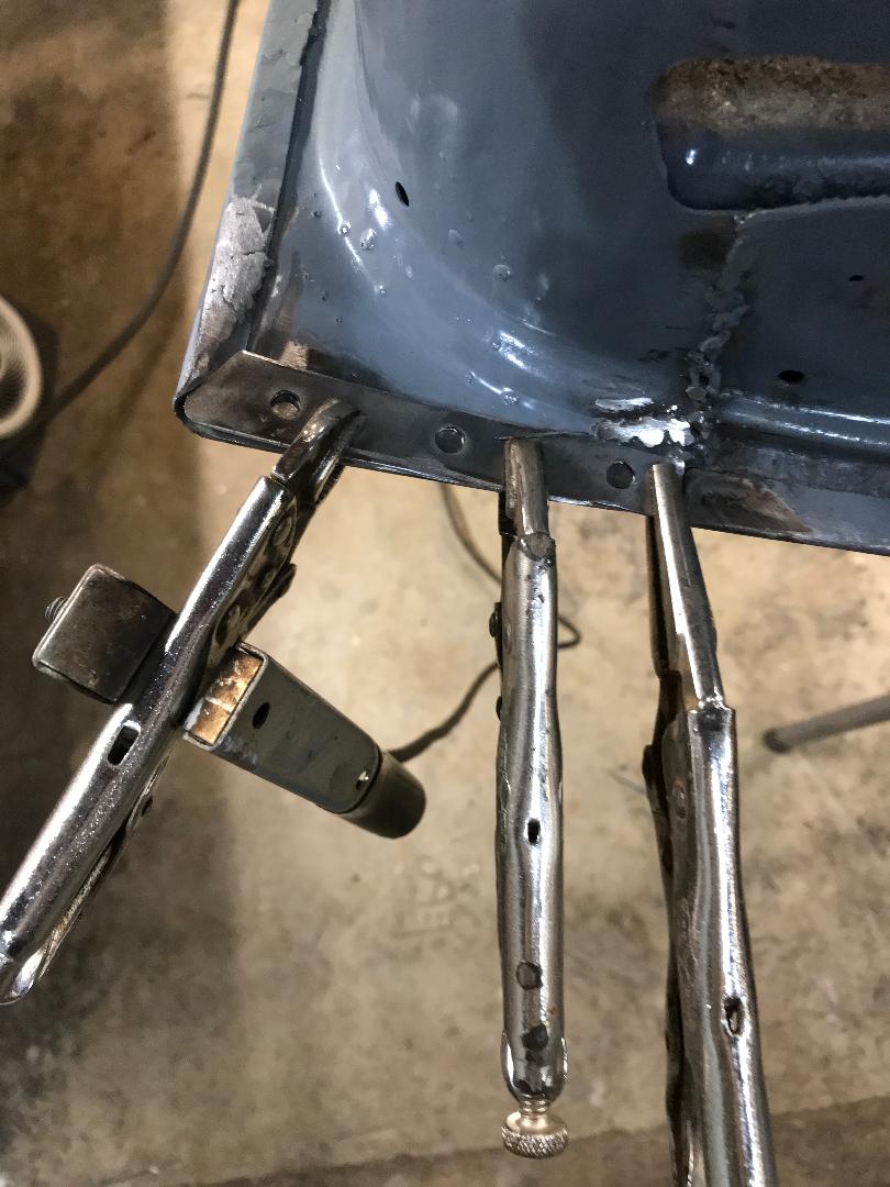

    Time to get the metal strip that holds the door panel back in place.
    Back in place, ugly welds and all...A little grinding, and they are still ugly, but now they are to closer to "closing time pretty."
    Not done with welding & grinding, but have to cover the fresh welds & bare metal now that winter is around the corner and there is a lot of moisture in air now.
    IMG_2861.JPG IMG_2862.JPG IMG_2863.JPG IMG_2864.JPG IMG_2865.JPG IMG_2866.JPG IMG_2867.JPG IMG_2868.JPG
