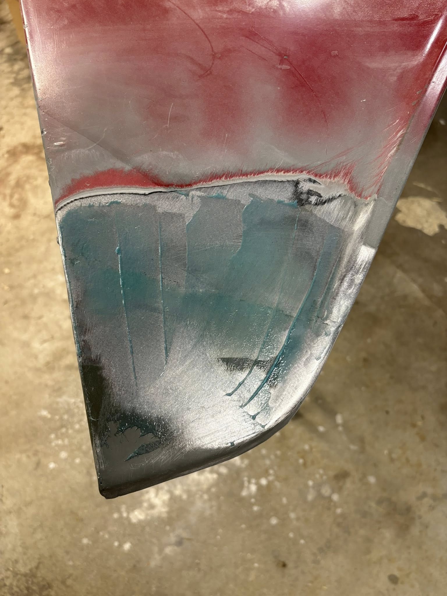

    First coat of Duraglass over the welded area:

    Added a second skim coat of Duracoat to smooth out the area. Will knock that down when it sets and on to the next issue.

    Finished up smoothing out the area on the quarter panel & primered.

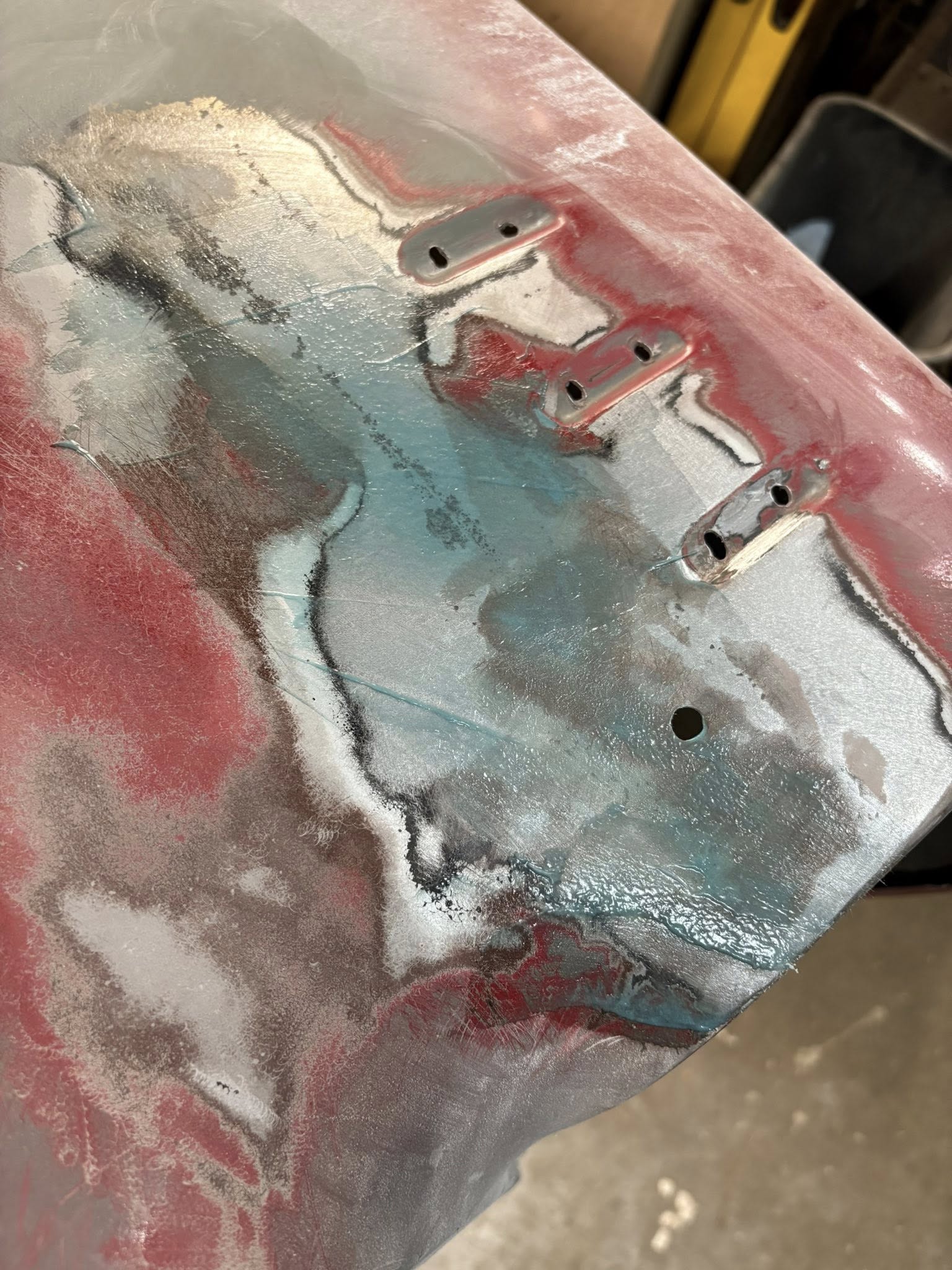

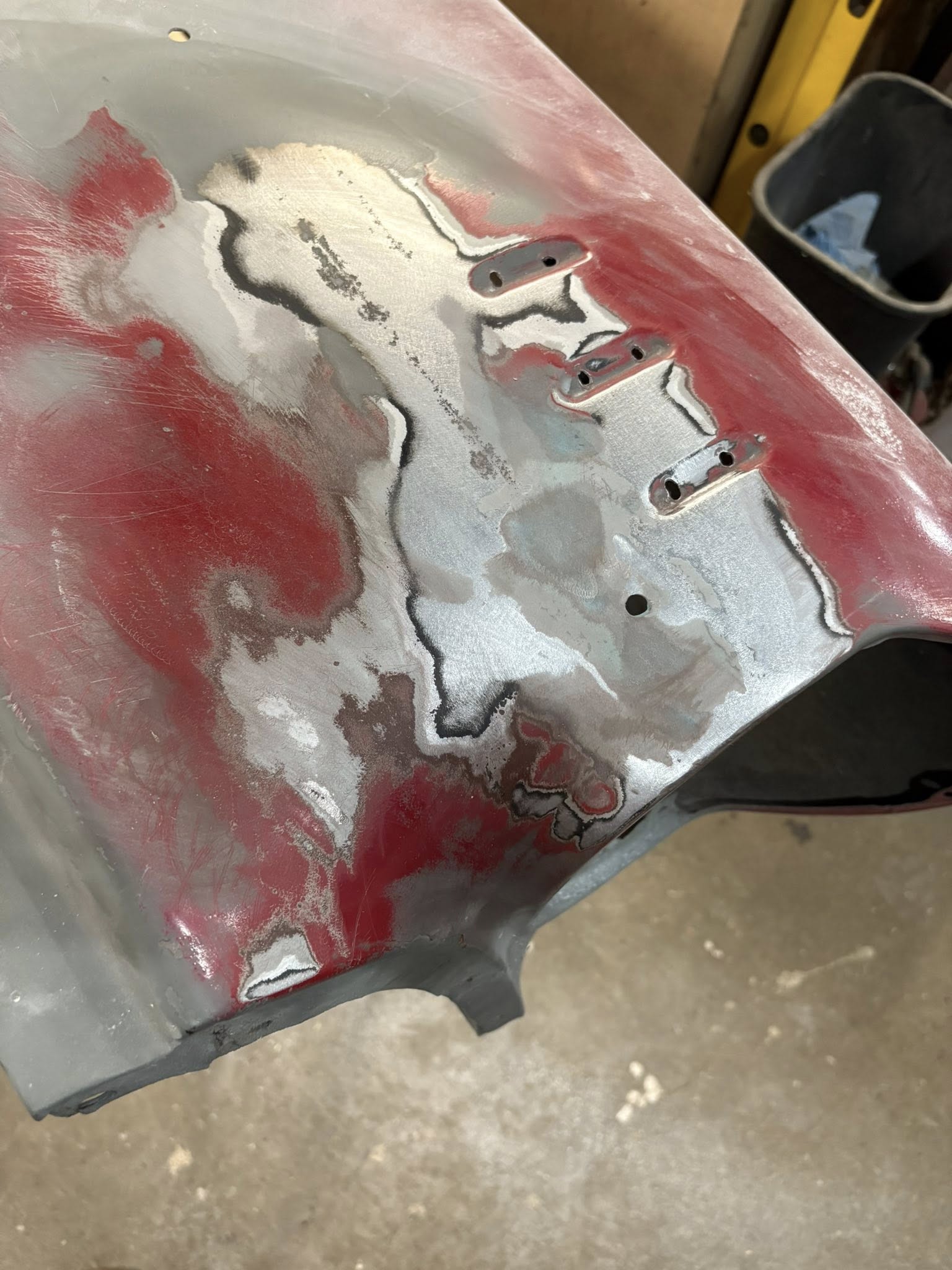

    Started some smoothing of the driver side fender over the welded/repaired areas.

  14. Squablow
    Joined: Apr 26, 2005
    Posts: 18,376
    Squablow
    Still looking nice, good to see more progress. I also like to see original panels getting repaired, even when they're available new. Too much new sheetmetal gets to be a Ship of Theseus situation.

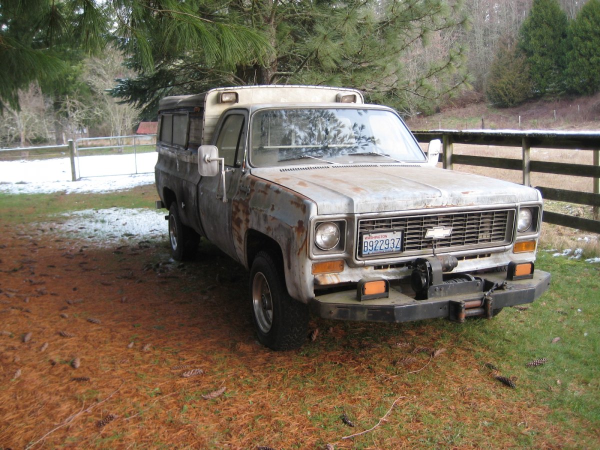

    Great to hear you're helping the family out, awesome score on the 57.
    The '73 truck - looks great to me. Scuff it down, acid etch, and shoot it with enamel ( tan,white, or grandpa green ) - good to go for another 10 years.

    Vintage Amercian Iron
    Both the "A" pillars were almost completely gone as was the bed floor, it was surprising they could hold the doors in place.

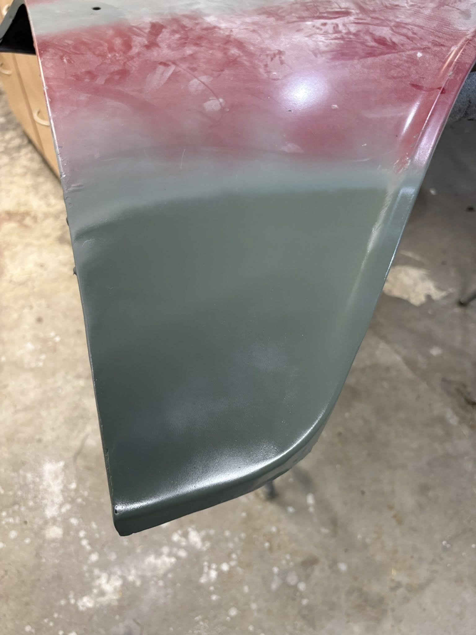

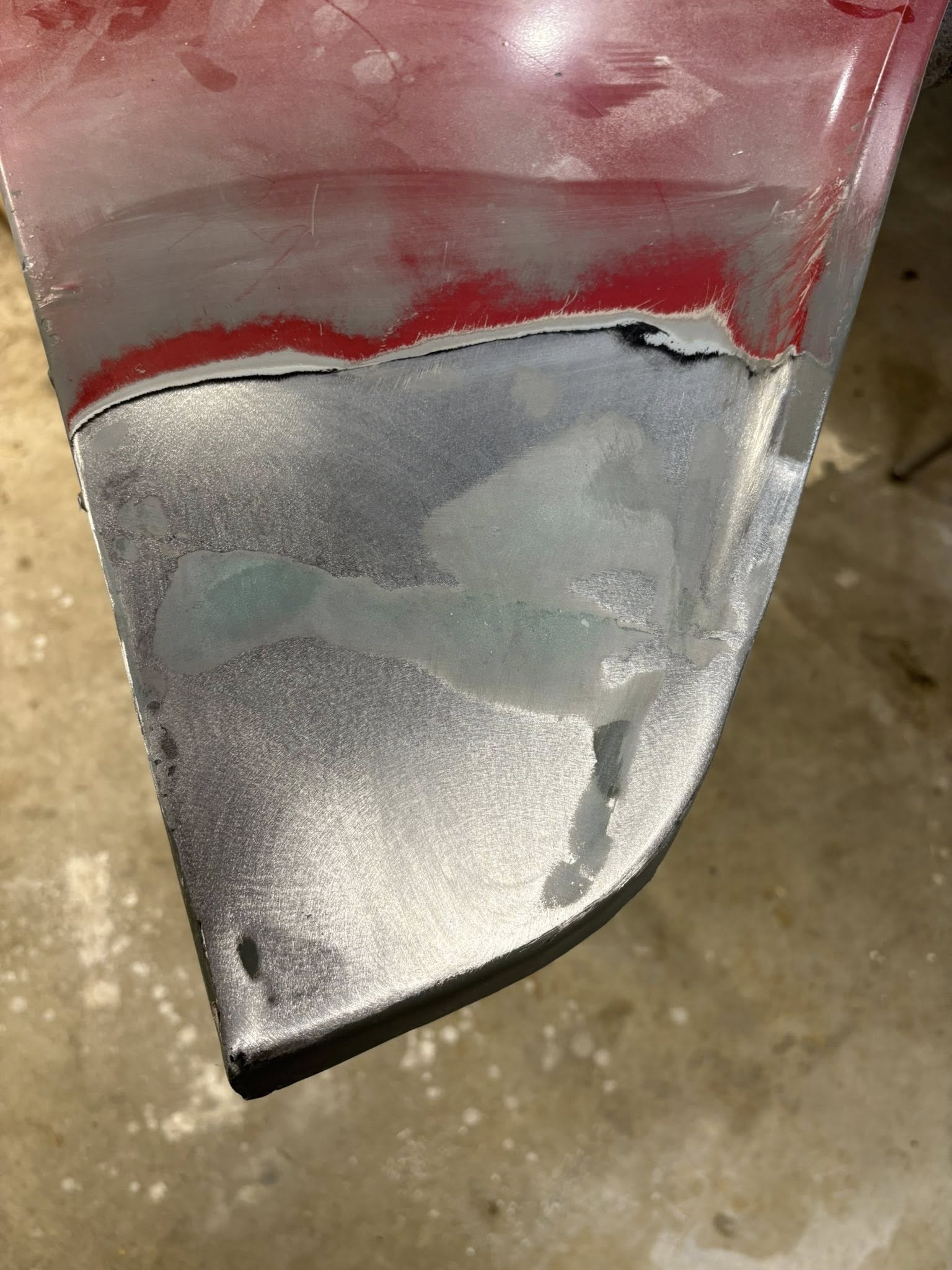

    Skimcoat to even out the area and a little attention to the lower fender repair area as well.

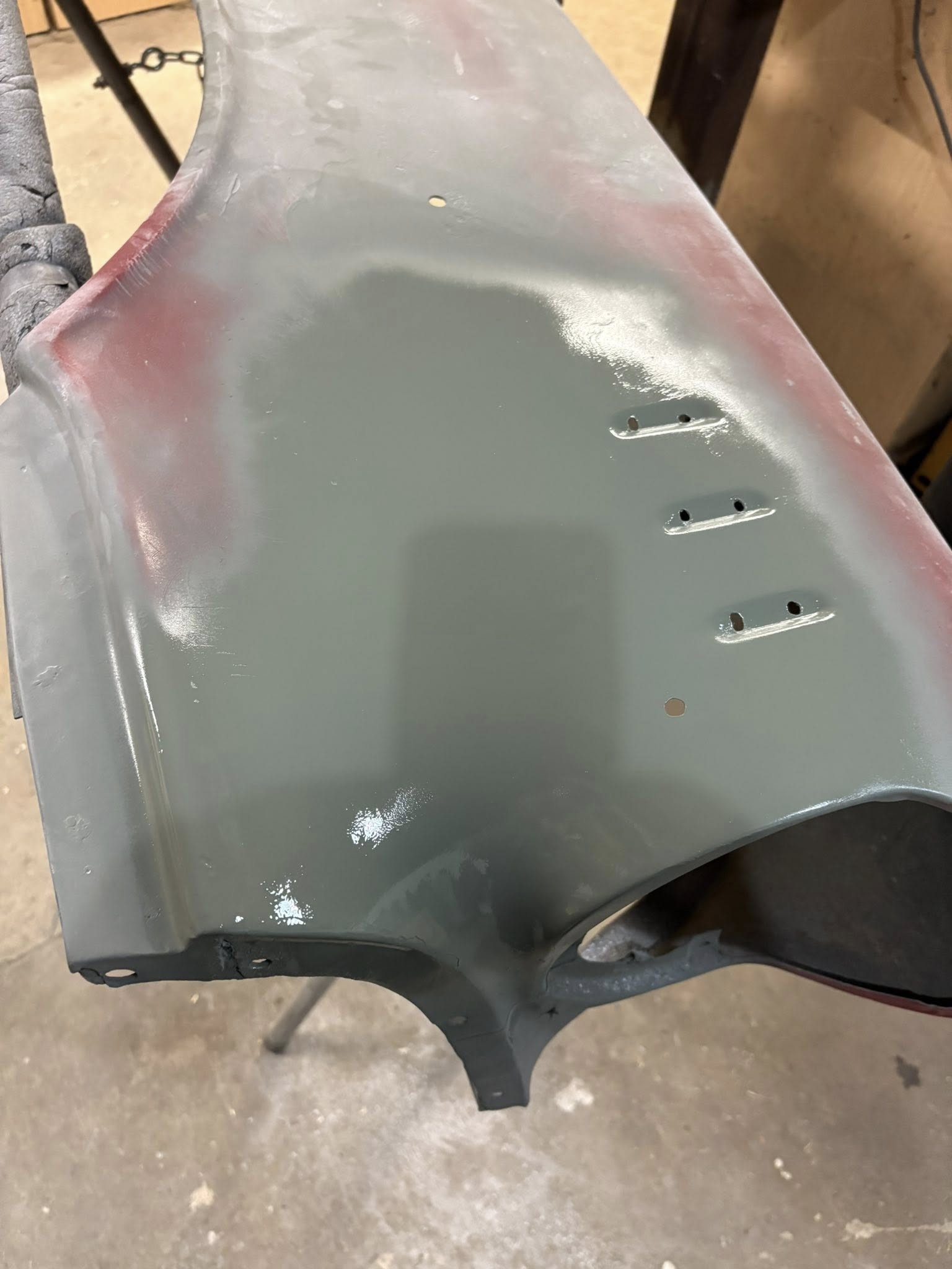

    Finished up smoothing the side of the fender. But still have a little work around the headlight opening before moving on to high build and blocking.

    Headlight area cleaned up and primed. Back to storage and time to start on the other fender.
