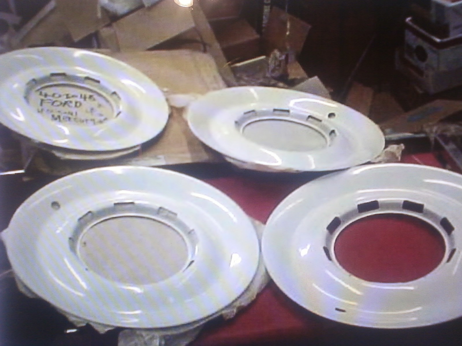

    how about these with a moon style cap over them. these just need to be chromed.
  7. Rikster
    Joined: Dec 10, 2004
    Posts: 5,795
    Rikster
    Those are Calnevar WhiteSides. They came in Chrome as well as you can see in the ad below. They are not the same as the parts used by Barris in the late 1940's but its an option that comes close.

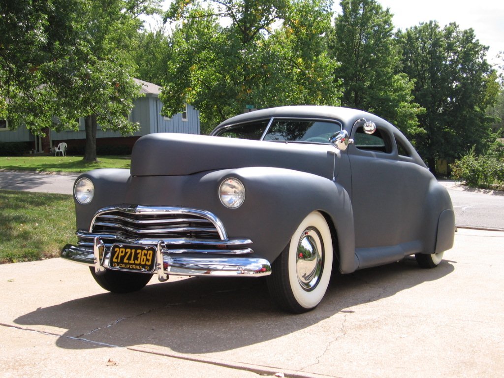

    When the partly restored car was shown at the GNRS Custom Then & Now event it sat to high, and the front tires almost look like they where flush with the outside of the fenders.
    There was no way the car could sit low enough without the tires rubbing the fenders
    WHen Steve and George where putting the car together to meet the deadline for this show they realized to late that the 1942-48 Ford front axle is wider than the 1941 Ford front axle. And they used a wider one, since the parts for it where in better shape. When they found out this axle was to wide for a lowered car it was to late. So the car was raised to be able to turn the wheels.
    Here are some photos to show the difference in these two axles.
    ...and after installing the correct front axle. So much better!
    The engine right now is a mostly stock flathead. But in time will be dressed up with some nice period speed parts.
