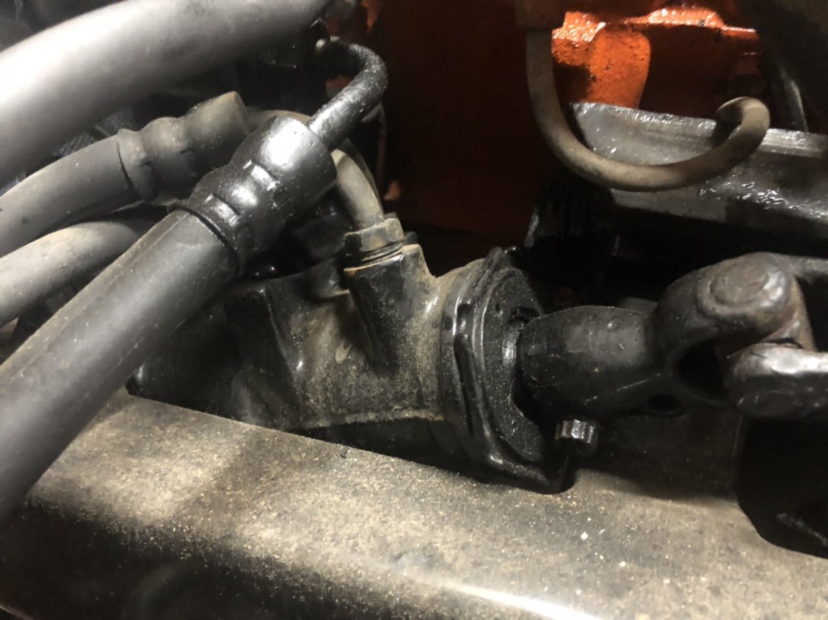

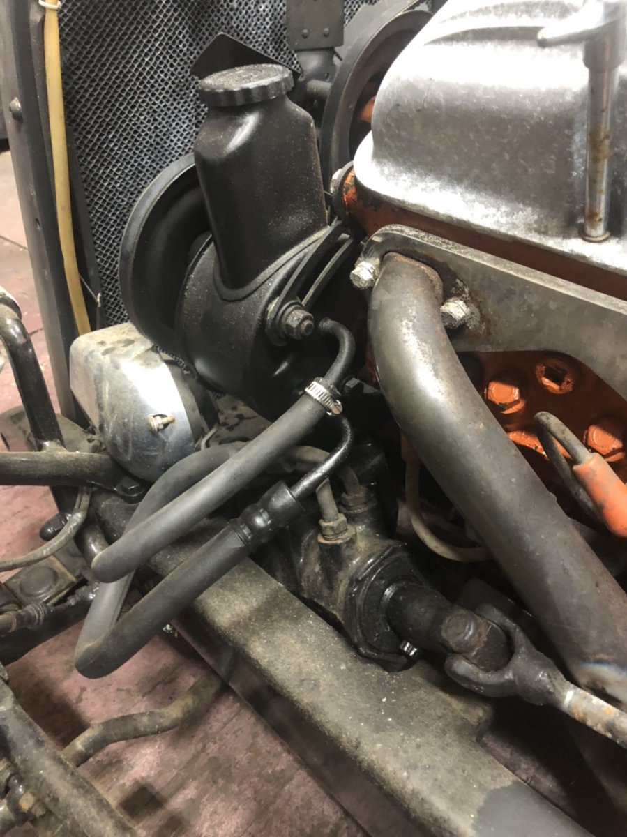

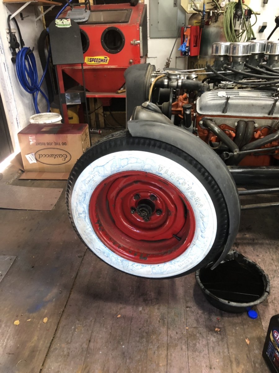

    Over the past 6 weeks I had been picking away at fuel, cooling, brakes, tires and suspension. Making sure I had all the vitals in good order to get the coupe back on the road.
    As you would imagine, being built late 70’s driven like this car was and the the 20 years of sitting time had taken its toll on things.
    I went back into hustle mode to work up the cash to get it back to shape.

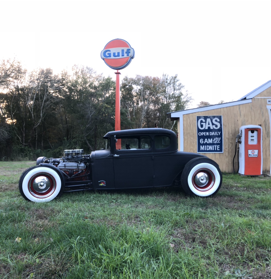

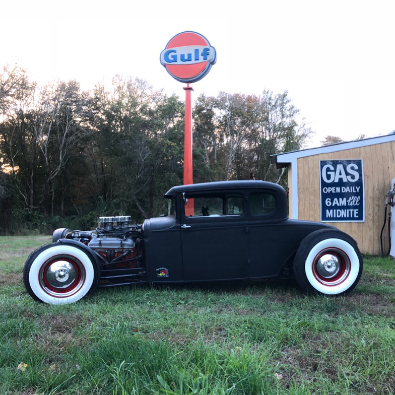

    A week ago today I took the car for its 1st drive. Had some things to sort out w the carburetors settings but I made it home
    This past Friday I went for a good cruise to give it a good test ... all systems go !!

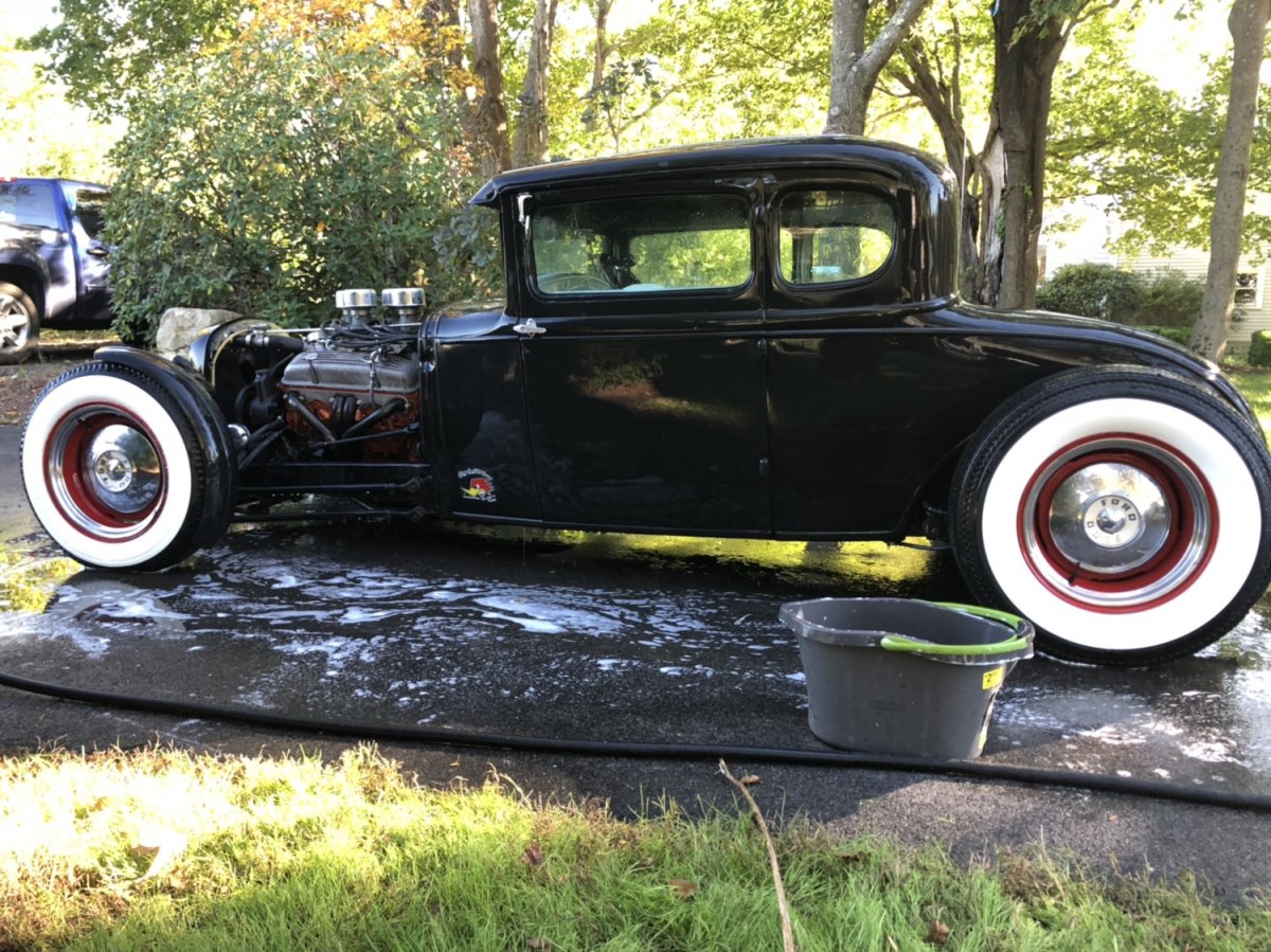

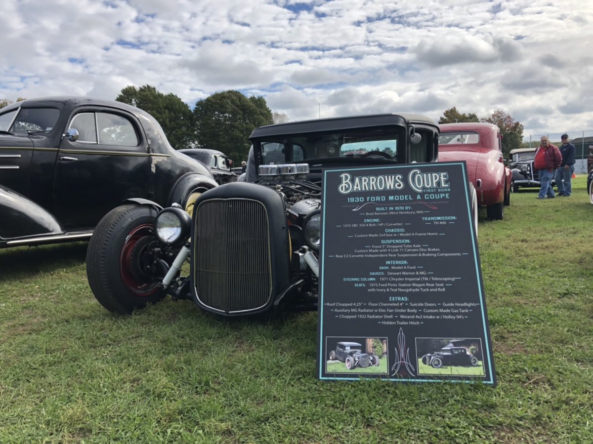

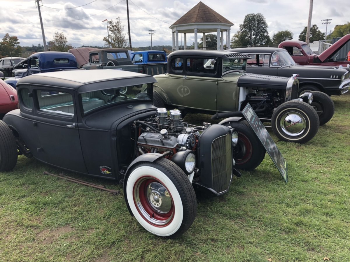

    Saturday am @mikebowling and @wheeldog57 got to the house early and we rolled to The Gathering of The Faithful 2018
    I had a sign made for the to pay tribute to Brad Barrows for his hard work creativity and his love of 50’s style hotrods.
    I couldn’t have asked for a better guy to buy his very first car he ever built.

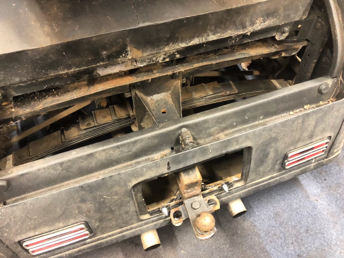

    The tail lights were a mystery to me for quite some time.
    Watching American pickers I saw a 68-72 Chevy truck and there they were.
    Bed side marker lights.
    Brad converted them and used dual filament bulbs to convert them into brake and turn signals.
    Quite ingenious if you ask me

    Knew those lights looked familiar! Clever

    Unique tail lights, and frenched in to boot! You can find little things on this car all over that are pretty amazing. Good Save, Podna!
