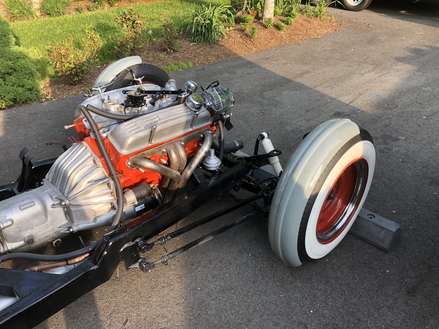

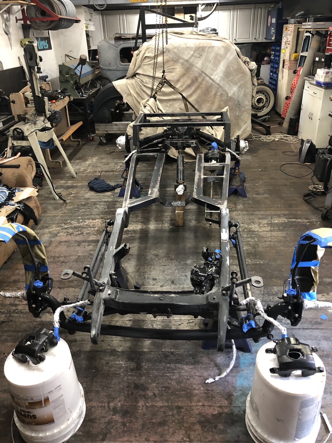

    Next was to remove the drivetrain.
    It came out with no issues, it was good to get the frame stripped down.
    I had previously rebuilt the suspension components and the brakes.
    So it was nice to not have to tear the whole undercarriage of the car back apart.
    After several days of scraping cleaning and rolling the chassis outside to power wash off the 40 years of dirt and grime
    Got things completely cleaned sanded and ready for sealer
    [​IMG][​IMG]
    Sealed and painted single stage acrylic enamel black [​IMG]

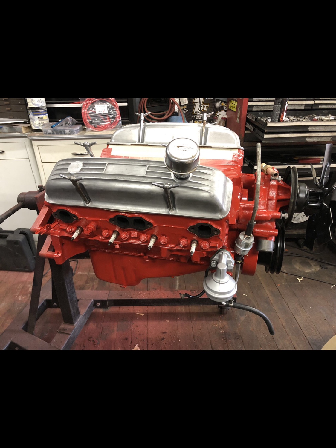

    After the chassis was disassembled cleaned and painted, it was time to tear into the motor.
    Mechanically there was nothing wrong with it.
    To recap, it’s a 1976 Chevy 350 from the donor corvette that the full drivetrain was removed from.
    I order to get it on the motor stand the trans had to come off.
    The old TH400 served the coupe well ... but I’m a younger guy and I’m a firm believer that a hotrod should have 3 pedals ... The only question would be, how the hell am I going to fit 3 pedals in the car. It would prove to be an engineering feat.
    I did not need to do a full rebuild, I did however want to go over it and freshen everything up.
    Decided to go with a full Comp Cams kit with a nice lumpy cam, lifters, hardened pushrods, heavy valve springs, 1.6 roller rockers and all the gaskets and seals in the motor. Including a high volume oil pump and double roller timing chain
    After everything was freshened up and ready to go I got the motor masked off and painted. [​IMG]
    After that was all set I got things situated for the trans.
    I ordered a new billet flywheel and a centerforce clutch.
    Due to limited space I opted to use a hydraulic throwout bearing.
    It’s got both a feed and bleed line as you can see in the pic.
    The trans I opted for and was extremely fortunate to find is a 1970 aluminum super T-10 4 speed trans out of a big block chevelle.
    It had been completely gone though and ready to go. So a quick trip to CT for that and I was good to go.
    I had to modify the chassis by cutting the trans crossmember and moving it forwards 4” for the new 4 spd mount.
    That in turn caused some additional work with the aux cooling lines. More on the later.
    You can see in this pic the driveshaft is reinstalled. It amazed me that the driveshaft fit perfectly with the new transmission.
    *** for those who do this swap in the future***
    The yoke from the TH 400 trans mission is 32 spline, it is the exact yoke the Super T-10 trans used in the 70’s. It is a direct fit.
    So if you’re in possession of a TH400. Keep the yoke or if you ever come across one. Snag it. They’re good for $60-$75 for resale as (Super T-10 yoke)on eBay in good condition. [​IMG]
    I replaced the old water pump with a new pump. It was difficult finding the same pump, but after a lot of searching I was able to source one.
    Started adding accessories on the motor.
    Every single part has been cleaned, sanded and painted with single stage.
    Every bit of aluminum had been cleaned, sanded and steel wooled for some shine.

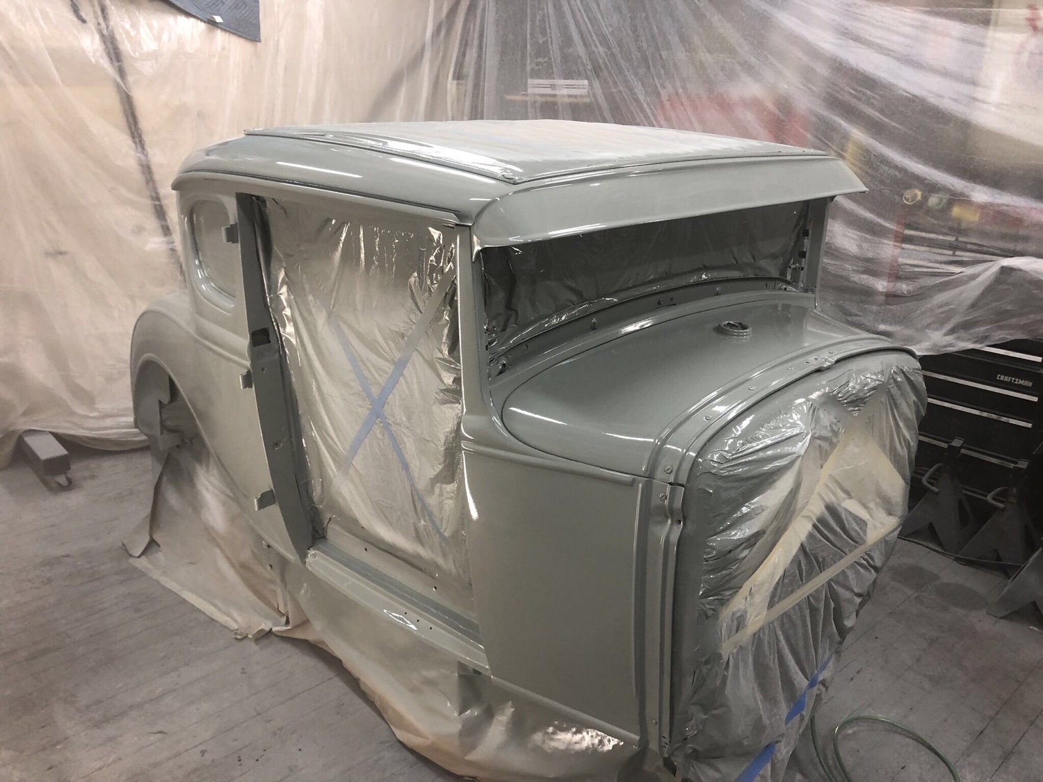

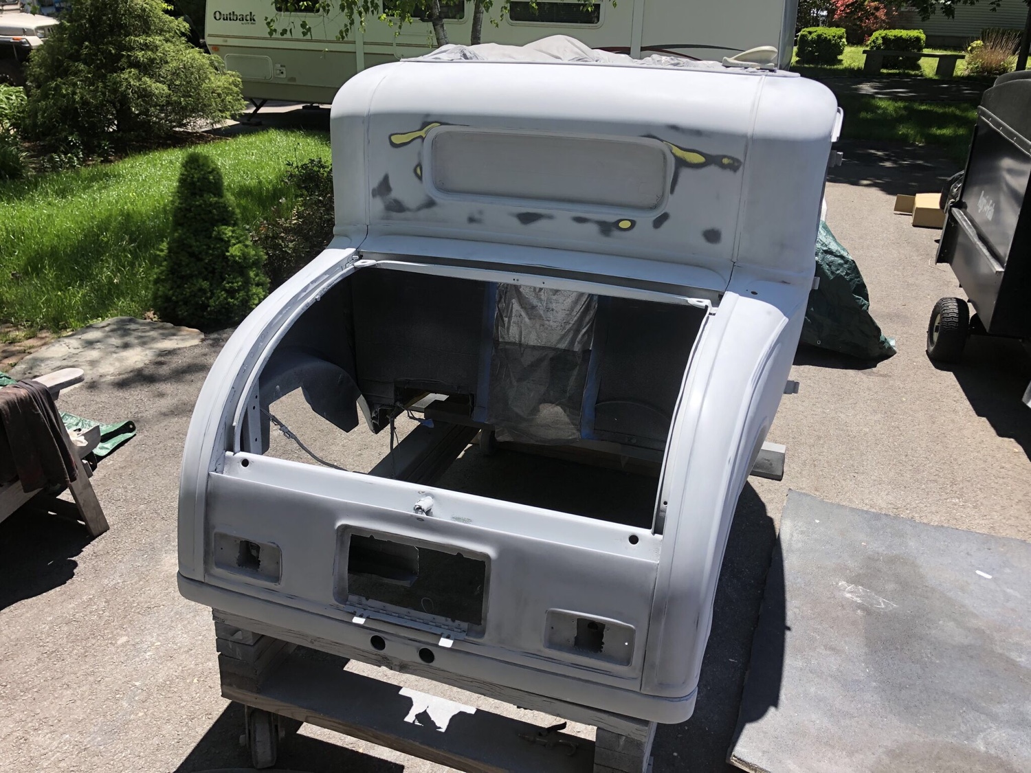

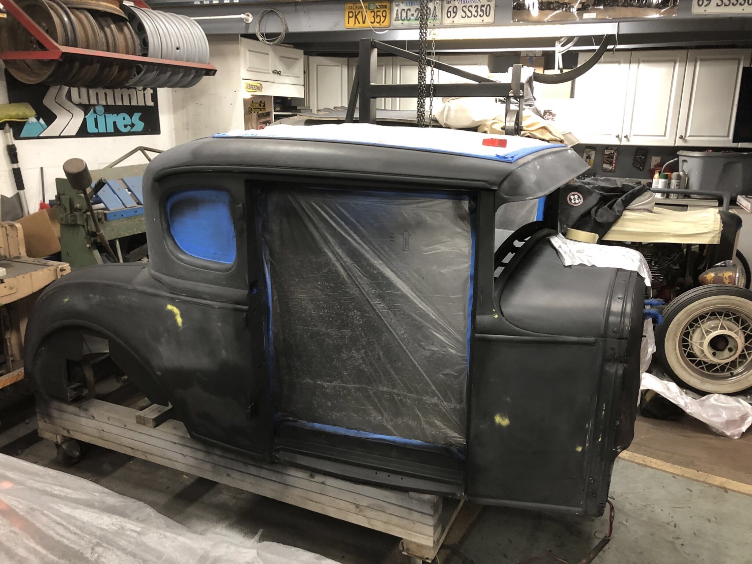

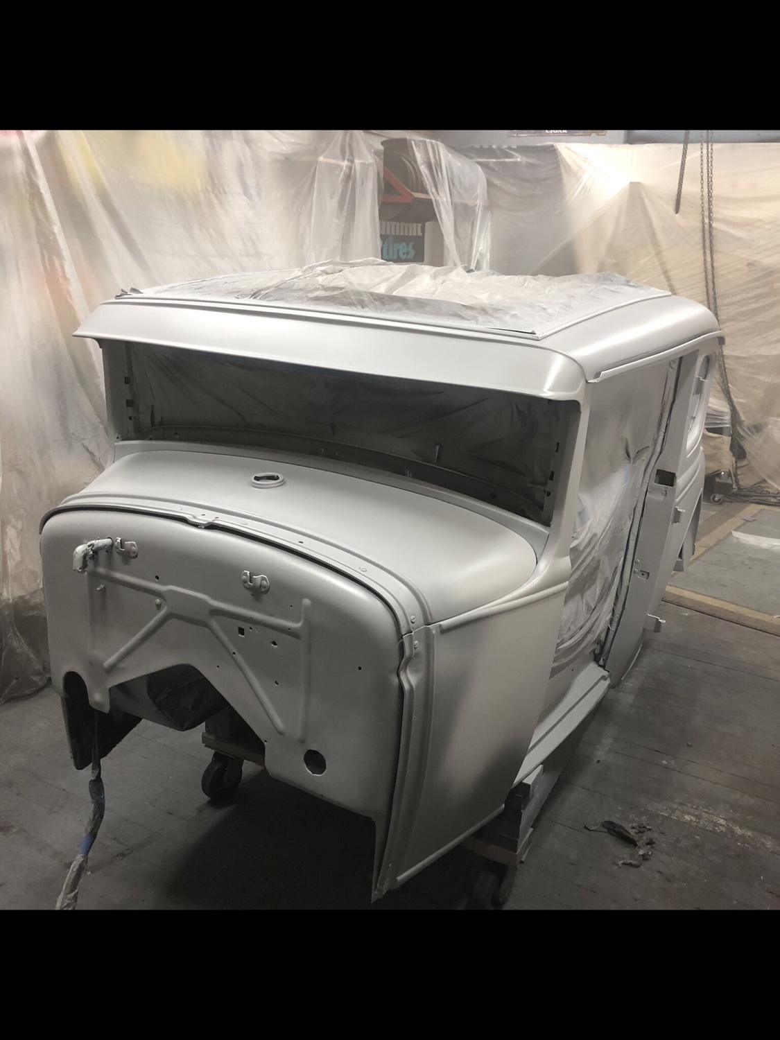

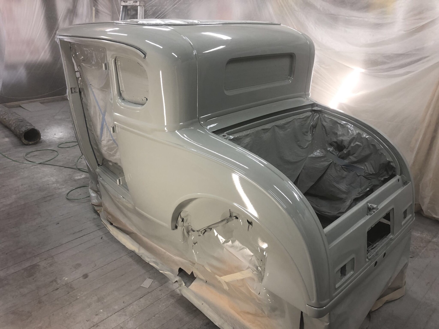

    Once I had the chassis and drivetrain situated I got to work on the body.
    A big part of me wanted to keep the body color the same. Flat black, just for the sake of keeping the car as it were when I bought it.
    The “paint” on the car wasn’t paint. It was 30 year old primer. It had really seen better day’s, it had become very cloudy and chalky over time. I could have just masked things off and resprayed it flat black.
    But I’m not a flat black kinda guy ...

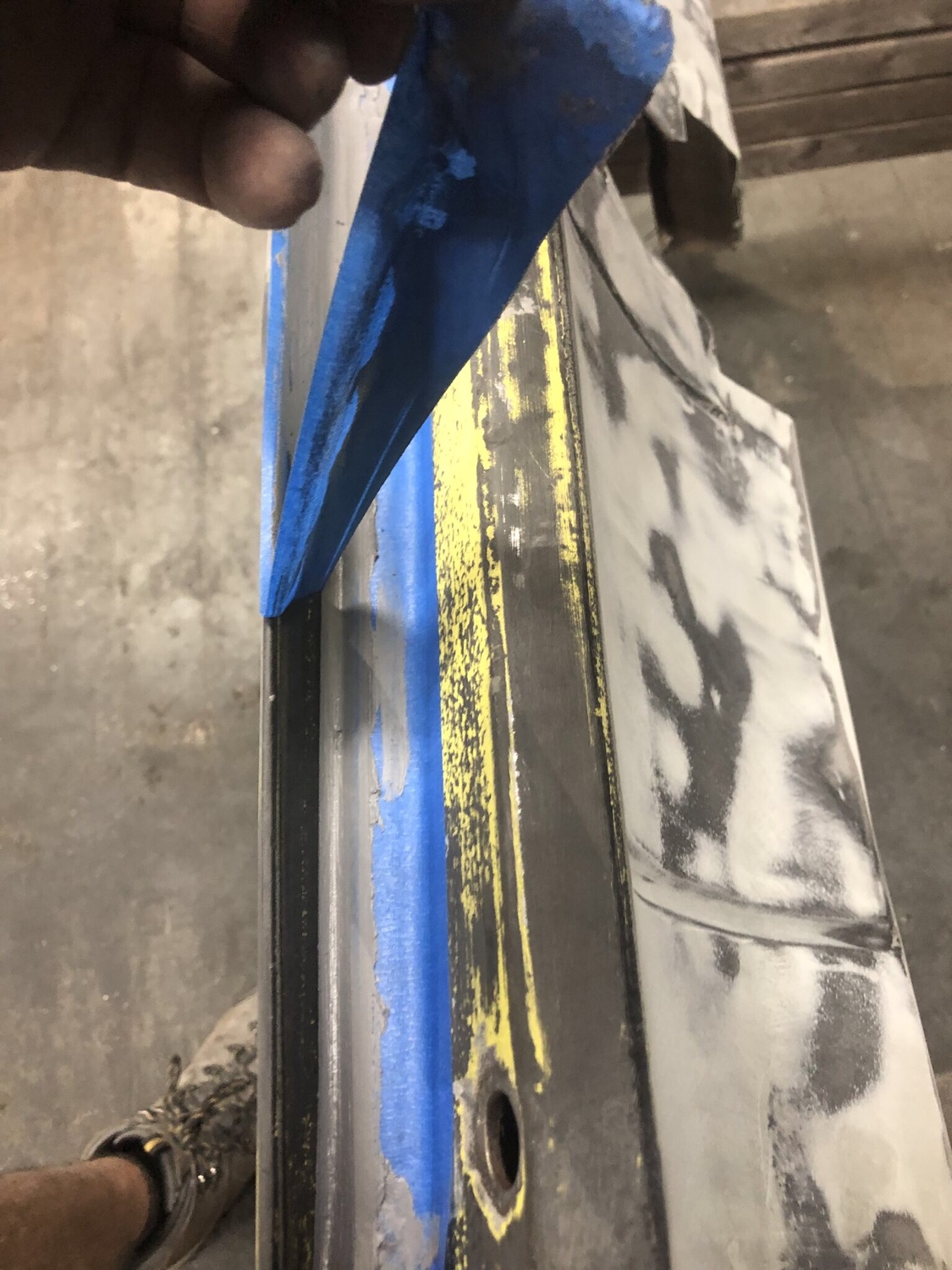

    so the sanding blocks came out and I started the process.

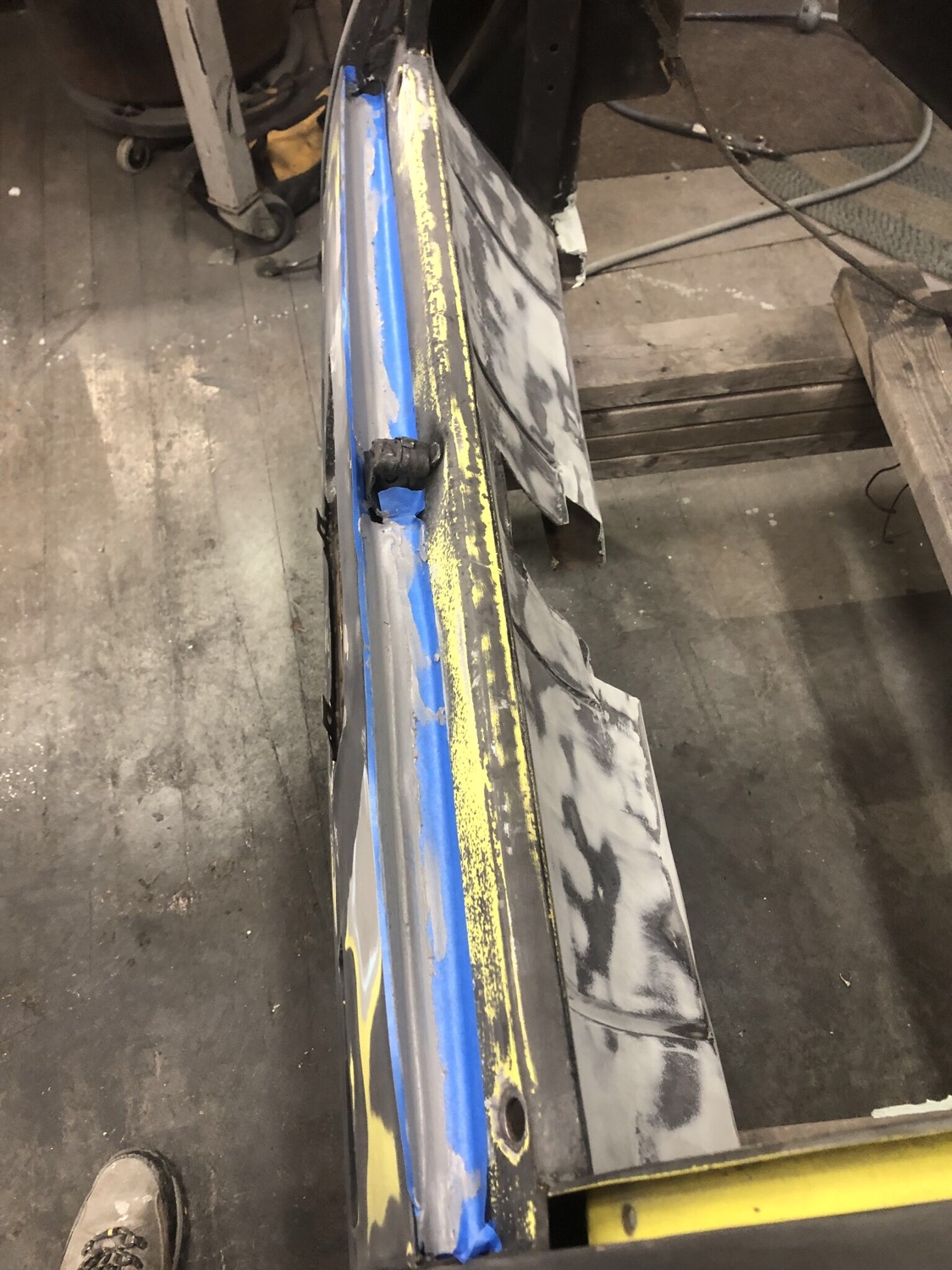

    This is the fuel tank. It was welded together by using several pieces and I wanted to finish it off by body working it. It’s what you see when the decklid is open and I wanted it to look nice

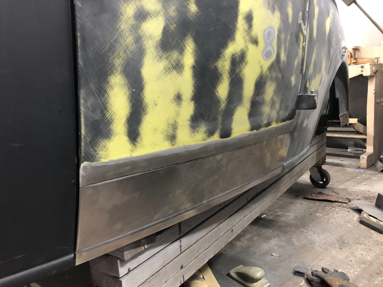

    Building up the filler

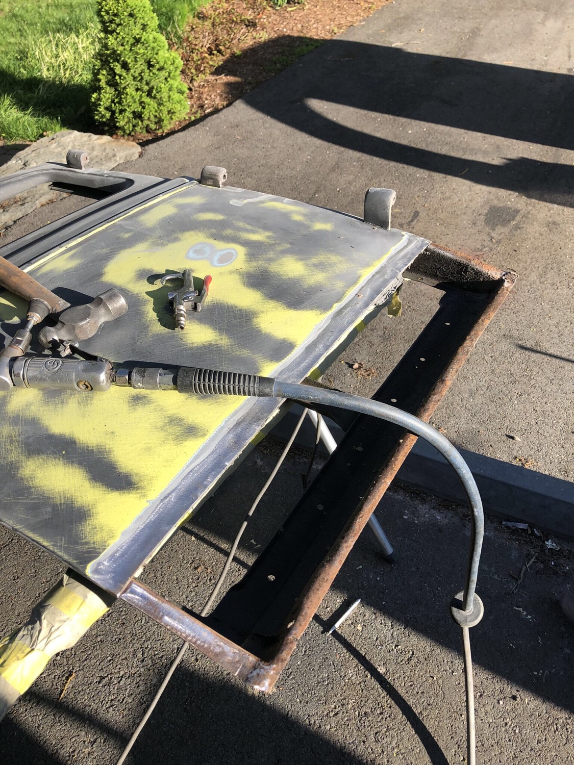

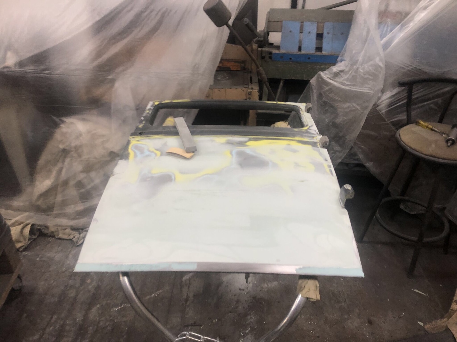

    Filler primer

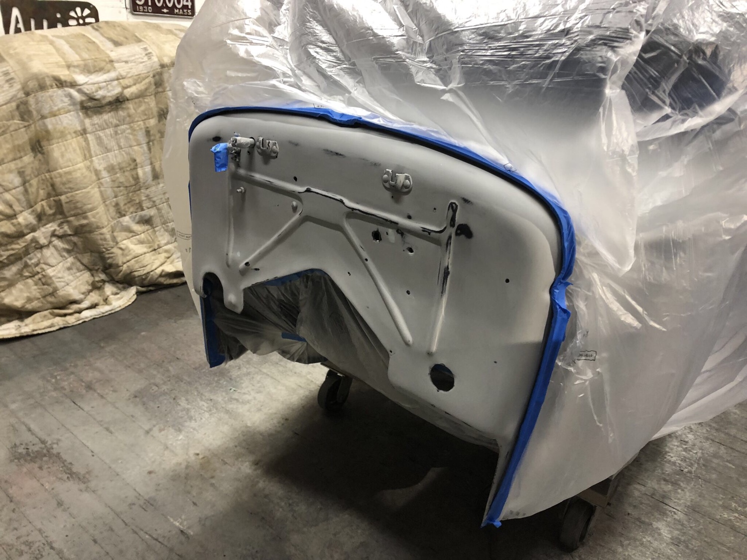

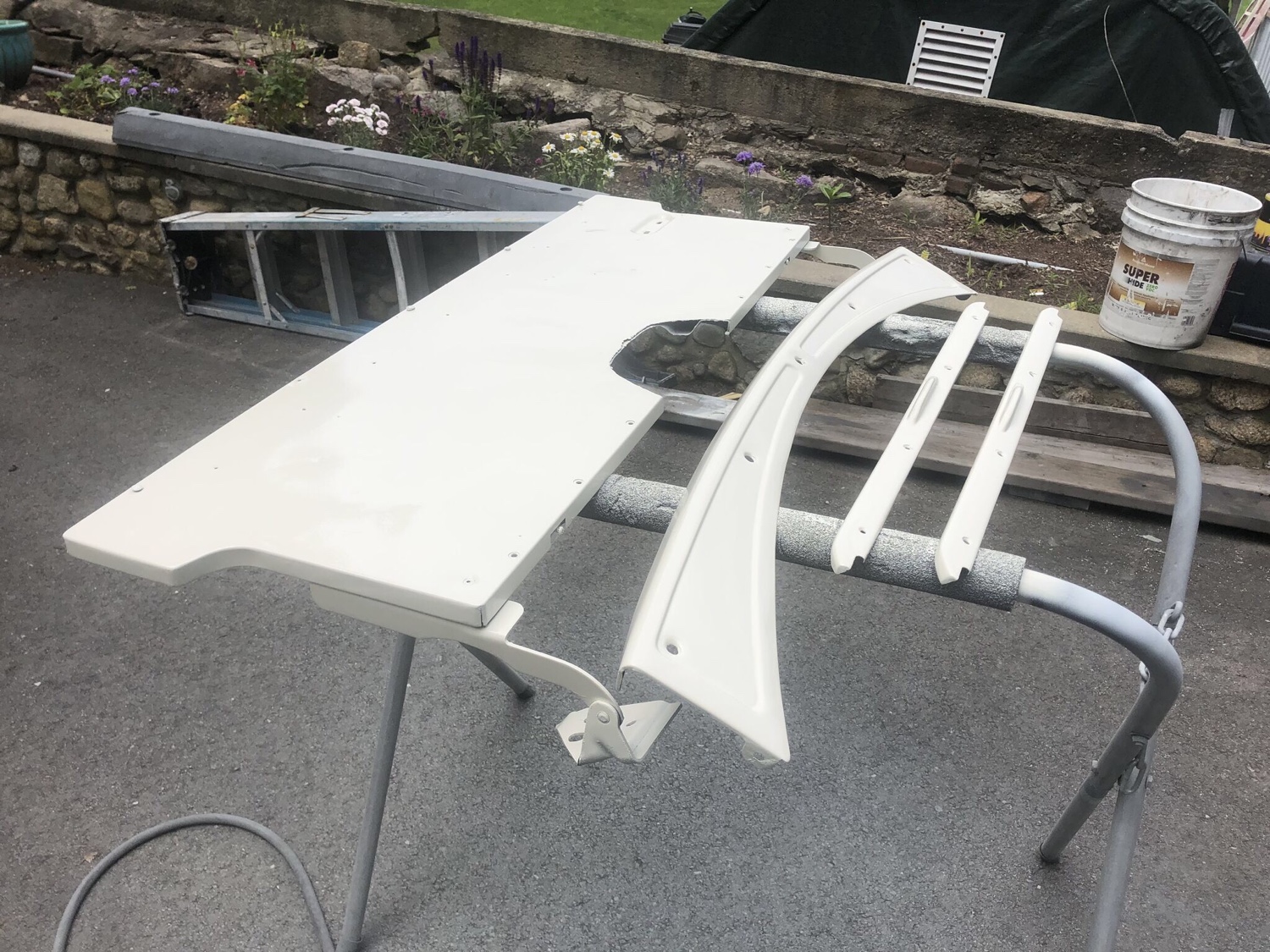

    Getting to work on the front fenders and the decklid at the same time

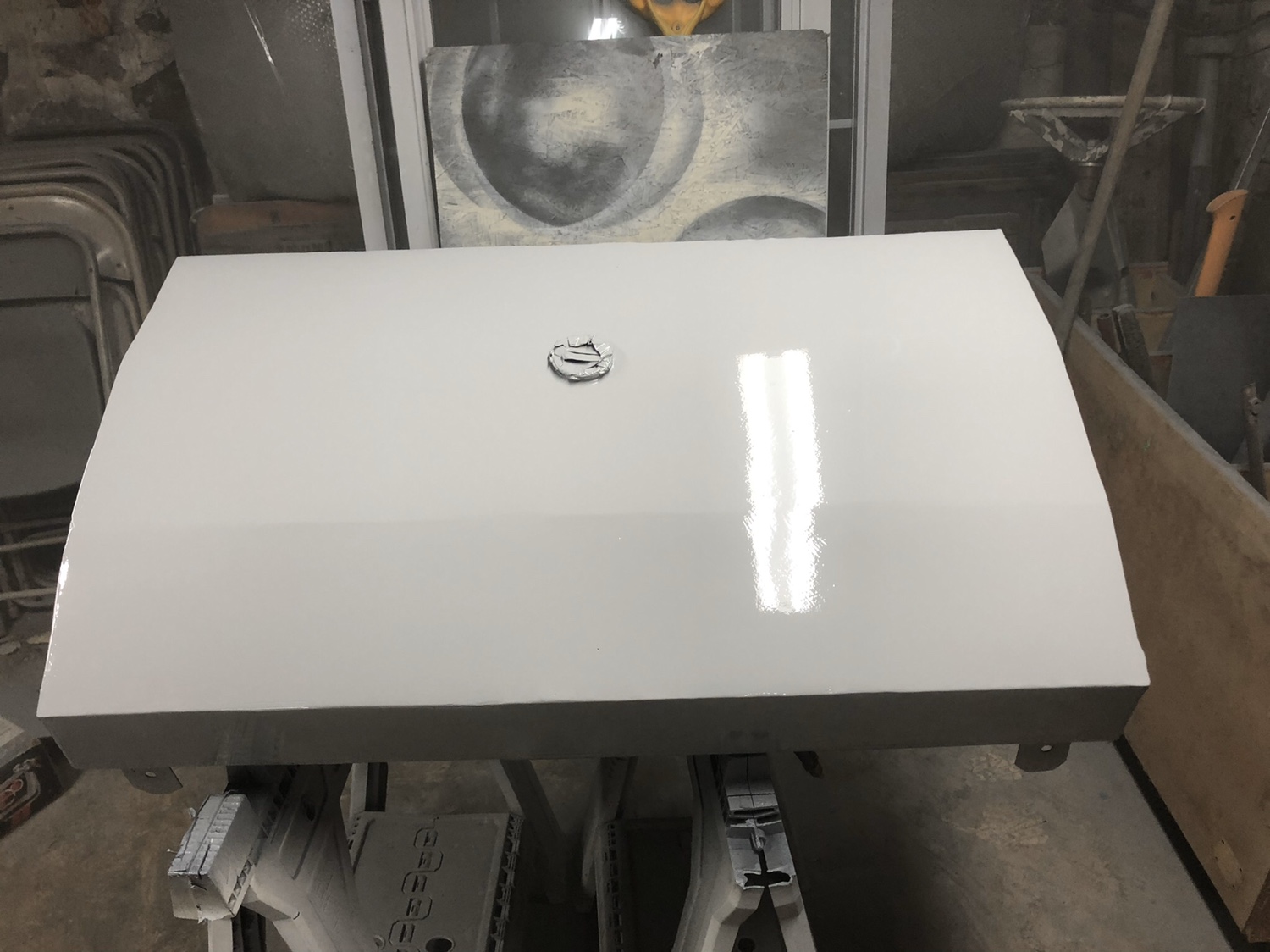

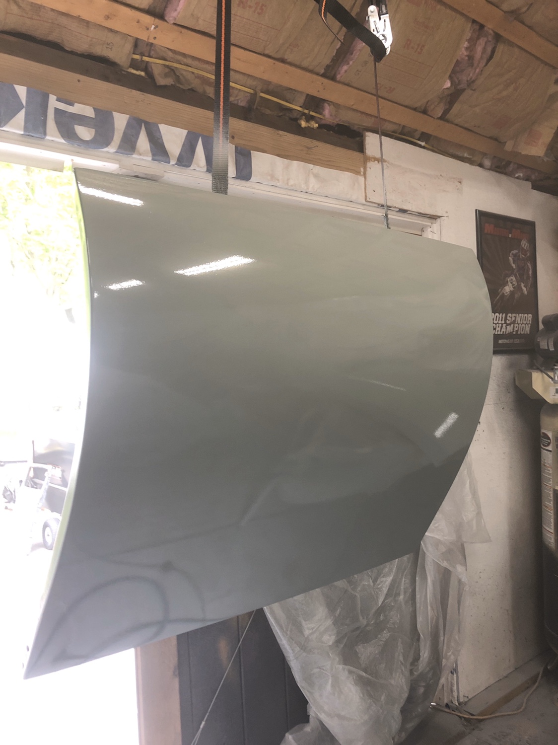

    Decklid in filler primer after epoxy and body work,

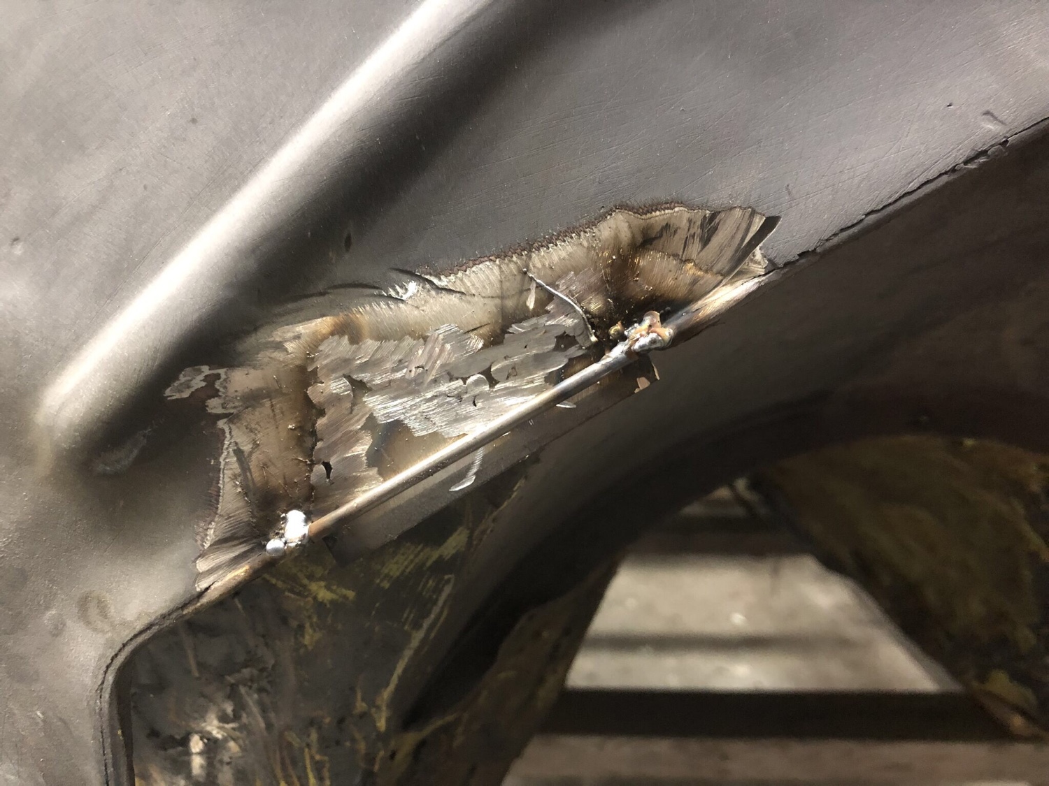

    Started sanding do the 30 year old primer and exposing what lies beneath ... things are never what they appear.
    Seam sealed everything I could inside the body and in the decklid channels
    Blue tape to keep things clean
    Brad has notched the firewall to accommodate the TH 400 filler/ dipstick tube.
    I recreated the filler the same way brad had fabricated it back in the day
    Hammer and dollied the new metal to the wire edge. Finish welded it and filled it when the time came
    Drivers rear quarter behind the wheel ...
    What’s left of the rear subrail
    Templating
  21. Mikel50
    Joined: Mar 30, 2015
    Posts: 1,113
    Mikel50
    Pics certainly do not show the amount of work needed to get the body straight.
    I spent 5 weeks repairing, sanding and working the body to get it as straight as I could.
    I’ve never done anything like this, it was a massive learning curve.
    Every time I thought I had the body good... I found more issues
    Finally after all the time spent I got the body work sealed in epoxy.
    As soon as it was sealed and flashed I was able to get the body in Poly filler primer.
    I loaded it on !
    It was nice to be able to roll the body out on the dolly.
    Let the block sanding begin ...
    After the body was moving forward I was able to get the firewall ready for sealer and finish paint.
    I used a ford color called Alaska White.
    It is almost spot on to Wimbledon White.
    (I just happened to have it already) I’ve used it on wheels and other things in the past.
    Next it was time to get the body finalized and in epoxy and final paint.

  24. Mikel50
    Posts: 1,113
    Mikel50

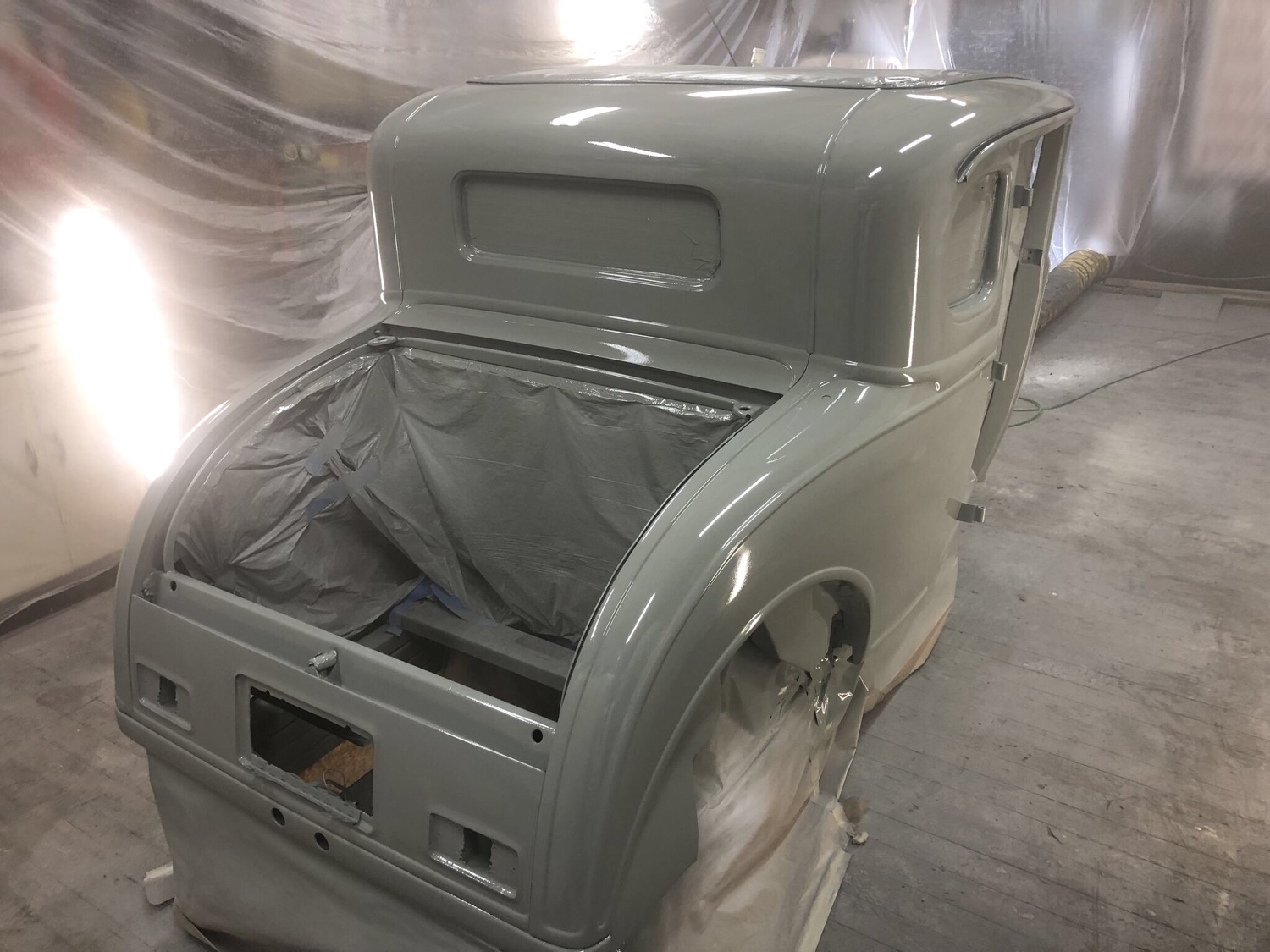

    I ended up with 2 gallons of color once everything was mixed up [​IMG]
    Everything got 5 coats of single stage acrylic enamel.
    Unmasked the chassis and got to see the final look the day after.
    Once the fenders we’re sprayed, I was able to roll the chassis outside.
    Loved seeing the color outside in the natural light for the first time.
    I covered the chassis with plastic so I had some extra room to be able to finish the body and get the final epoxy coat and finish sprayed
    [​IMG][​IMG]
    Finish paint
    The following day I peeled the masking to see how I did on my first paint job.
    I was very happy with the results.
    Also, as always a huge thank you to Joe 51Box for all the help. Joe was a wealth of knowledge when it came to everything regarding the paint.
    For the next week I was able to roll the body outside in the 80 plus degree weather to bake the paint in.
    Threw the seat in the body so I could see how it looked.

    There was still so mush to do but I felt like a huge hurdle had been accomplished.
    I still had to paint the headlights grill shell and doors.
    Plus a slew of other pieces including the windshield frame and interior pieces
    Headlights and other pieces
    Door tops
    Seat back, door pulls and dash rail.
    Painted to match the new ivory Naugahyde.
    Column to match the interior also
    Interior side of the windshield to match the Naugahyde and the grill shell insert to match the firewall

    After the hot sticky weather passed I got back onto the doors.
    While the coupe was on hold for the summer, I had the great idea of putting up a new shop in the back yard.
    It wasn’t planned, just like the overhaul of the coupe. However it needed to happen.
    Working on the coupe with limited space in my small shop, I was frustrated and needed additional storage and a place to keep the overflow and ever expanding fleet of hotrods.
    Once the building was done and the summer heat started dying down I got back in the garage.
    Earlier in the spring joe and I had started digging into the the doors.
    We found several areas that needed some attention. There were areas of rot on the door bottoms and needed to be cut out and patch Panels welded in.
    After that I started body working the doors
    Doors finally in filler primer
  29. Mikel50
    Posts: 1,113
    Mikel50
    Next was to paint the doors and get them mounted on the body
    [​IMG][​IMG]
