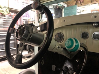

    After the trans tunnel was ****oned up I was able to heat and bend the pedals, install the steering column and wheel and start installing the interior.
    I dyed the old teal pleated dash to match the new ivory interior color.
    I had purchased a lot of vintage gl*** shifter knobs over the summer.
    This one matched the interior perfectly.
    Installed some vintage SW Gauges I pulled from an old freightliner out of a junkyard

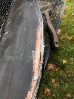

    Carbs were all put back on, wiring was “done” the car fired right up and ran with no issues. According to the gauges everything was as it should be ... then the old radiator let go.
    Quickly I realized what had happened. I had replaced the old cap with a new cap.
    I had used a 13psi cap instead of the 7psi cap that had been previously on the car.
    It ended up splitting the top of the radiator tank where brad had modified it.
    After some trial and error (emphasis on error) I was able to sweat out all the old solder, clean the old copper tank and resolver everything back. It took quite a few tries and it tested my patience and skills. But I got it done
    I used soapy water and I purchased a rubber drain plug and put it in the lower hose tube on the radiator. Used my compressor, filled the radiator with soapy water and lightly pressurized the radiator to locate the leaks.
    It worked like a charm
    It’s not pretty , but neither was it before and you don’t see any of it when the grill shell is on

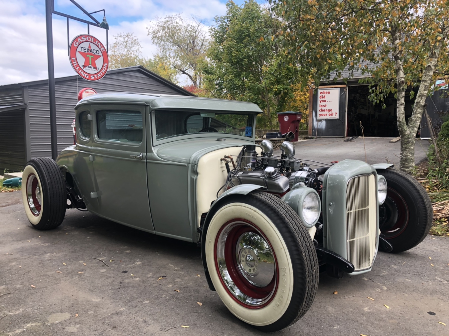

    Here’s the first walk around outside

    Any more shots of how that lower radiator outlet was raised?
  23. Mikel50
    Joined: Mar 30, 2015
    Posts: 1,113
    Mikel50
    Yes. It's 1/2" copper plumbing pipe and 90° elbows and a whole lot of solder
    I'll post pics from my phone in a bit
