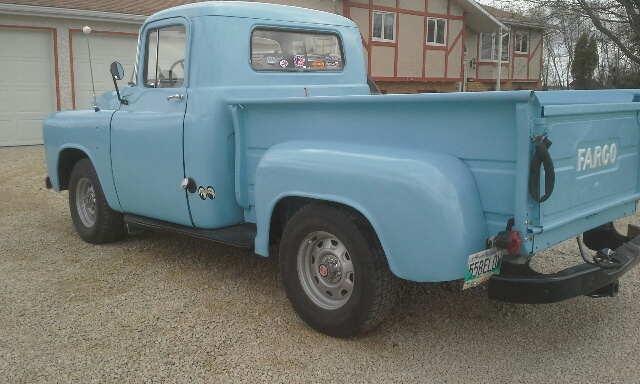

    Go back several posts and guess at mine.

    i was trying to tell but can't. they all look perfect. if i was forced to label the paints from those photos i would guess single stage on the first three and bc/cc on the horseless carriage.
