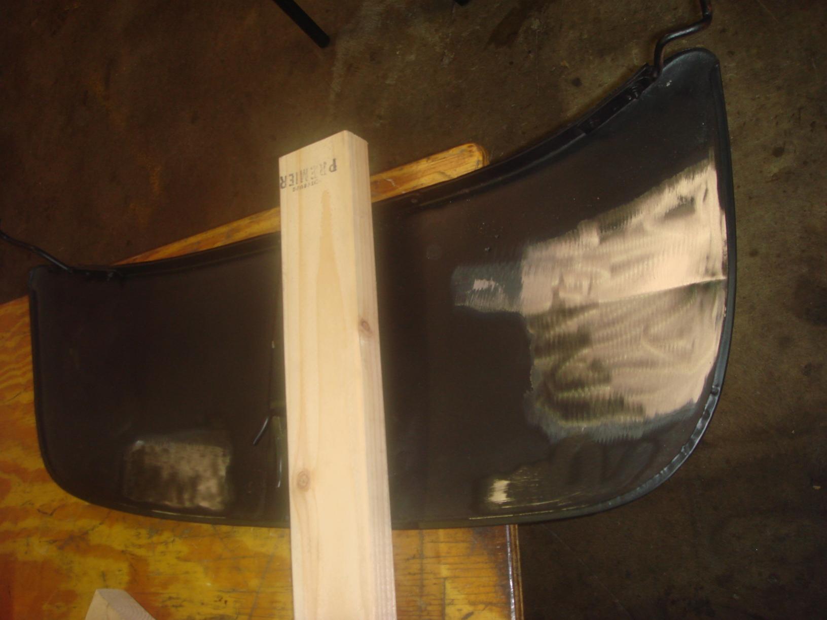

    Has anyone ever tried using a kevlar disc for friction? I'd thought about an old clutch disc, but the asbestos content would be kinda a buzzkiller!
    I've always jus' used dead 60 grit production discs on my 9'' grinder for much the same result as a "magical & new and improved" shrinking disc.

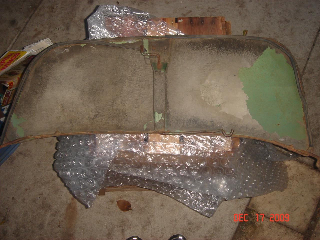

    The Vespa in the back ground is my new toy, and turns out it's covered in Bondo, and the engine was seized up, so the engine is torn down and being rebuilt and the same goes with the body.

    Shrinking disks are great tool but it is a finishing tool. 90per is hammer dolly work, then when you get it close you finish it with a shrinking disk.
    That's how I use them anyways. Getting it close with a hammer and dolly is not that hard if you have a understanding on how the metal will react when you are hammering on it.
    That last 10per is the hard part and that is where the shrinking disk comes in handy.
    When you are using one you want to hold it as flat as posiable, When running over the panel it will only be making contact with the high spots. Work in small areas, then spray it with soapy water. You only need to work an area long enough to cause a little steam when sprayed. You do not want to over do it. Then you just watch it blend together.
    You also might have to do some bumping during this to bump up any lows. I try to do that in the beginning but I always find more during the process.
    I don't know about the friction disk, I have never used one.
    On my shrinking disk, I will clean it periodically with some 80G sand paper. I also run a bar of soap on it while using it. It will help it from gawling the metal.
