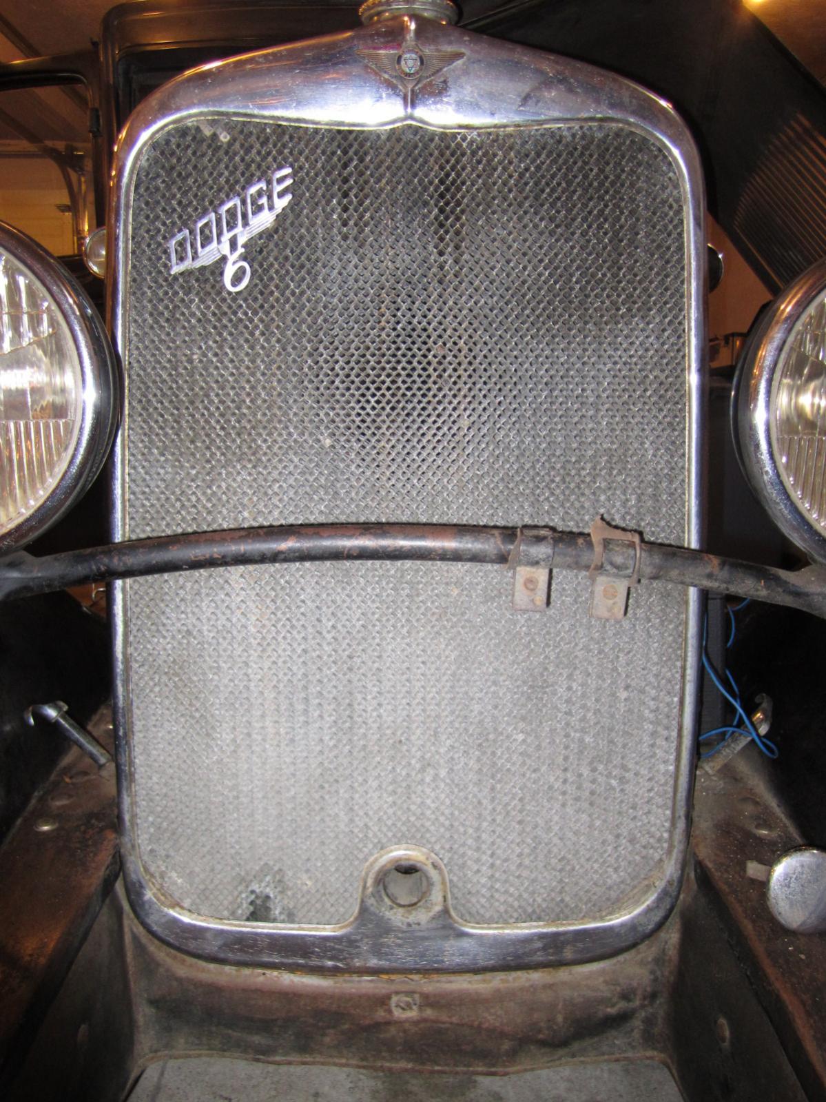

    I've searched quite a bit on The Hamb looking for a basic black grille insert for my 1930 Dodge Sedan. In stock form, the radiator itself acts as the grille insert. As I'm getting a custom rad and plan on doing some decent highway driving, I'd like to put an insert in just to protect the rad fins. I'd like to keep the tight honey comb shape it has now. Any ideas of where to get such a material that I could paint or powdercoat? Thanks!

    Are you tossing the original? Would it be ok to just leave it there with a custom shroud to conceal it better and provide better pass-thru?

    Have seen a speedway radiator protector used on an early dodge grille. Painted black it looked like the rad. Used on dirt track cars.
    Speedway p/n 917-34215

    Check industrial lighting outlets for plastic light "grilles" or metal suppliers for punched metal sheets with octagonal holes. That material has been available.
  5. I have heard of people cutting a slice off the front of the honeycomb radiator and mounting that in front of the more modern radiator to keep the honeycomb look, don't know if that's a possibility for you?

    McMASTER-CARR....wire cloth....stainless steel, many sizes of mesh. request they ship it flat! shipped mine in a tube once...had to reorder it. :eek:

    Looks like McMaster-Carr has what I need. Thanks!

  13. Oh, and if you really want to keep the original look of the radiator, then take a 1/2 slice off of it and mount it in front of the modern one- the wire mesh has the initial look, but not the depth!

    Taking a slice off would be cool. I gotta find a place that would be able to make a clean, fluid cut though.
