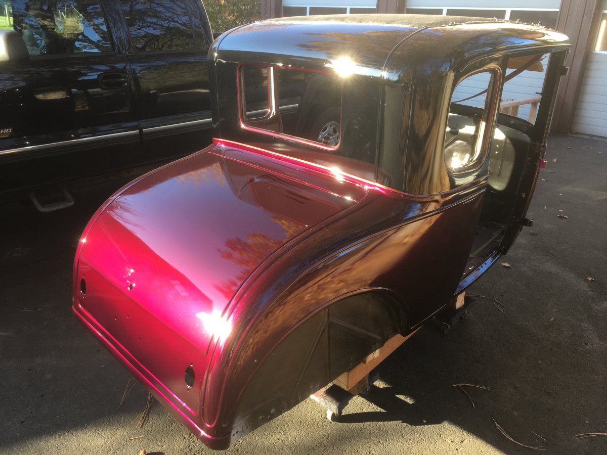

    I’m about 8 months ahead of you on the journey. I wanted to paint my Model A coupe, so I did what some of the folks are recommending.
    I watched a lot of stuff on You Tube, read a bunch, and enlisted the help of a buddy who could paint.
    I bought a $35 or something HVLP gun from HF (the ‘good one’) but haven’t used it. I figured with all the effort and money I was going to invest in the work I should buy a better gun. I bought a HVLP gun from Eastwood with 2 tips for about $180. There are much better guns, but I’m a beginner. I have a cheap 30-gal Craftsman compressor.
    I built a spray booth out of one of the bays in my garage. 2 x 4s, clear plastic, lathe, a few box fans with furnace filters.
    I bought a good filter mask - one that takes care of organic vapors, and wore a cheap Tyvek coverall I got an Home Depot. I used a modern basecoat-clearcoat paint system. That stuff can kill you if you aren’t smart about it. Be safe.
    I cut my teeth on laying down some epoxy primer on a few parts. Huge runs, but I learned.
    My buddy and I painted the car in the booth. He laid down the sealer, I did the black ground coat with him guiding me a bit, he laid down the candy base coat, and I ultimately did the clear with his guidance. Turned out fine. I made a few runs, but sanded them out just fine. More nibs than I hoped for, but hell I painted it in my garage.
    Some of what I learned:
    The compressor was able to keep up. 150 PSI 30-gal job. I drained the water first and used a disposable filter at the gun. A bigger one would have been better, but it worked.
    I probably could have rented a real booth for the $350 or so I put into the home made booth. However, I can use it for other stuff.
    I spent about $1200 on paint to do that car and weeks of my labor and materials on the prep. I feel good about using quality tools and materials.
    I wish I would have painted the car when is was warmer than 22 F. I spent about $300 to heat my 36x60 ft shop to 70 degrees for a few days.
    I learned a lot from some of Kevin Tetz’s videos. Jon Kosmoski has a long one, but look at all you can. Check them out.
    I had fun learning and doing it. You will too.
    A 2 B, belair, Dino 64 and 11 others like this.

    One hell of a paint job, Almostdone

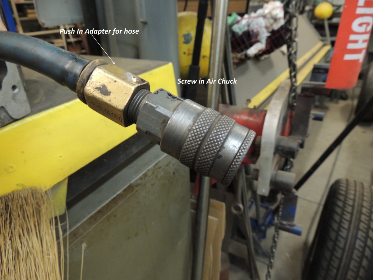

    First you need to realize that you need a decent supply of cool air because you will be using a "high volume" but "low pressure" spray gun. That means that using a small hose size and fittings with a small p*** thru p***age will inpede your quest for volume. Many people are still able to get decent results, but since you are starting from scratch, why not buy things that help you. Milton sells air chucks and fittings in "automotive" and "industrial" types. The industrial type will be physically the same size externally but the "p*** thru" hole will allow over twice as much air to flow at the same LOW pressure. Get quality air chucks with more than 3 bearings inside and then you won't be replacing them later on. I recommend buying the more expensive "push on" type hose that Parker and most other industrial hose suppliers sell. Buy the air chucks on line as the industrial store price for one chuck is about $35 while you can get 4 or 5 for that on line. The hose costs about $2 a ft at the store. No more leaky annoying hoses and they last forever. If you did get a leak at a fitting, just cut it off and reinsert the fitting. I have several hoses and not one has ever leaked.
    Here are some pics of the fittings showing the difference in p*** thru size. Thread size is the same. Also note the end where they insert into the chuck because there are different shapes and the fitting you buy has to fit the chuck you buy.
    Just toss all the old fittings. Using the larger fittings also allows you to provide more air volume to your tools and a sand blaster later on.
