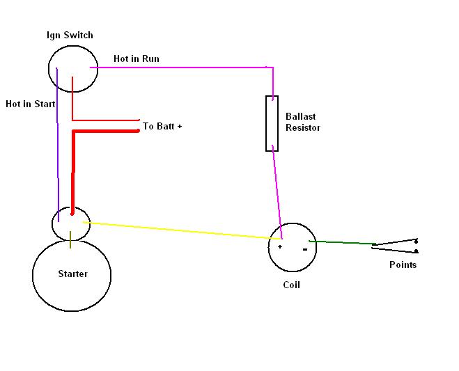

    I need to wire in a points idssy into a friend's roadster to get him going - has anyone got a diagram handy that I could use?
    Dist is a Bosch single point set up modded to suit a flatty, I think it was an original MoPar single point setp with the housing/shaft modded to suit the FH.
    Basic diagram is all I need to get him on the road till he gets his Vertex mag rebuilt....any info would be great !!
    Thanx guys !
    Rat

    something like this? :confused:
  3. Haha thats it thanx man !!
    Rat
