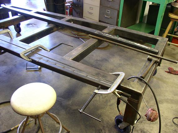

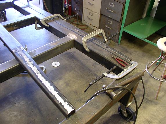

    ran out of grinder discs,
    so while the welds cool and before i go get some more,
    here's an update;

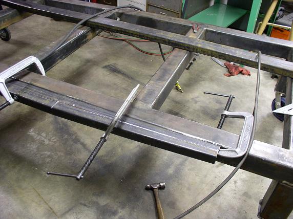

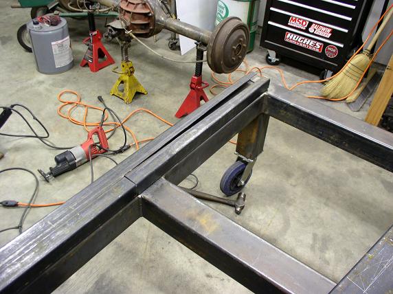

    measured the stock frame again, this time for the rear taper,
    I'll make the slice right in the middle of the side,
    tapering both top and bottom trying to minimize warpage
    so to end up with a two and a half inch tube height at the end I leave an inch and a quarter top and bottom, tapering to meet at the center 30" forward
    with a small piecut towards the bottom leaving the bottom strip intact
    again with the sawsall and grinder with the thin disc the cuts are made,
    the edges beveled and the rail clamped to the frame table
    and tacked

    and welded,
    then repeat with the other rail...

    mostly I try to clamp everything and leave it clamped till cool
    to not concentrate too much heat in one spot
    to alternate hot spots or better yet
    to ballance hot spots equally so one will cancel the other out,
    like the rear taper here,
    same amount of material top and bottom and side to side,
    same amount of weld on both sides.
    so if clamped solid
    and welded in the same pattern and sequence
    it will stay nice and true,
    which it did :)

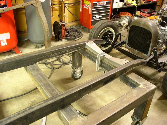

    last pictures for the night as I close shop

    I almost did it that way, because I had planned on stepping it at the firewall anyway
    in the end I did it like this for two reasons,
    first I may not step it and why create a splice when I don't need to
    and second I thought it would give me better control of the piece
    I had thought of building just horns to sell though...
    say from the firewall forward
    maybe a four foot length so the customer could put the splice where ever they wanted...?
