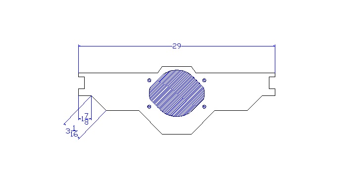

    I can map out the front and post that here too.

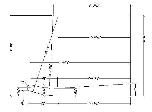

    I mapped out the horn to go with the instructions here..
    let's see if this comes through legible..

    I'm having a hard time getting a clear image...
    I drew this on cad, saved to clipboard, took it to paint and saved as JPEG...
    kinda limited on software here at home..
    worked before.. at work, but looks crappy this time.. here..
    what am I doing wrong?

    see if this is blury...this is my 32 K member drawing that I'm working on......this one isn't finished, the one at work is almost complete.......
    I got my Vern Tardell K member today.....
    I used the "outjpg" command in my command line......named the file, selected the whole object and hit enter to complete the command......this may be what you already did....

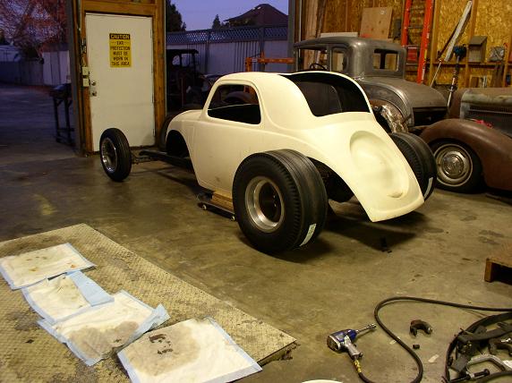

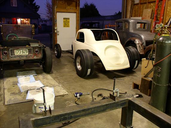

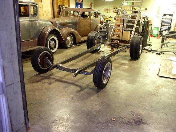

    bolted some wheels to the axles and set the frame on them for the first of many mockups
    while the Model A coupe body is still bolted to the rest of itself
    the Topolino shell was handy,
    so I threw it on there.. just to see what that might look like..

    well, this one IS blury....now you've got me stumped......the one I posted previously isn't blury.......dunno!
