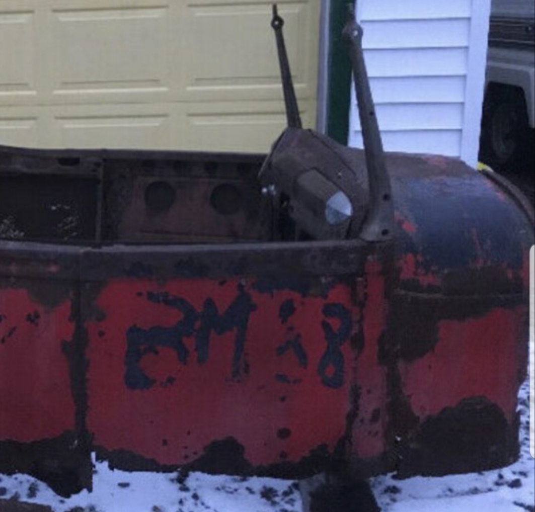

    Someone will confirm that BM 88 may be B Modified if that was a cl*** or not. Either way it is an old Hot Rod and it has a soul that gives it a bit more value than a rusted out stocker IMO. Bob

    Thanks Bob 'Modified' maybe Blown/Modified...:)...A question of this Roadster of note...The snaps on the doors and Quarter OEM or Race Tonneau.?...just saw them...this is a rust belt roadster so Winter and side curtains were standard fare this way I suppose...

    @Joebrownvw can you spot any Robertson screws...that would clarify Canadian or US which helps narrow things a wee bit...
    I would say that if that's a Golden Horseshoe or Southern Ontario Area Hotrod it may have Raced in Buffalo to as it's pretty close by...

    I saw this roadster body on Kijiji a few weeks back and took note of it. I wasn't interested in it as I have a finished 1929 roadster, but you always look at stuff like this when it comes up for sale. Can't help with any history,but there are a couple of guys that live not far from me that used to race at the old Kohler Dragway, ( Cayuga ) and they may remember the car if that roadster ever competed there. With the current health situation going on right now, I'm not even going to bother them.
    I see the top of the gas tank has been torched out, to likely get clearance for a rear mounted distributer, so one would ***ume there was likely a SBC in the engine compartment at one time. I also don't see any outside door handles, and the remains of an inside door latch on the driver's side. I'm wondering if this is an early 1928 body, if so there should be three holes in the panel below that rumble lid, in a triangle pattern, where the drum tail light would have mounted.

    This thing is neat, I liked it in the previous thread although I didn't like the price that was on it, but sounds like you worked out a deal so I'm all for it. It needs a lot, but there's also a lot there to work with. If guys can build bodies from scratch, this thing is definitely saveable.
    The dash and the old paint are great, it definitely had some hotrod history, even if you aren't able to do***ent its past.

    The large hole in the tank houses
    what looks to have been a very crudely made throttle linkage.
    It does have a kinda oddball hanging pedal set up and would have once had a master cylinder mounted on the firewall
    I will check for any evidence of drum light mounting holes this evening and report back.

    So not too much has happened so far as I'm waiting to build a much needed shop!
    Anyway, I have given it a good look over now and maybe a couple of hints to its previous life.
    It looks to have been channeled 4-5 inches.
    Under the dash appears to have been fully wired through the firewall at some point using braided cloth wiring.
    It still has wired in a '49-'53 chrysler/Desoto 6v voltage regulator labeled "made in Canada" suggesting it really is an old Canadian hot rod.
    Firewall is obviously cut and clearanced for something along with the cowl band area too.
    Definitely had a roll bar
    Doors were welded shut and braced from the inside and around the rear behind the seats.
    A few extra pics added too
