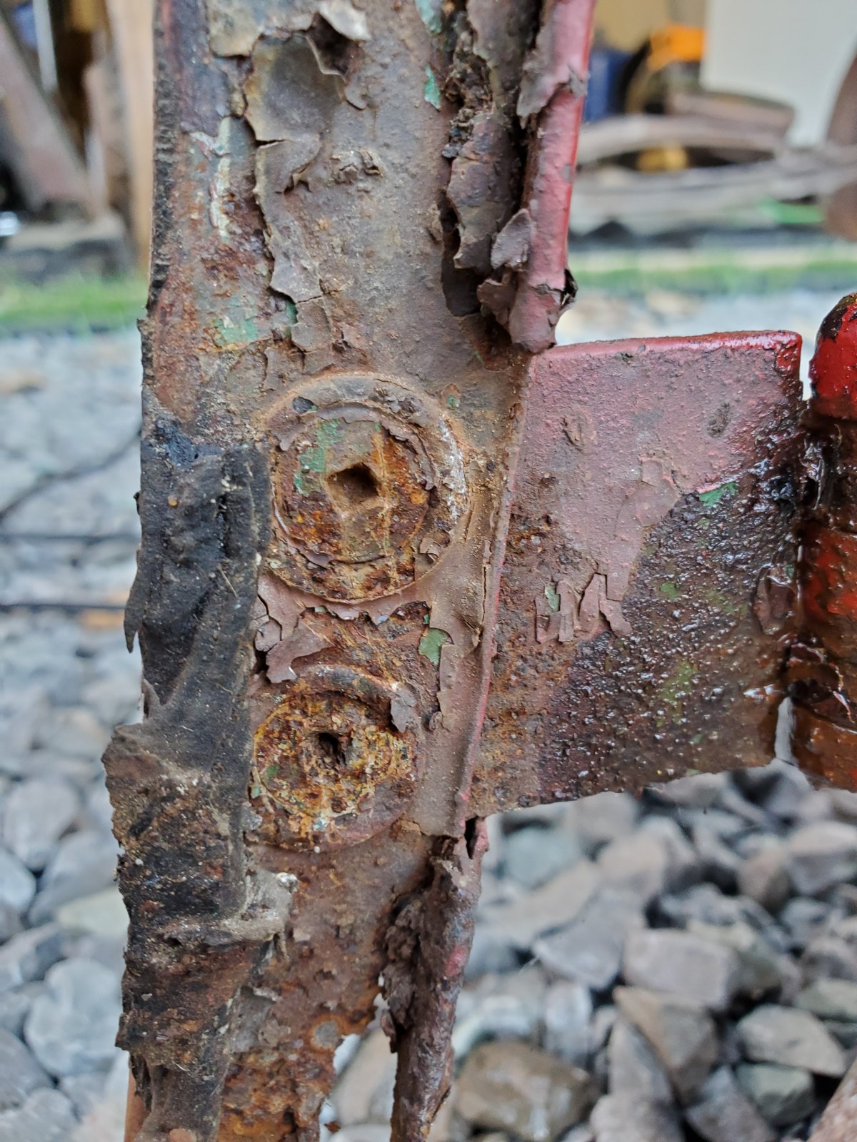

    Carefully cut the welds holding the doors closed and freed up the hinges. Found these
    Robertson screws! Suggesting it is infact a Canadian built car.

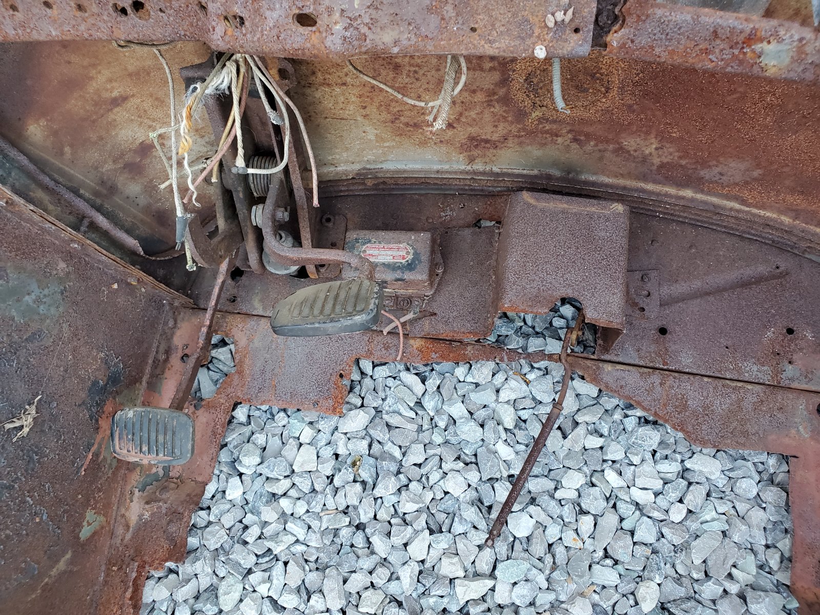

    Also grabbed a pic of the pedal setup

  5. That Brake and Clutch pedal mess looks to have started out 53-54 Ford car parts.

    The Robertson screws Don't necessarily indicate Canadian manufacture. Ford used these back then.

    The under dash picture with pedals shows what looks like a '49-'53 Chrysler Products 6 volt regulator, makes me wonder if it had an early hemi in it..

    You are correct about the regulator, 6 volt chrysler and made in Canada.
    The cuts in the firewall appear to line up With early hemi distributor, 6 volt electrical it does make sense.
