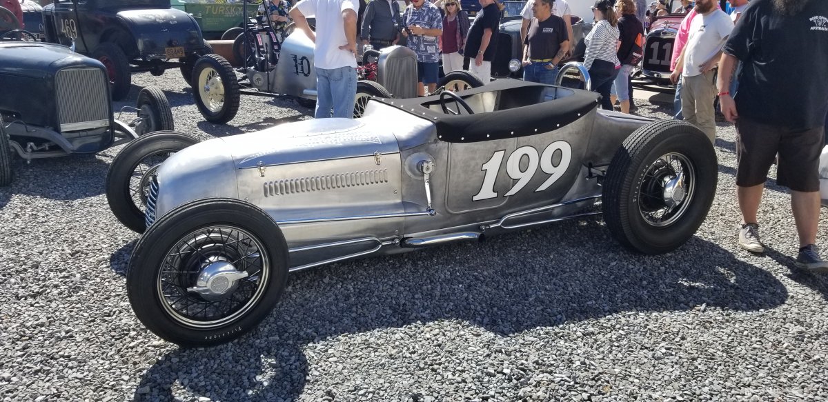

    2019 trog (83).jpg 2019 trog (85).jpg 2019 trog (82).jpg I was fortunate enough to get an up close look at TROG and pictures can only convey part of how amazing this little roadster is. And oh yes it sounds *****in!

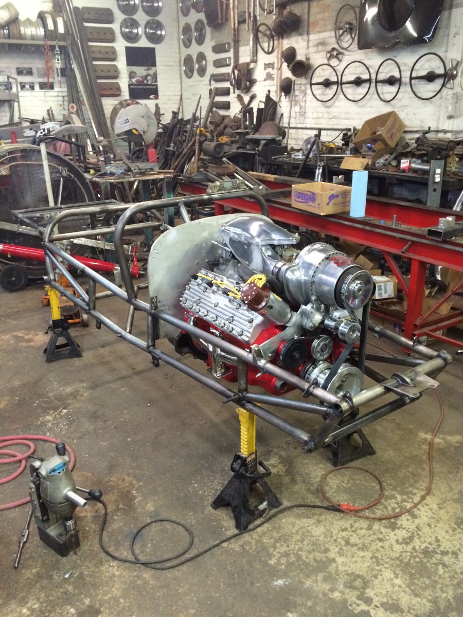

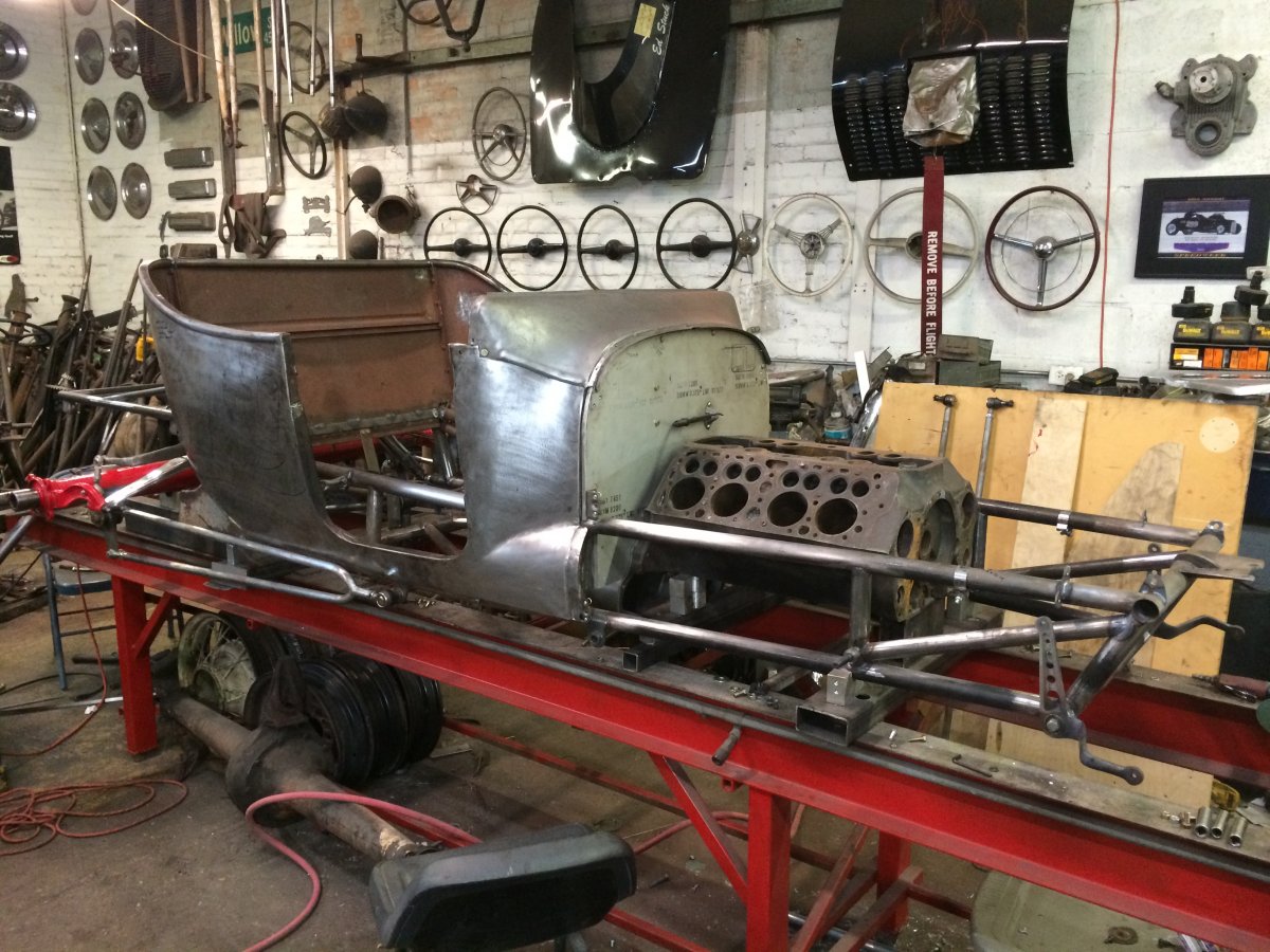

    Here’s a couple photos of the ch***is:
    -Brian

    How wide is the tubing in the ****pit area, from Right to left side?
  26. Bass
    Joined: Jul 9, 2001
    Posts: 3,369
    Bass
    from Dallas, TX
    I think I must have a minor case of OCD because I tend to clock fasteners even when it’s totally unnecessary. I don’t do it on things that need a certain torque rating, but on just about everything else, yes.
    It’s got a Schroeder “sprint car” steering box. I made the pitman arm.
  27. Bass
    Joined: Jul 9, 2001
    Posts: 3,369
    Bass
    from Dallas, TX
    Just wide enough for the body to slip over it as a unit.
    If I were doing it all over again I would make the upper tubes bell out to fit the shape of the body, and unbolt the sides from the rear panel of the body to install it over the frame. Things are tight in the driver’s seat the way it is, but it’s honestly pretty comfortable for a race car the size of a large wheelbarrow.
