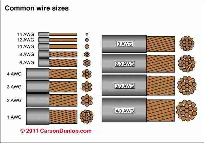

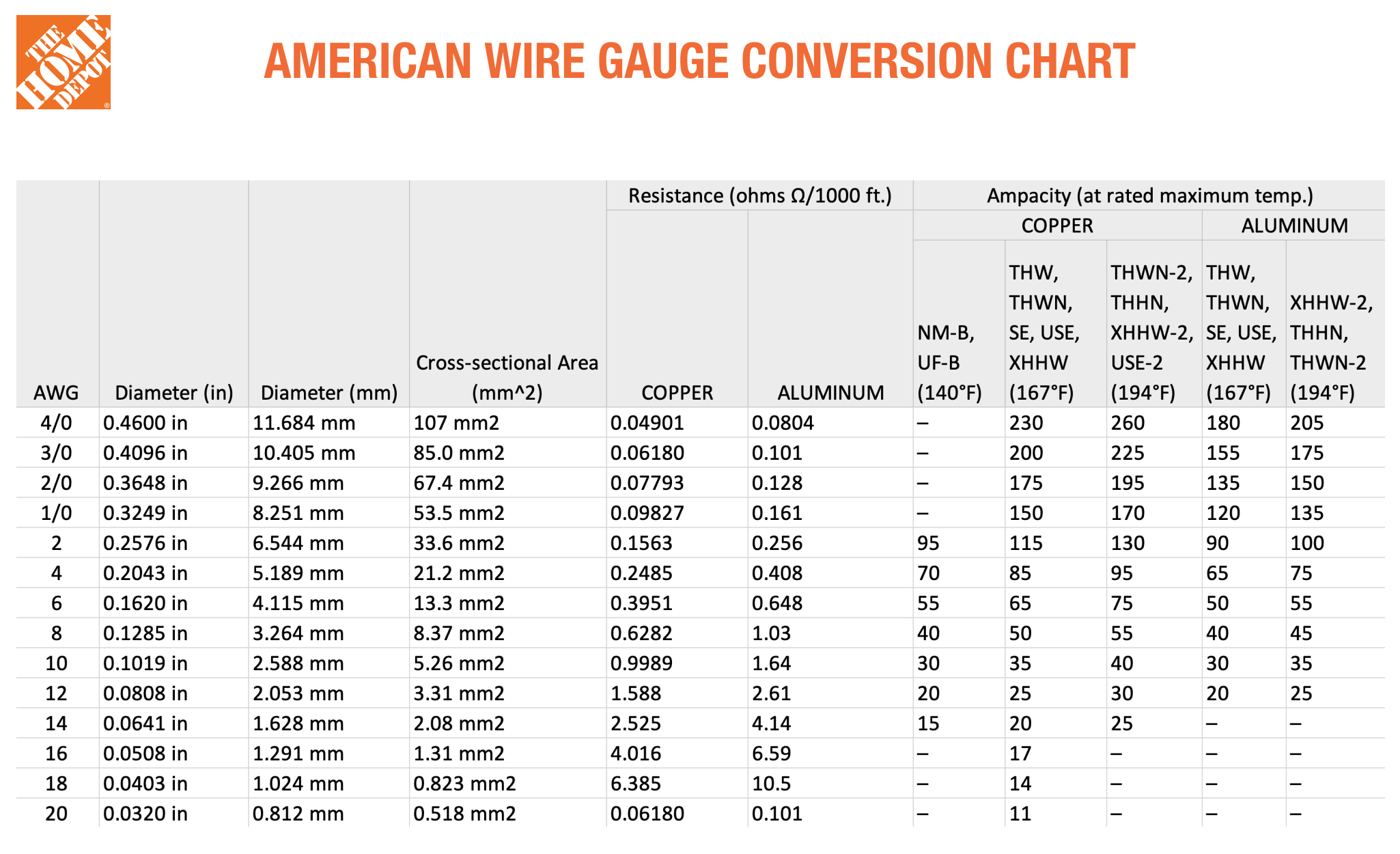

    IMG_2860.png IMG_2858.png Bigger is better, personally I almost always use one size larger wire. Also the longer the run the more voltage drop you get, this is especially true at lower voltages.

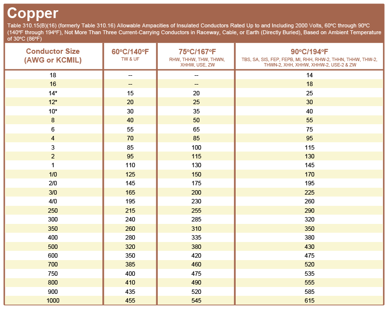

    Those charts are for standard house or commercial wiring, not for fine strand welding cable amperages. Fine strand is more than double what those charts show.

    A solid diameter single conductor is the highest amperage rating anyone could find. It's what most high voltage main lines are made of. It's of course too ridged to use for almost any other application.
    Circular mils will increase the finer the strands are inside one sheath, so fine strand wire does indeed have higher current carrying ampacity because of the lack of gaps between strands. It's about as close as you can get to a solid single wire of equal diameter. But it's not quite the same as a single solid strand.

    You do realize that with automotive electrical wire the smaller the number the larger the wire meaning that 2/0 is quite a bit larger than 4/0 Wire?. Just as it is accepted that a 6 volt system needs the larger cables and wires to have less resistance for the 6 volt battery to push th1e amps through a 12 volt battery does better pushing amps though a heavier 2/0 cable rather than a rather skinny 4/0 cable. New cars with every electrical component in the car get away fine with 4/0 cable simply because normally every connection is good and the is a minimum of resistance in the system. Older rigs like my 77 1 ton with a 454 (common hot rod engine) don't always have the best connections, components in the best condition or wiring in the best shape.

    Show me a modern car with 4/0 on it, rofl
    You have it backwards. 4/0 is bigger than 2/0

    Hold on fellas, were getting crossed up here; Wire numbering has a goofy split at 1 gauge. Starting at 1 gauge and shrinking in size, the bigger the number, the smaller the wire, and going the other way from 1 gauge, that is, 1/ought, 2/ought, etc., it gets fatter.

    Oughts are a whole different thing. A 00 is smaller than a 0000. One should not ought to be too testy.

    Not sure where you got that info, but it's not correct. 4/0 is much larger than 2/0 and carries far more amperage. What you say it true up to #1 size, but after that the more zeros after the number the larger and higher amperage it is.
    Check out this chart at Cerowire:
    https://www.cerrowire.com/wp-content/uploads/2021/04/Cerrowire_Ampacity_Chart_210405.pdf
