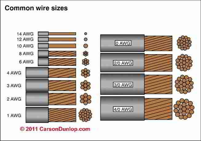

    Another chart that doesn't apply to welding cable or fine strand cable.

    I like the OP plan on installing the battery in the trunk. What I’ve learned:
    -Most short run universal cables are 2 ga.
    -Many package trunk mount kits 16 ft are 1 ga. Some are 00.
    -Automotive battery cable is oil and gas resistant and has fine stranded wire.
    -Most welding cable is not oil and gas resistant but you can indeed get oil and gas resistant welding cable. Also fine stranded.
    -Welding cable will work , your ride should be relatively clean, oil and gas leaks should be fixed.
    -Fine stranded wire has a higher amp rating per gauge, should’ve and maybe did know this. To this end you should use a chart for the given wire.
    Dan

    Lane,
    Thanks for this pic. I've saved it and now I won't have to explode my brain trying to figure out what wire size I need.
    I've been following along on this thread 'cause I'm about to run a new wire from my rear mounted battery forward (to new remote battery terminals in the engine bay) on Clarence.
