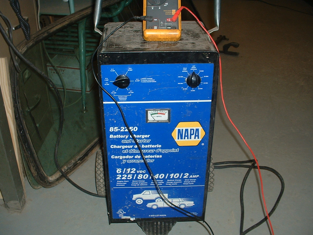

    So I suspected our battery charger is not charging, would put it on a battery and it didn't seem to help. I hooked up out DVOM and got nothing on DC voltage, nothing on DC amps, so I guess it doesn't work anymore? Is this a valid test? Is there some sort of "fuse" or "circuit breaker" internally that can be replaced or reset, is there anyway to fix these things? thanks-

    I would connect the charger to a battery, leave it turned off, and connect the voltmeter to the battery also, with it set to DC Volts. See what the voltage is. Then turn on the charger, and see if the voltage increases. If it does not, then the charger is probably not working.

    yes, there can be fuses and circuit breakers. I check both alternators and chargers by measuring battery voltage with nothing connected then connect charger and see if voltage goes up if it goes up charger is working. if the charger doesn't move when it is connected, disconnect everything and take the cover off and look for fuse or breaker

    hooked it up to a DEAD battery (12.1 volts), turned the charger on and nothing, still 12.1 volts...will open it up and see if there is a fuse or breaker...

    The 85-2250 NAPA charger is built by Shumacher. From the users manual:
    http://www.manualslib.com/manual/149446/Schumacher-00-99-000207.html?page=12#manual
    9.6
    OVERLOAD PROTECTION
    The charger uses an output circuit breaker and a thermal breaker to prevent overheating and
    damage to the charger and the vehicle. If after repeated starting attempts, the charger does not
    indicate any output on its meter, it may be because one of the two breakers has opened. If the
    output breaker opens due to excessive current, a popping noise will be heard. It will automatically
    reset itself in a couple of minutes. If the thermal breaker opens, it will automatically reset itself in
    about 5 to 30 minutes.
    And here's your parts list if you need new components.
    http://www.centurytool.net/85_2250_NAPA_Battery_Charger_Parts_List_s/275.htm

  7. Also check the selector switch; the one on mine started to come apart and lost connection (it snapped together). I super-glued it back together, no issues since....

    My quit a while back...opened it up and found one wire was disconnected off the transformer...simple fix....i suppose rolling around on the hard wheels these take a pretty good beating...

    Turns out that was the problem with ours too, learned quite a bit about the chargers due to the problem though...
