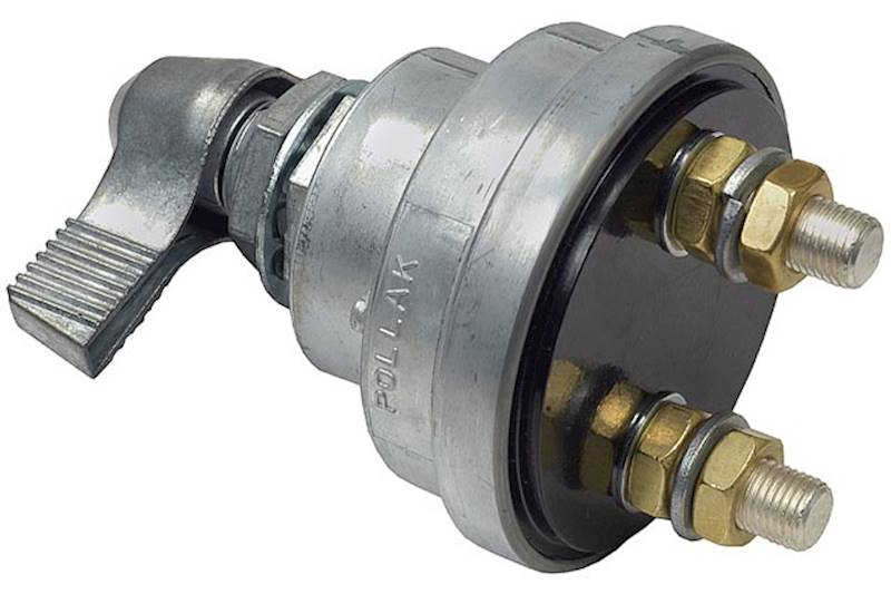

    buy a Pollak switch pretty much “ the standard” on heavy equipment and industrial applications .
    heve some that are 10 years old on skid steers and wheel loaders that are working just fine .
    Biggest thing is the contacts being solid copper and the contact tips being quality as well .
    lots of “ copper clad “ **** out there with small under spec tips the will **** out way to soon .

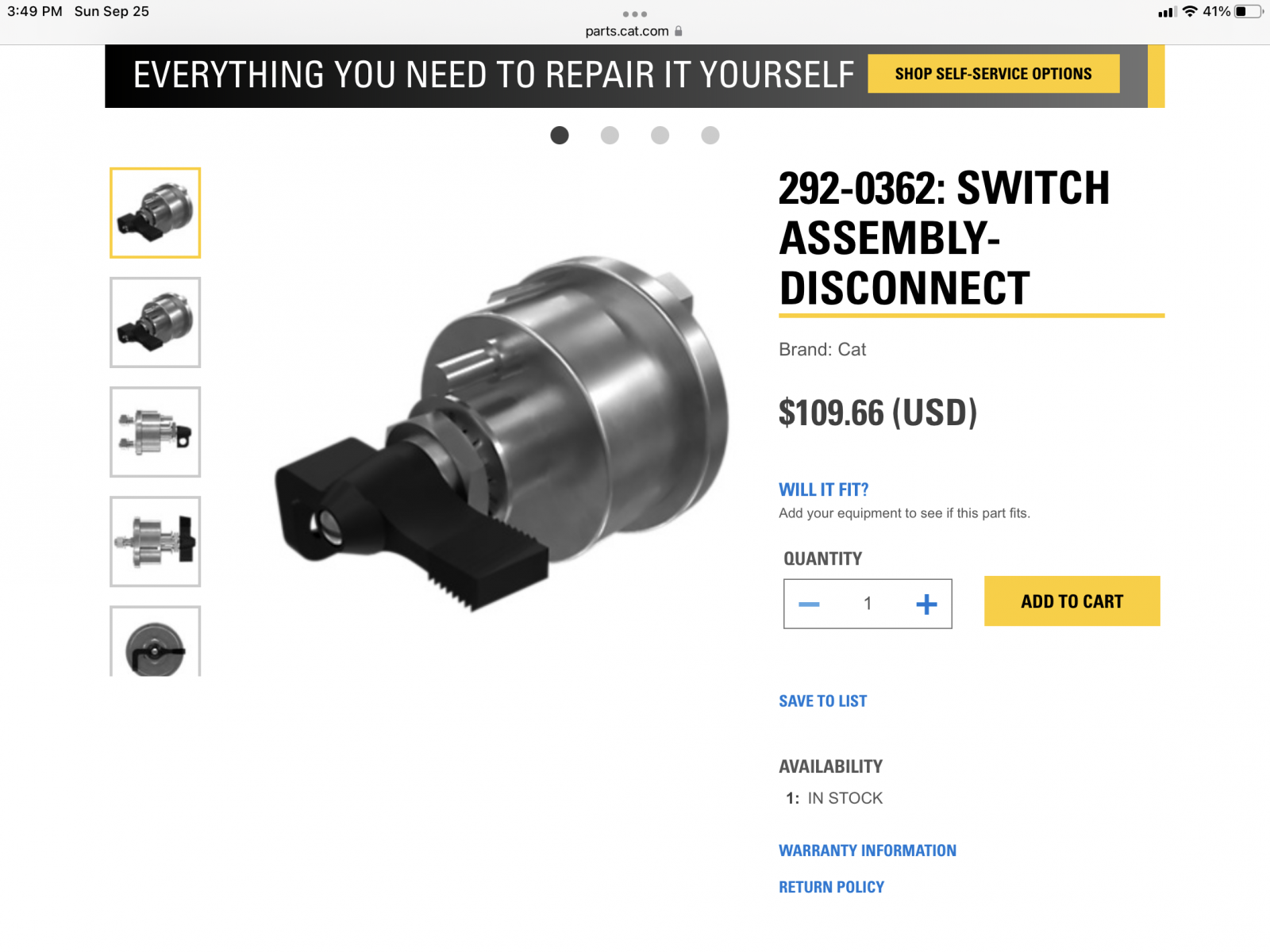

    Even better than that Pollak switch is the genuine Caterpillar master switch that is very HD. Never seen one fail, and used on some very stout 24V systems- and has a key. All the others like the Pollak are copied from that design- at least on the outside

  24. MeanGene427
    Joined: Dec 15, 2010
    Posts: 2,307
    MeanGene427
    from Napa
    This is the real deal, that all the lighter-duty and maybe Chinese copies are made to look like. This is the one used on up to a D8 or D9 dozer, controlling dual 8D (huge) batteries on 24V systems. You want bulletproof, this is it- and it has a key for security
