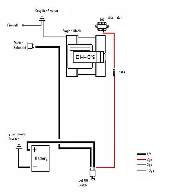

    I use a car audio style circuit breaker close to my battery. 1 gauge shorting to ground with a full battery & running the full length of the car (past fuel lines and tank) can really ruin your day. OH & don't run your negative cable the full length of the car...it's called a circuit for a reason. the shorter the run the least resistance. Use gromets & ground to the body & Frame as close to that rear mounted battery as you can. bare back the metal & use star washers. You won't have problems.

    Circuit breaker is a good idea, but it is about the same distance between the starter and the battery whether it is a ch***is ground or a direct run via cable from the battery, except the cable will be a better conductor.
    IMO a ground from battery to starter via cable is the best for a remote battery. Probably not necessary, but I always ground right th the starter anyway.

    200 amp ANL fuse/fue holder can be found at car audio shops
    this method will kill the motor when the switch is pushed. I'm told the fuse keeps the alternator from pushing too much juice back through the car should something happen to the battery connections
    I had to run the cables through the interior due to unibody design not leaving me any frame rails to hide them inside.
