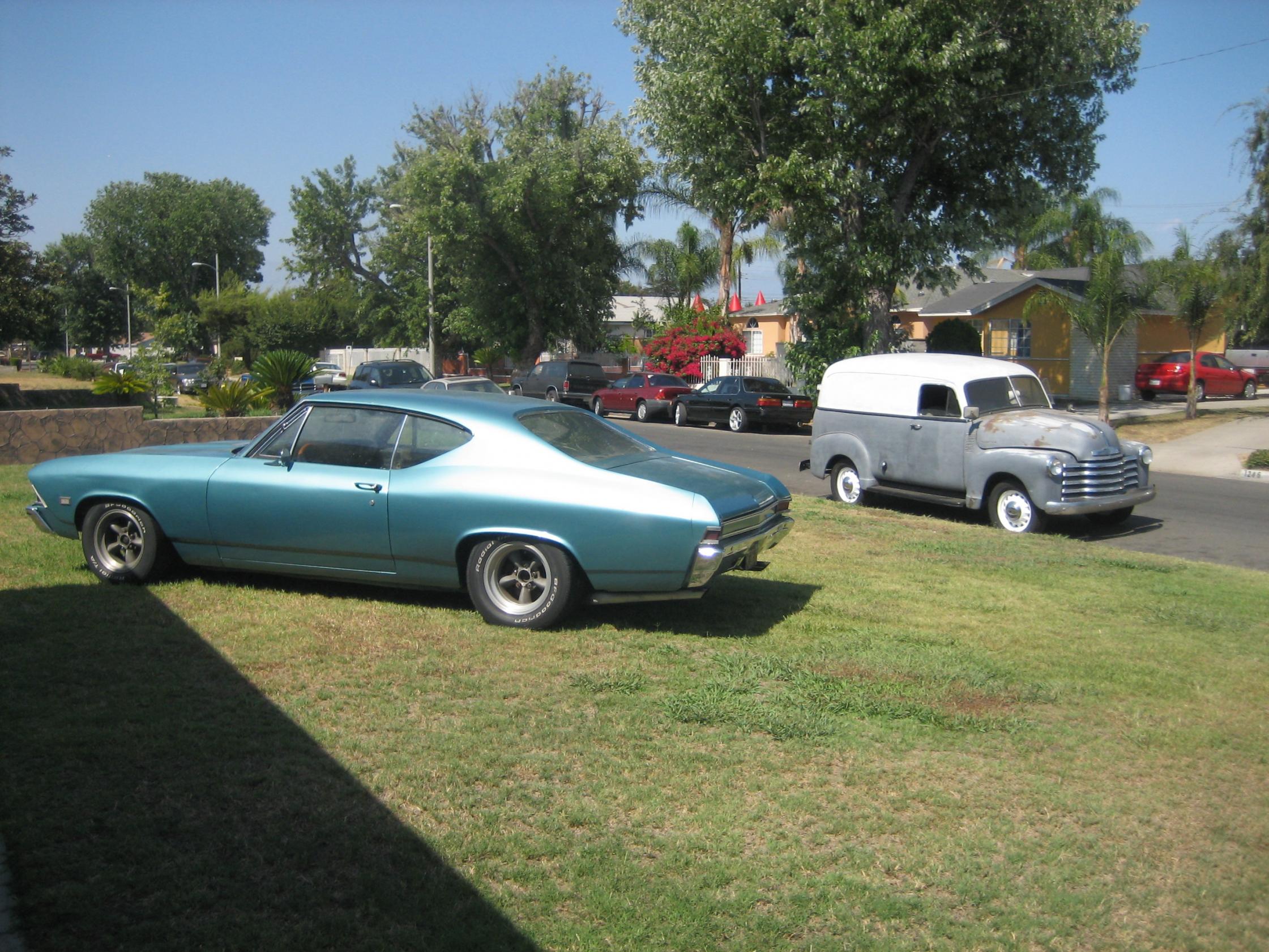

  12. MATACONCEPTS
    Joined: Aug 7, 2009
    Posts: 2,069
    MATACONCEPTS
    I had it for several years in my 68 & the fumes still caused corrosion. I put it back in front on the fender well (stock location), before it caused any real damage.
    ****, let it corrode the fender well, NOT the Trunk, NOT the Quater Panel.
  13. MATACONCEPTS
    Joined: Aug 7, 2009
    Posts: 2,069
    MATACONCEPTS
    Don't do it!!!
      519 KB
      131
