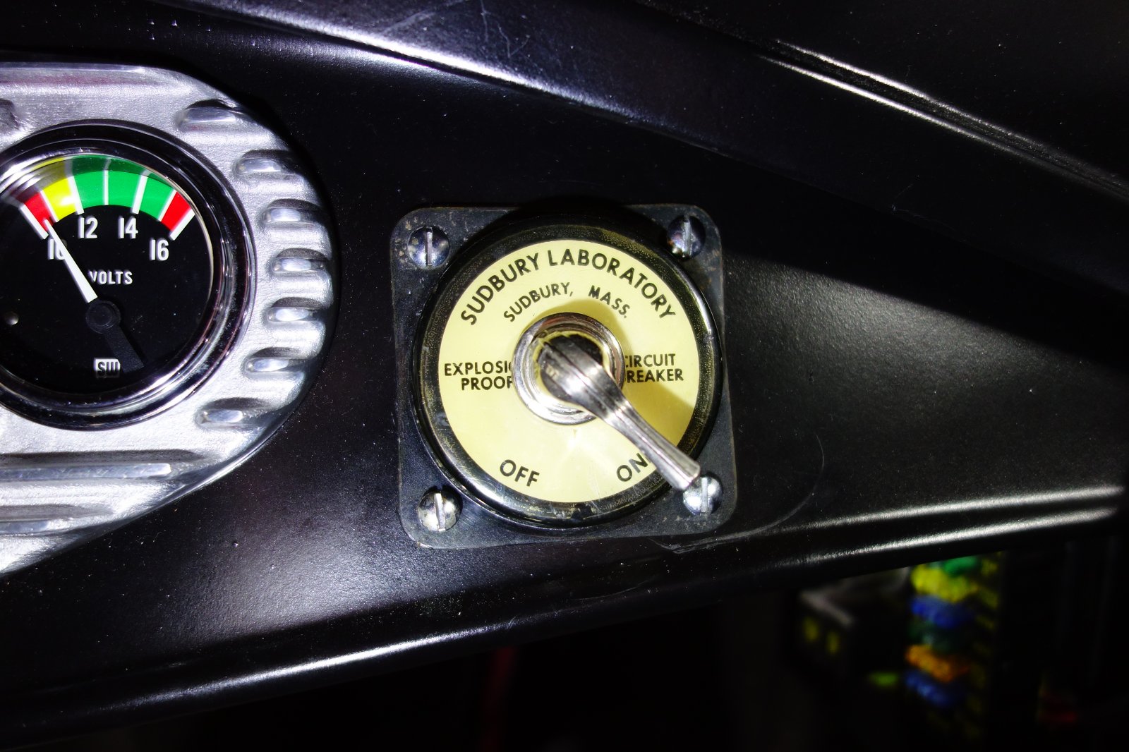

    I put a standard heavy duty disconnect on my dash....within easy reach in my A coupe. Found an old 50's boat Sudbury Laboratory circuit breaker switch and used the face plate. Also the arm off a vintage toggle switch. Looks vintage in the front but all business out back.

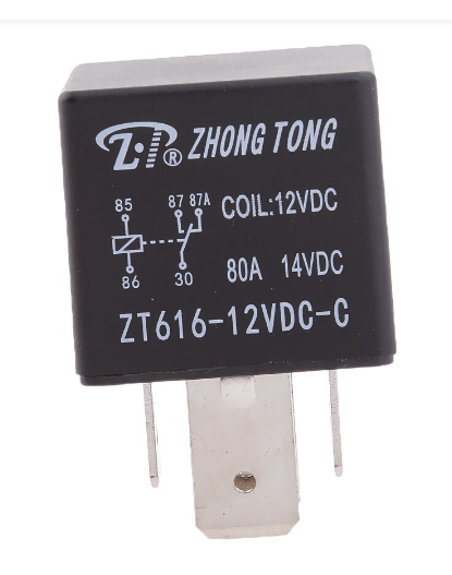

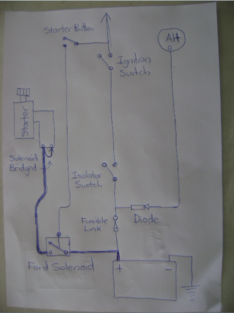

    Just use a Ford starter relay mounted close to the battery for the starter circuit [and bridge the solenoid on the starter]
    That way the H/D cables are dead as a dodo unless you're cranking the engine.
    Here's a Schematic of how we did this on our Race Car [up to FIA standards]
    Note: we used a blocking diode on the charge circuit because we're always tinkering in the engine bay.
    Then you can use a 80a [max] SPDT relay to power the rest of the car.[where the "Isolator switch" is in the above schematic]
    With the SPDT relay you use post # 30 from battery
    Post # 87 goes to the main harness
    Post # 87A goes to any memory circuits eg: Stereo or Clock
    [then bridge post 87 to post 87A with a blocking diode of approx 3a between them]
    That way you can disconnect the whole system and not lose clock or radio memory
    All you need then is a low load switch to power up Post# 85 or 86 [one being grounded]
    A simple latching [press on /press off] ****on would do that.

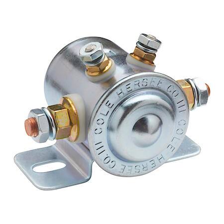

    Cole Hersee 24200, a latching solenoid that wires into the positive cable. Only a small ground wire required, to a push ****on, anywhere you want it. Push the ****on once, power on, push it again, power off. IMG_0671.JPG
    Just Gary, uncle buck, SS327 and 5 others like this.
