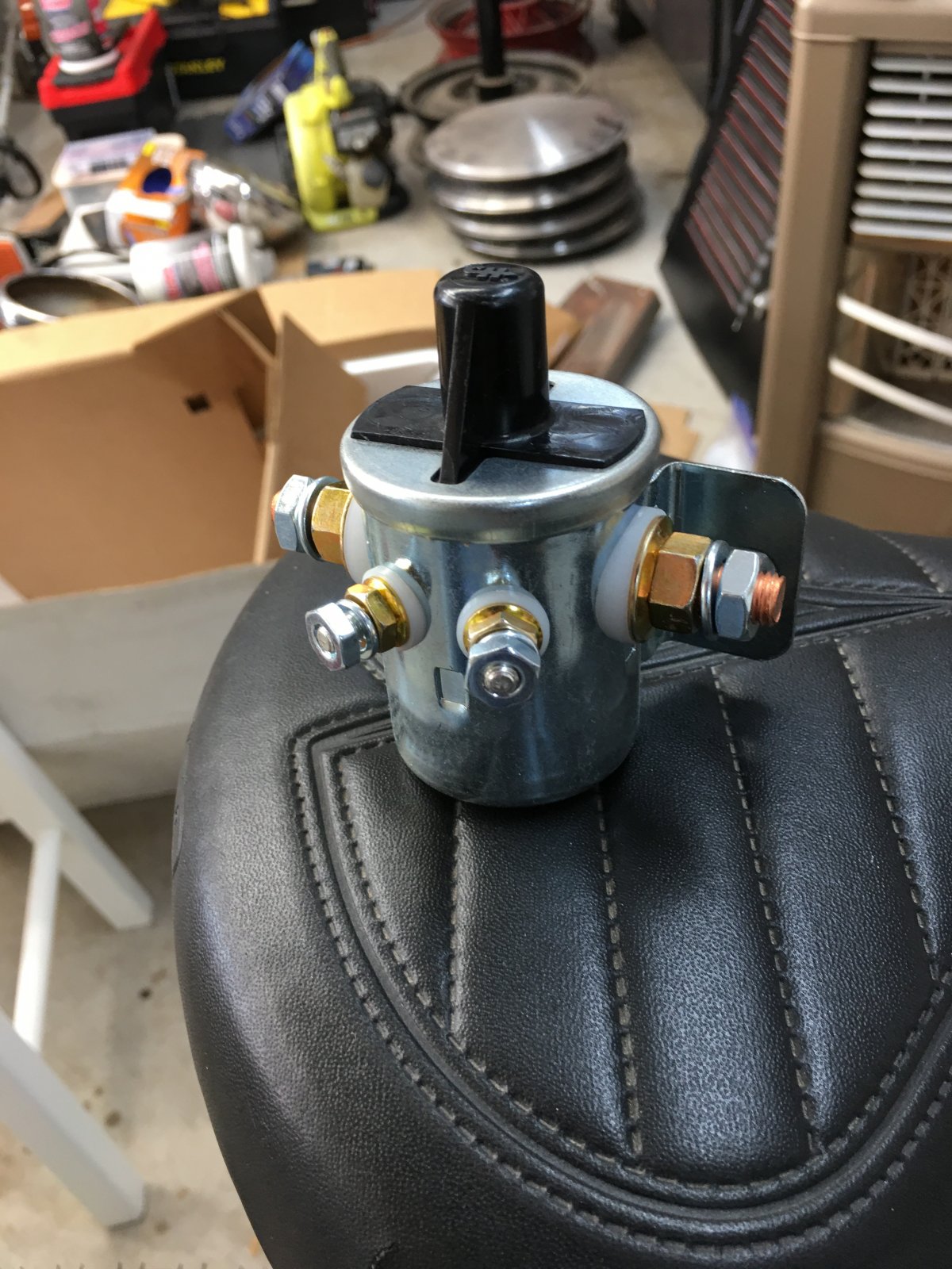

    325w
    Get these at the local electric supply 6FF66C12-B342-48D7-81D3-AE06FDF239F5.jpeg
    olscrounger likes this.

    This is essentially the Cole Hersee 22400 that Marty mentioned. It’s also available From NAPA as either a TWD # 24200BX or an Echlin ST-90. If you’ve ever looked at a Painless Wiring remote battery disconnect this looks to be what is included in their kit
    clem likes this.

    If you use a solenoid you simply run a small fused wire to the control switch off the positive post direct off the battery. Same as you would to save memory for the radio if you install a manual kill switch.
    I have my cars with manual kill switches, but alarms and radios get a 2 a. fused constant hot to work.
    clem likes this.

    If you use a Cole Hersee 24200, there is no power needed at the switch, the switch simply makes the ground to switch the solenoid on/off. A small jumper wire goes from the large, battery terminal to the smaller terminal to power the solenoid, that's it.
    clem and teach'm like this.
