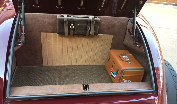

  7. Bandit Billy
    Joined: Sep 16, 2014
    Posts: 17,222
    Bandit Billy
    Mine is "dressed" in leather and carpet but the battery is quite at home. Use your imagination and a battery that doesn't off gas and hide it in plain sight.
