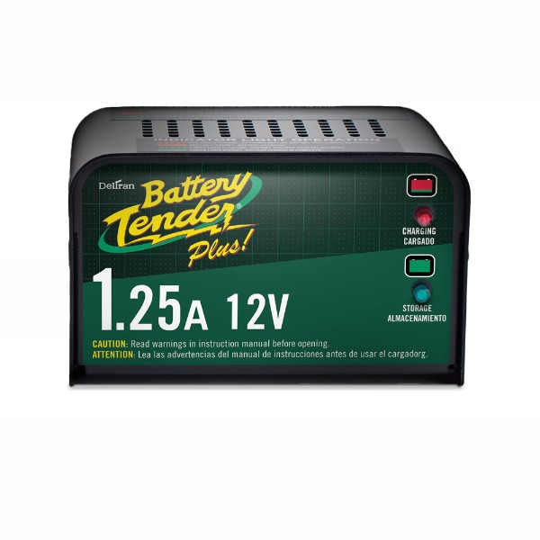

    I have 2 Odyssey AGM batteries and two of these

    I brought the same Deltran battery tender plus one pictured above. I haven't used it yet though. I got gun shy when shortly after buying it I saw all the fancy supercars burnt up at copart. turned out all the cars were from one collection and the building they were in got hit by lightning and traveled thru the electrical and any car that had a tender on it got fried. Some were minor while others were pretty toasty looking.
    So I got gun shy here seeing I am in lightning central. that is why the weather tower is my neighbor, they wanted to be close to where the weather actually changes fast.

    Even nearby lightning strikes can cause huge induced voltage spikes in household wiring and really fry sensitive electronics. When Thunderboomers lurk nearby I definitely make a point to disconnect and unplug anything like a battery tender.
    In fact I pretty much disconnect anything that is electrical including shutting power to the outside A/C Unit and air handler.
    When the inevitable electrical power outage occurs I immediately pull the main breaker. I can wait, till power is restored and steady, the incoming voltage surge(s) and sags when electrical service is restored by the utility isn't anything nice.

    H'mmm. Might be a good idea to plug the tender into a surge protector then.
