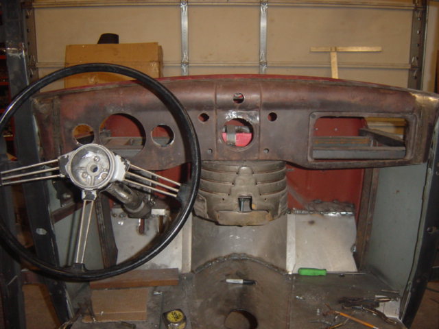

    We mounted a 12 volt Optima battery inside an old Arvin heater under the dash.

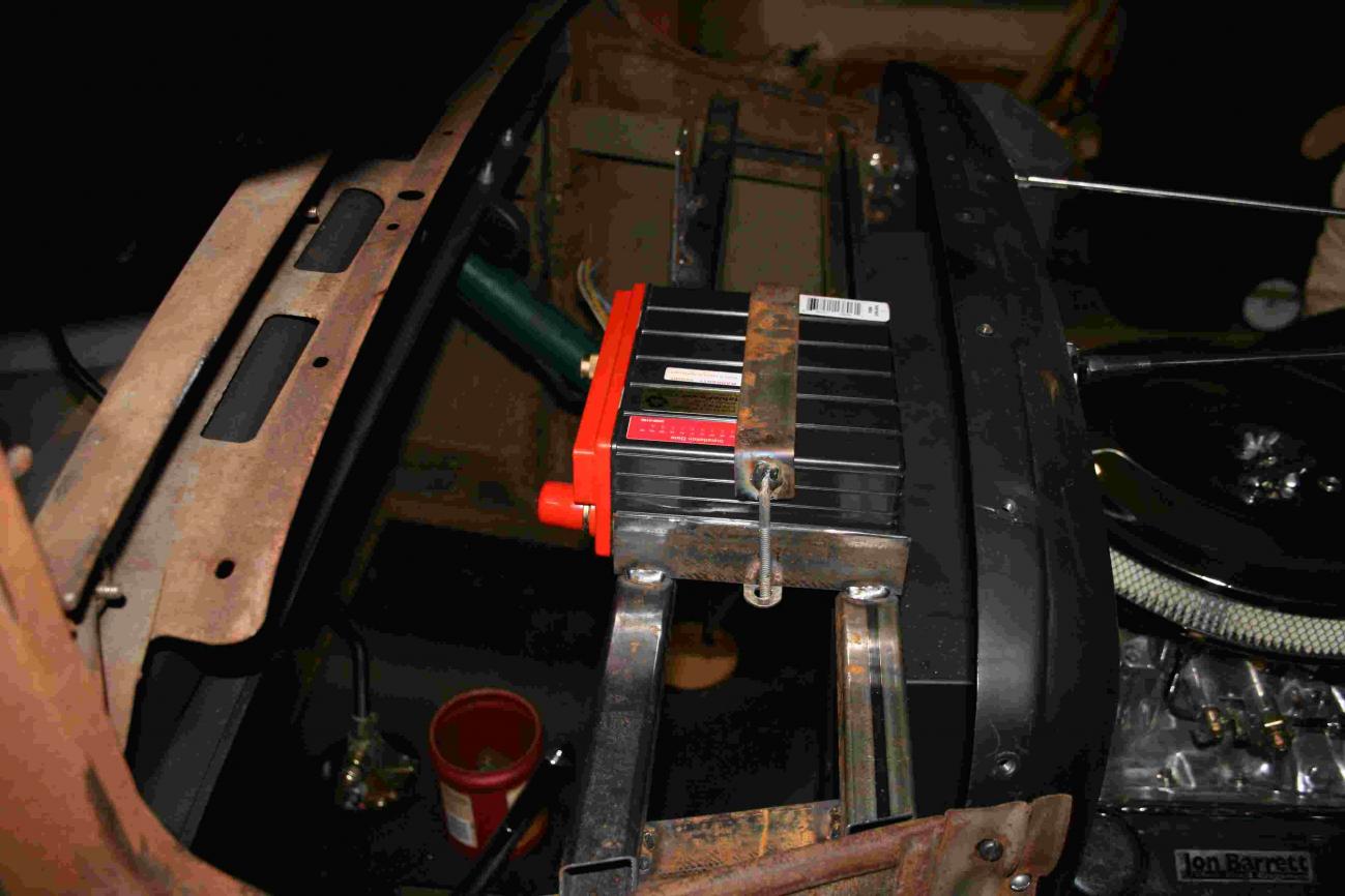

    I've got almost an identical mounting in my '31 coupe, except it's more of a tray, rather than a box.A bit hard to get to, but the only possible place. It will take a pretty heavy cable to run power to your engine/etc. make sure you have the right size.
    Also, to make things easier, I have a horizontal plate mounted to the inside of the frame rail under the passenger seat which holds remote jumper ports (Ron Francis) and a keyed master disconnect switch. And, under my modified running board is a small (1.5x2") plastic lidded port that holds the
    wires to connect the trickle charger I use when I'm running the car for a while. You can't see anything from up top, it's all pretty accessible and
    it is pretty clean under the car,too

    I am mounting my PC680 under the dash. I welded as plate to mount the fuse pannel to as well. I need be I may brace the dash with it.

    Here are some photos of how I did my battery mount in a '31 A Coupe. The first one is the plate showing the battery jumper posts. The second is the small box that contains the connector for the trickle charger-it's tucked into the box when I'm driving. The third is the rack that holds the battery. The fourth is the post/switch plate from a different angle and the fifth is a shot of my running boards from the top.
