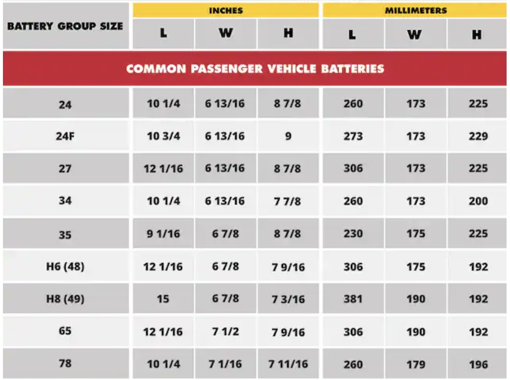

    So I know batteries come in all sizes shapes and forms but what the consequences on a size for a nostalgic flathead powered roadster with no bells and whistles? I need to build a battery box for my T roadster project and it will live in the trunk. I would like to use something that a guy can get anywhere you are in your travels. What’s a dimension that doesn’t take up much room that a guy could find in every town where ever ya go?

    Group 24 was the most common 12v in the older days, and is pretty easy to find, and several other sizes will fit in that hole. If you make a smaller place for it, might not be as easy to find what you need when you need it.
    Although 26R works if you want to save some room/weight. They're pretty easy to find (walmart, etc)

    35 group size is decently compact and should offer enough cranking power for most applications. Depending on the economy-premium you can buy just about anywhere will give you different cca and reserve capacity. Most the time you look up a battery application for older or "universal" they show a 35/75 which will give you top and side post. I could be wrong as well but I think that's the sizing for most your cheap off the shelf plastic battery box size. I'd say your most common sizing as well.

    Might correct myself in I think most battery trays are a 34/78. I'd agree with squirrel as well on 24. Depending on size and cca ifs it's real tight a 51 is used in most Hondas that I recall and is also pretty common. Good luck on a 51 if you need more than 600cca though, I believe that's where most max out in that group size for a premium.

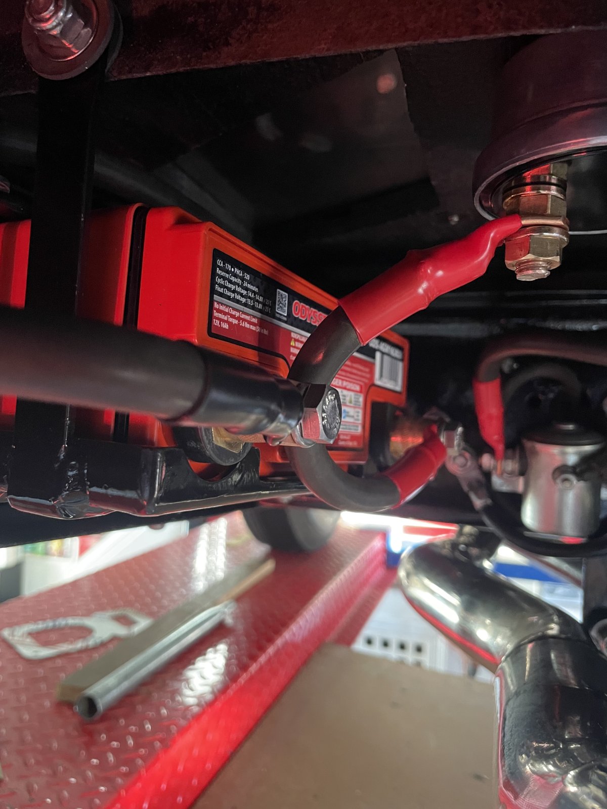

    I’ve been running an Odyssey PC680 battery in my roadster for years. You won’t get anything smaller. Just installed one in my coupe .

    24F for me. Fit most everything, although the post are reversed from type 24. Might matter to you, might not.

    Doesn't the F mean Ford, so the posts are reversed from all the batteries that don't have the F after the group number?

    I believe it means flat top, if you look at a 24R they have the caps that protrude over the top instead of being flush like the 24F.

    I use group 34s in everything, can get them with 1000 cranking amps. Even in the dead of winter they'll crank up big blocks. They are an inch shorter than 24s. Common enough that the local wrecking yard usually has 2 or 3 at a time for 35 bucks a piece (yeah I'm a cheap *******)

    You Betchum Red Ryder, that is exactly and only what it means. Post orientation is set up to work best with a Ford. Put a regular 24 in that same Ford and the cables often don't reach or the posts are too close to something you don't want them close to like the hood on some cars. Same with putting the 24 F or any F in a GM car or truck, It is a strain to get cables to reach. I just pulled my couple of years old battery out of my 77 C30 and stuck it in my mom's 76 F250 and ran into that. I just decided that If I was spending 200 bucks on a new battery the new one was going in my truck .
