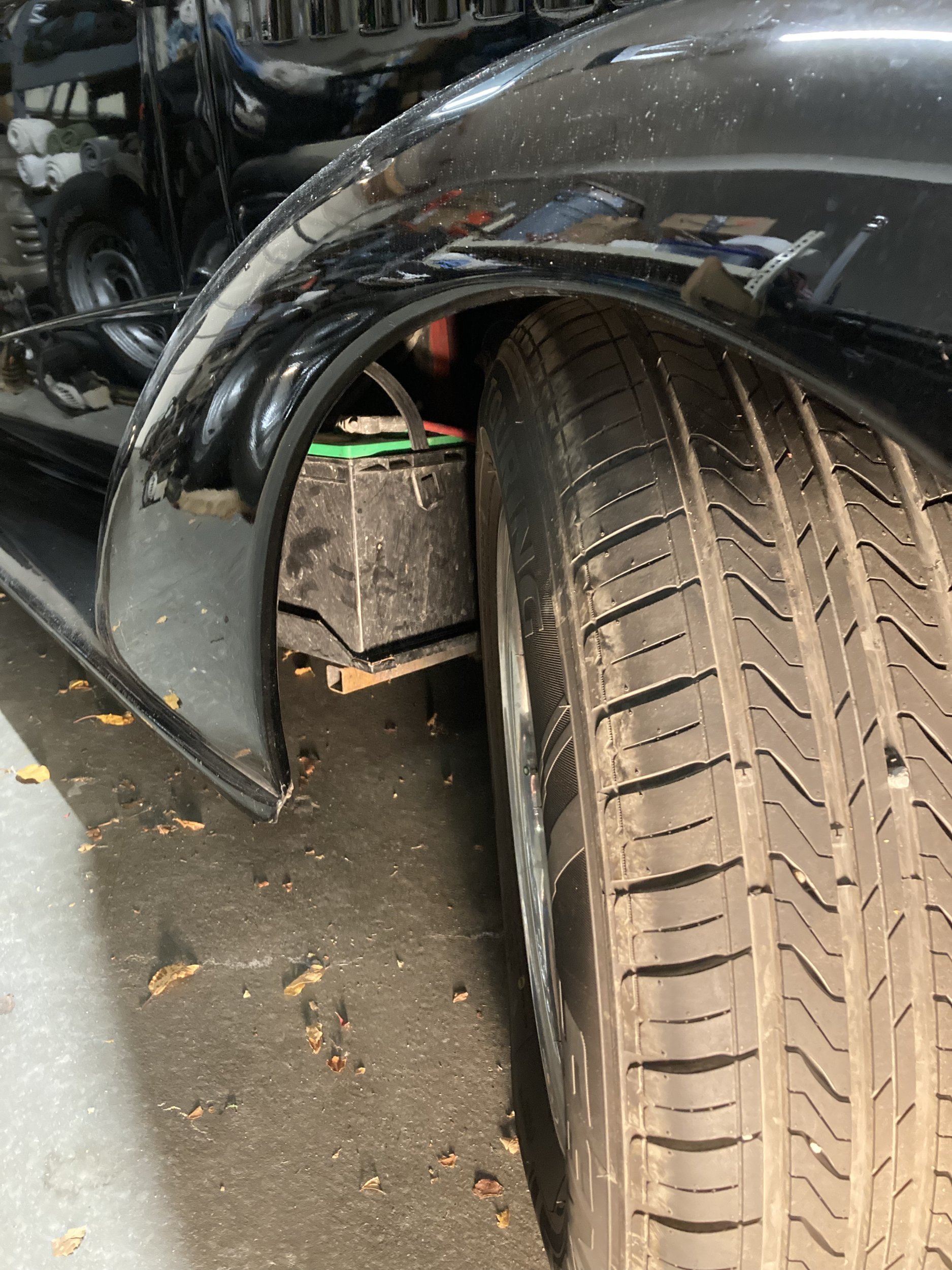

  13. 03GMCSonoma
    Joined: Jan 15, 2011
    Posts: 317
    03GMCSonoma
    Here is a picture of my avatar '38 Chevy Master Coupe battery located in the p***enger side wheel well. The mounting bracked is attached to the frame. It is a ***** to hook up a battery charger but it works. When the wheels are straight, you can't see it.
    dana barlow and Packrat like this.

  15. 36 Tourer
    Joined: Jul 31, 2015
    Posts: 28
    36 Tourer
    Love it , I have built three family hot rods with battery exactly like yours under the front mudguard had no issues first one was a 38 Chev second a 36 Chev tourer third and current is a 46 Ford delivery , if you need to change the battery just jack it up and take the front wheel off .
    03GMCSonoma likes this.

  19. 03GMCSonoma
    Posts: 317
    03GMCSonoma
    Thank you.
