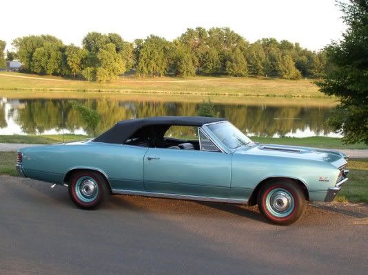

  30. DenverDave
    Joined: Nov 8, 2007
    Posts: 563
    DenverDave
    from Denver, CO
    I have one of those 350 hp BB's in my 67 Chevelle SS396. I promise you it's not a slug. Of course to find out how it would really do I'd need to get rid of those old red line bias plys. Rowing the gears on the Muncie is probably one of the things every hot rodder needs to experience. My decision on a numbers matching restoration didn't include making the internals quite like they came from the factory..if you get my drift.
