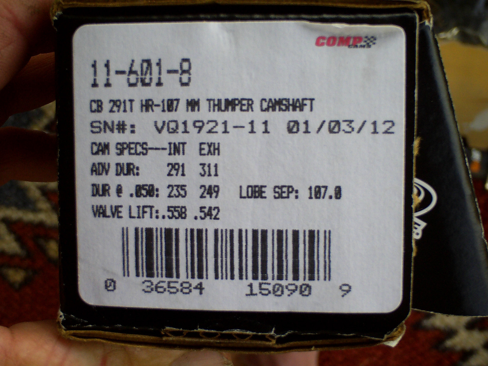

    I also got another screaming deal on a complete COMP CAMS Mutha Thumper ROLLLER cam kit cam #11-601-8
    I also plan on running a tunnel ram on this motor as well.
    This will be in a 2800lb sedan.
    Comp cams says the cam works best with 9:1 compression...I'm pretty sure this motor was 7.8 or 8.1:1 from the factory. By using the closed chamber heads I'm sure compression will go up a tad...Think this combo will work decent?? Just in a Saturday night cruiser. Thanks!

    I think the Comp Thumpr cam you chose is too much, unless you change the pistons to higher CR. Even then I'm not sure I'd want that cam with the duration it has. I'd prefer something shorter duration on both intake and exhaust. I think if you're stuck on the Thumpr, the 11-600-8 is a better choice. I'll probably go flat tappet on mine, and do something around 288/288, with .530" lift, and 110 LSA. The closer 107 LSA will make your Thumpr's lopey idle, but wont do much to make good lowend power for a mostly street application.

    I think you will have a fun motor. But ain't gona have no bottom with that cam and intake. A fender banger for sure....

    You will need probably a -21cc dome to get compression up to 10-1 assuming you are not going to deck the block.The 300cc ovals on those heads will get you decent low end power but not with that cam.1971BBC427 is about spot on with cam specs it will pull like hell from idle and you will be a lot happier.
