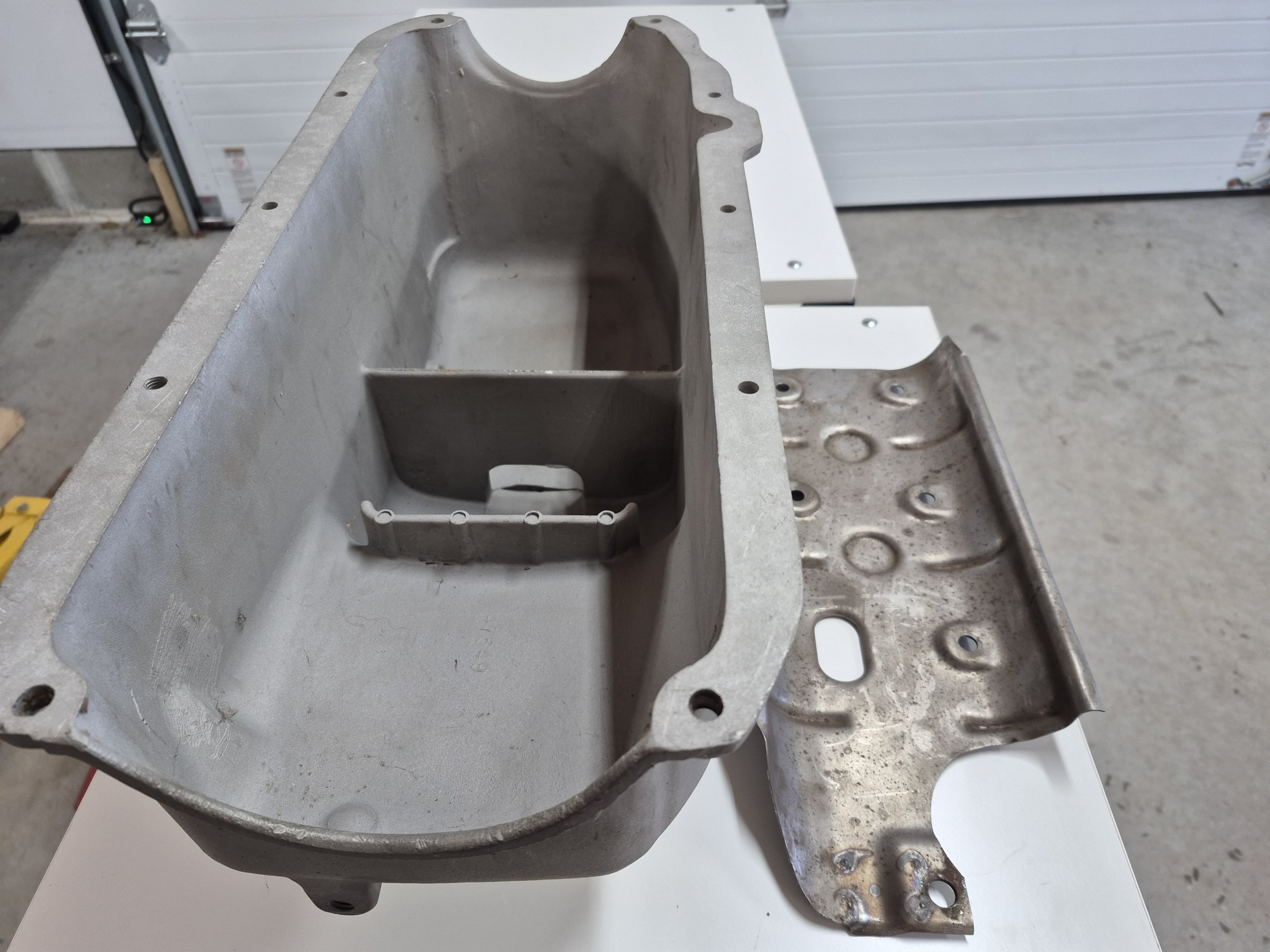

  11. Jmountainjr
    Joined: Dec 29, 2006
    Posts: 1,824
    Jmountainjr
    Mercury marine cast pan showing internal cast baffles and conventional windage tray.
