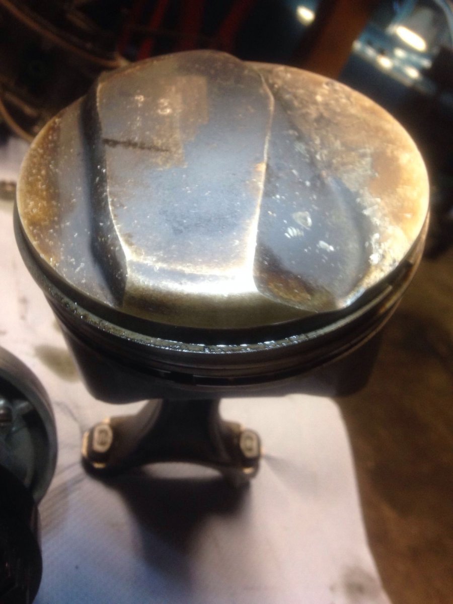

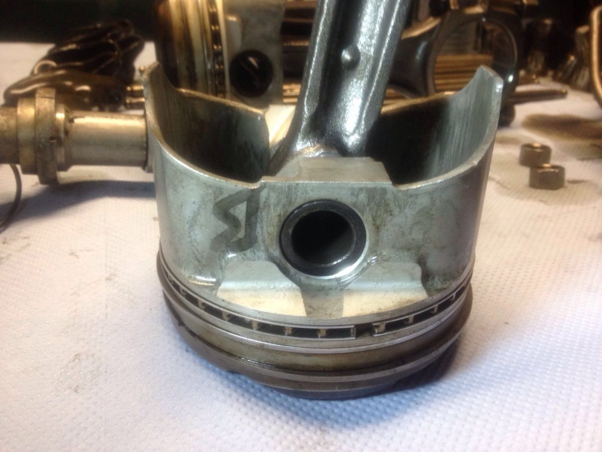

    Hey guys, I need your advice. A friend just called me and asked what I would do if I had a binding wrist pin .He also sent me some pics I´ll attach below.
    His LS6 BB in his 66 Bel Air swallowed a little carb bolt, so my buddy pulled the engine to see what caused the noise and found the rest of the bolt in one of the cylinders.
    Now checking for further damage,he found that the piston that munched the bolt has a binding wrist pin where the other are perfectly smooth. He has to use both hands to move both hands and wedge the rod against the bench to move the pin. He used a heat gun to warm the piston to about 180°F and it moves a lot easier when it is warm, but still not as easy as the others.
    Here are some pics, you can see the mark were the piston was wedged against the cyl wall.
    Should he get a new piston ( if availible), or should he try and remove it from the rod and ream or poilsh the wrist pin bore? The piston is looking good otherwise, it is not cracked or damaged other than the bolt imprints on top.

    I'd put a new piston in, if possible. I had one like that bite me years ago....

    My first task would be to have the rod checked for being slightly bent/twisted when it tried to compress the bolt......something had to give besides just denting piston and smashing bolt. Also, is the wrist pin actually bent/distorted ?

    Fwiw, I agree with Jim, I think the pin bore is probably distorted. I have had some experience in this area, and a tight pin is definately bad news, and has to be dealt with. I have seen the pin bore distort due to the heat to the point where the spiro-loc came out and the pin damaged the cylinder wall to the point where the block needed a sleeve. I realize this has press-fit pins, but IMO this has gotta be fixed.
    And I agree with carefully inspecting the rod before it is re-used as well.

    Whether you find a piston or not you will need to take it to an automotive machine shop and have them refit the pin and check the rod. The rod needs to be heated a little to remove or install the pin. If it has been tight on the pin for a while, the skirt might be too small but they can be knurled.

    I'm betting the bind was caused when the pin was pressed in
    If any damage to the piston crown is causing binding the rings would also bind.
    Check for cracks and rod straightness. If Ok then hone out the wrist pin bore
    That piston looks reusable

    The aluminum piston is the weakest or softest link in the system so it usually absorbs the most damage. It looks like the rings might be sticking in the photos but carbon can cause that too. The ring groove can be cleaned up with a small file. I've seen brand new pistons with tight grooves. The main things to check for are piston cracks and rod straightness. A lot depends on what you plan to use the engine for. Engines are built differently for different applications.

    So, rod is bent. Searchin for parts now.
