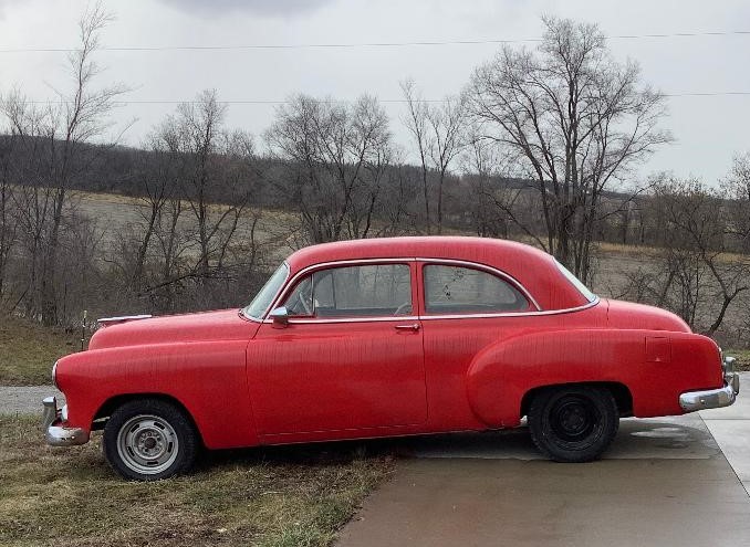

    My 51 Styleline deluxe is slotted to receive a BBC. Started this thread yesterday, but apparently tagged it wrong, mentioned the wrong part on the build or some such thing and it was deleted. I'm looking for do's and don'ts on putting the 505 cu in Gen IV BBC into my coupe. It will have a 700R4 and a 68 Camaro 10 bolt rear. Disk brakes and the master relocated to the fire wall. Yesterday before it was deleted it was mentioned that I'd need to shave the firewall stiffeners and possibly modify the trans tunnel. Headers are a concern of mine as I have no idea what fits in this type car and don't want to alter the classic lines of the car with inner fender deletes or the such. The ultimate goal is to have a car that looks like I remember them in the 60's with an up to date drivetrain so it can be driven. This year it's get it mechanically sorted and then test and drive. Next year, I'll start on the body work and make it more eye catching and adjust any squawks that show up during test and drive.

    by the look of the picture above that you put an open drive rear axle on the stock leaf springs and did not redrill the spring pads for the offset in the center pins that these cars have. I think it is 1.5 inches. see how far forward the wheels are in the rear wheel openings??

    Looks like the front suspension is not centered in the wheel well either. I think I would want all that correct before throwing a big horsepower engine in it.

    The perspective of that picture is really wonky, it was taken with a very wide angle lens, from close up. So I don't trust what I see in it.

    That doesn't look like the coupe either.

    I bought the car as you see it in the picture. It is still original drive train in the picture. 6 cyl, cast iron power glide and all. It does have 15 inch wheels on it, so someone did something with it. I'll crawl under it and see if the driveshaft is open or closed. My rear suspension parts less differential are in the trunk sitting in front of my shop. Trying to move stuff around to make room to start working on it. I hate the thought of moving one of the boats out to put the car in, but it's winter here in Central Iowa and working outside isn't a good option.

    51coupe.jpg [​IMG] Yep, it isn't a coupe. It's a Styline 2 door sedan. The coupe roof is smaller and the catwalk is larger. The rear windows would not be that large and would most likely be a sliding window. As for headers, Sanderson makes a block hugger header for the V8 Chevy engine in the 50s Chevy.
