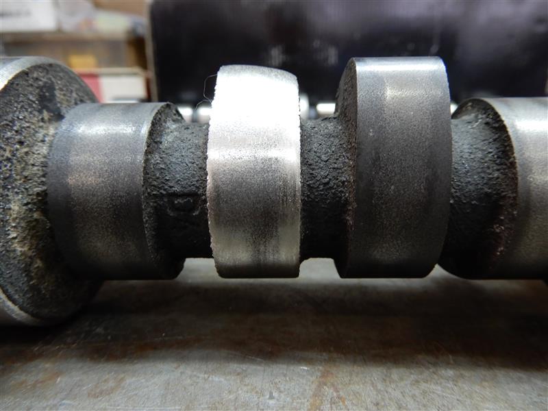

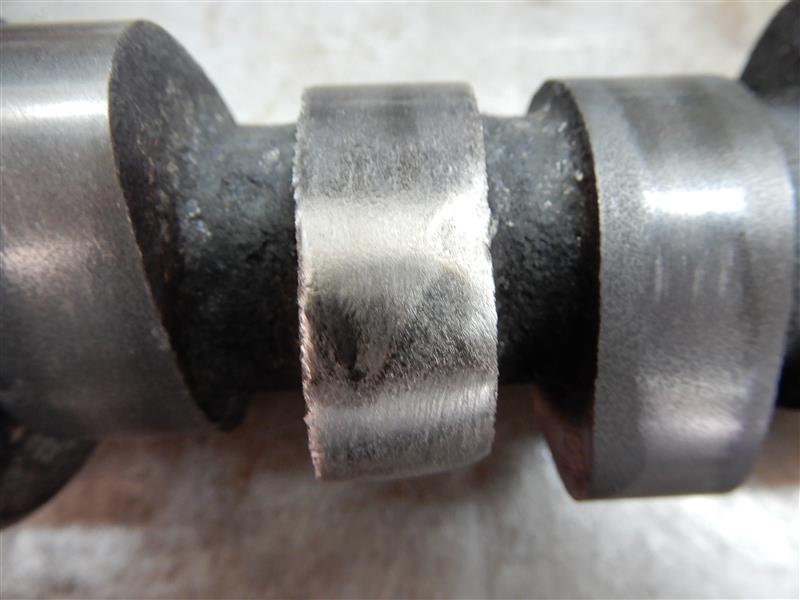

    Sounds like someone needs to pay more attention when installing a new cam and lifters. Lippy
  2. birdman1
    Joined: Dec 6, 2012
    Posts: 1,681
    birdman1
    I had a similar experience with a melling cam last spring. No guarantee. Said I let the engine run too long on the break in oil. So I bought a Howard's cam, did exactly what they said to break it in. Works fine. Guess what, broke it in just like the first one. This time it worked.
  3. David Gersic
    Joined: Feb 15, 2015
    Posts: 2,811
    David Gersic
    from DeKalb, IL
    Wow.
    Did you, by any chance, check the lifters before installing? I watched a video a couple nights back with a guy that got two flat (no crown) lifters in a “new” box.
    One more thing to look out for. Can’t trust even new parts.
  4. Rocky
    Posts: 17,614
    Rocky
    Classified Editor
    I had a Crane cam to the same thing in a 327. They stood behind it and sent me a new one. I got about 30 miles on it before the cheap-ass Rocket spin on filter adapter blew off at speed and I lost the motor.....but the cam was working ok.
  5. Kan Kustom
    Joined: Jul 20, 2009
    Posts: 2,744
    Kan Kustom
    These threads are my favorite kind. A collection of different experiences and outcomes. Keeps us all ahead of a long individual learning curve. Guys that share their problems instead of keeping them to themselves to avoid some loss of pride help all of us.
  6. sdluck
    Joined: Sep 19, 2006
    Posts: 3,332
    sdluck
    I know it is too late,but my old instructor Dema Elgin told me to install the cam and lifters and rotate the cam with a speed wrench and make sure the lifter rotate.My last 2 engines were roller because of cams going flat.

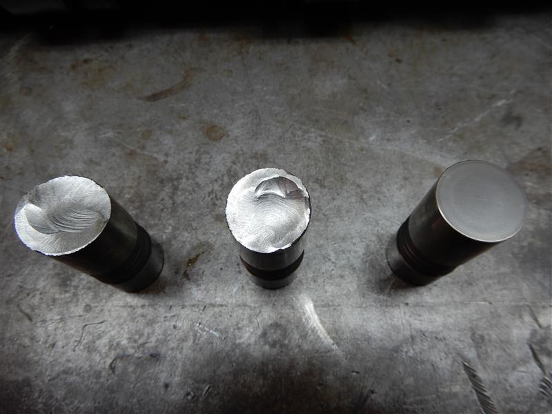

    Check the hardness on the diameter with in about .060 from the lobe end of the lifters, closer to the end the better. Should get a good idea of hardness. The divot left by the diamond can be stoned off as that area sticks out from the lifter bore, so won't affect anything.

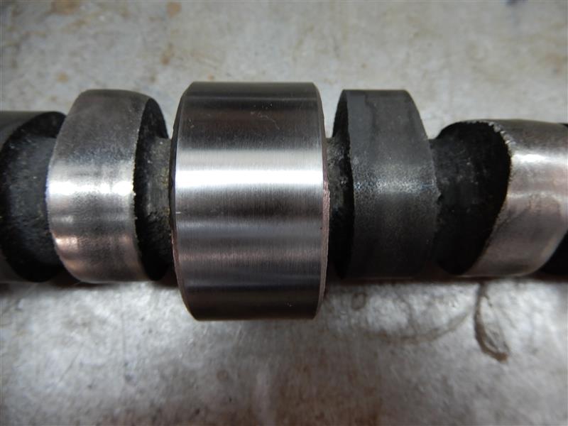

    Same here, just not a BBC but a 327. My uneducated guess was that one of the new lifter was just too soft. I damaged it´s hardened surface by pulling it out with pliers. The old GM lifters can´t be damaged with pliers and they have a lighter sound when you hit them with a wrench. These new ones sound pretty dull. If I were to bet money, I ´d say soft lifters.

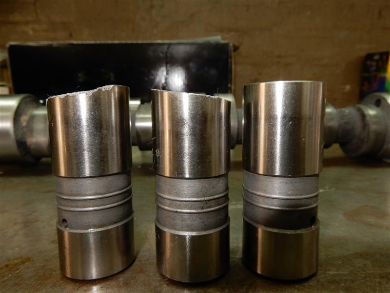

    Definitely agree that the lifters not rotating is the cause of failure. I have been told that too much camshaft break in lube getting on the lifters can inhibit lifter rotation. I have not heard that Brad Penn break in oil is junk. I recently used it; so far so good.

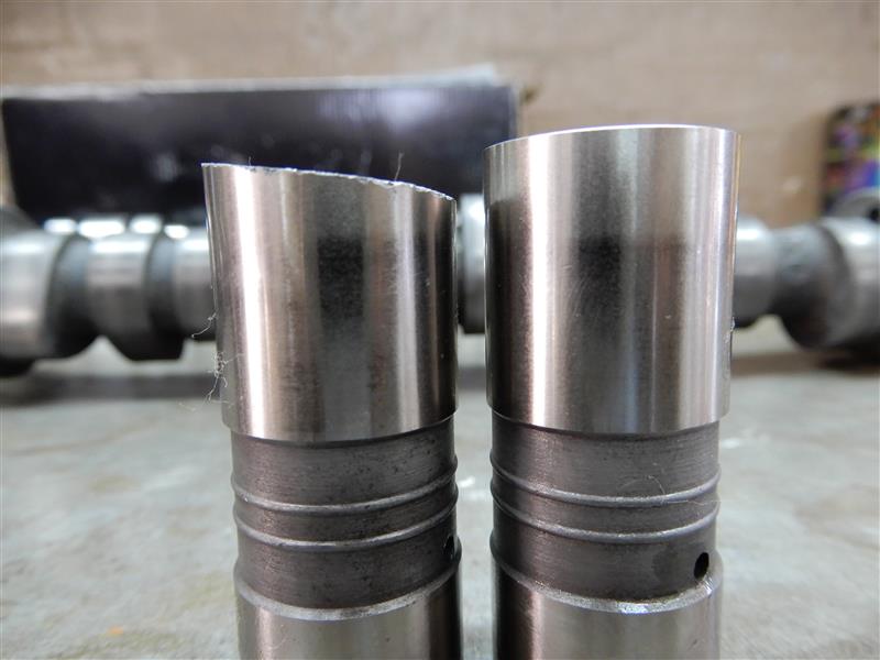

    The “beveled” crown on many replacement lifters are hit n miss , best to inspect them before hand. Nothing like a flat no beveled surface to Instantly eat a new cam lobe for lunch. As mentioned earlier go to uncle Tony’s mopar YouTube channel & he shows exactly the issue in my opinion. I tested a few sealed power , Melling & comp hyd flat tsppets out at work & found a few that failed the crown test with a sheet of paper as he demonstrated. Piss poor quality control in many big companies. Flux

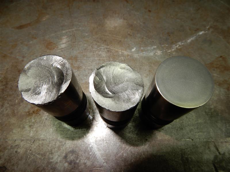

    Do you have the box the lifters came in? Look close for the fine print... MADE IN CHINA would be my guess!
    Order an extra box of lifters, use the BEST of the two sets - after checking for crown and rotation in the bores.
