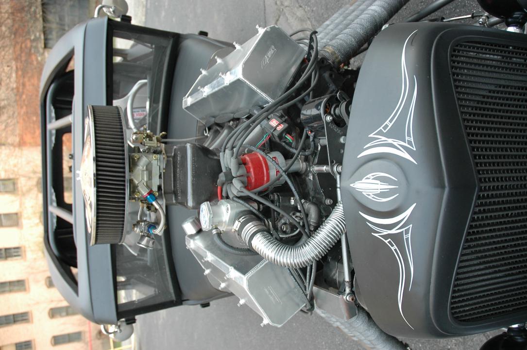

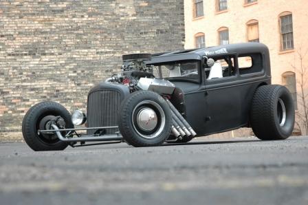

    Either way, Nimrod, Id like to see better pictures of the front of your hood sides. I can see your steering is on the outside of the car, hence no fenders, and it looks like the brakes are under the floor, so that solved that issue. But still, those valve covers gotta be touching the hood on the inside, and Id really like to see how you solved the exhaust manifolds too.

    I've lost most all of my pictures in a computer mishap. There's a pretty good setback to the engine and it's got less than 1/4 inch clearance pretty much everywhere, but it's in there. Exhaust is just homemade headers, and a couple of blisters in the hood sides to clear 'em.

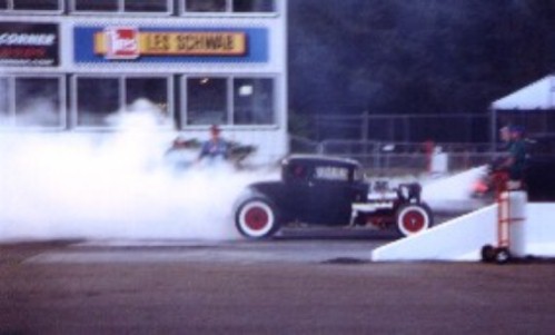

    holly **** thats the road rash coupe that k-member on the hamb here used to own...jeffrey

    Wow, no kidding, that's my old coupe, that was a fun car. Here's a few pics from the past..

    i saw it run a new england dragway..thing sounded mean with the crazy blower surge everyone was looking then it ran a 14 something spinning the tires the whole track trapping like 130

    Best I ever ran with it was 12.32 @109mph with a worn out late 70's truck motor with a single vac secondary Holley. Would have been cool to see it run with the supercharger.
