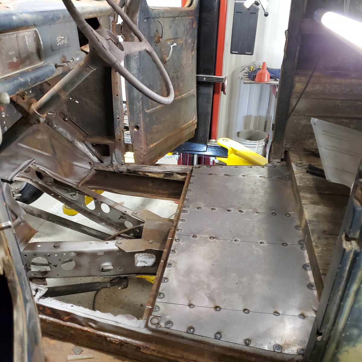

    Yesterday, I ran over to pick up some 18ga sheet to use for the replacement floor panel under the seat. The plan for today was to get the x member braces voted in with the proper bolts, pull the front end and install the Nostalgia Sid's axle, and hopefully have time to make plans for the floor.
    I was busy with the axle swap, and wasn't paying attention to what Mike was doing.
    He braced the substructure and cut the sheet and welded it in.
    This next weekend will be spent at the Chili Bowl Midget races, but the following weekend we will set the flathead and 4 speed, and work on the rest of the floor.
    Now to get the transmission apart to install the speedometer gear and get the flatty cleaned up. LOL

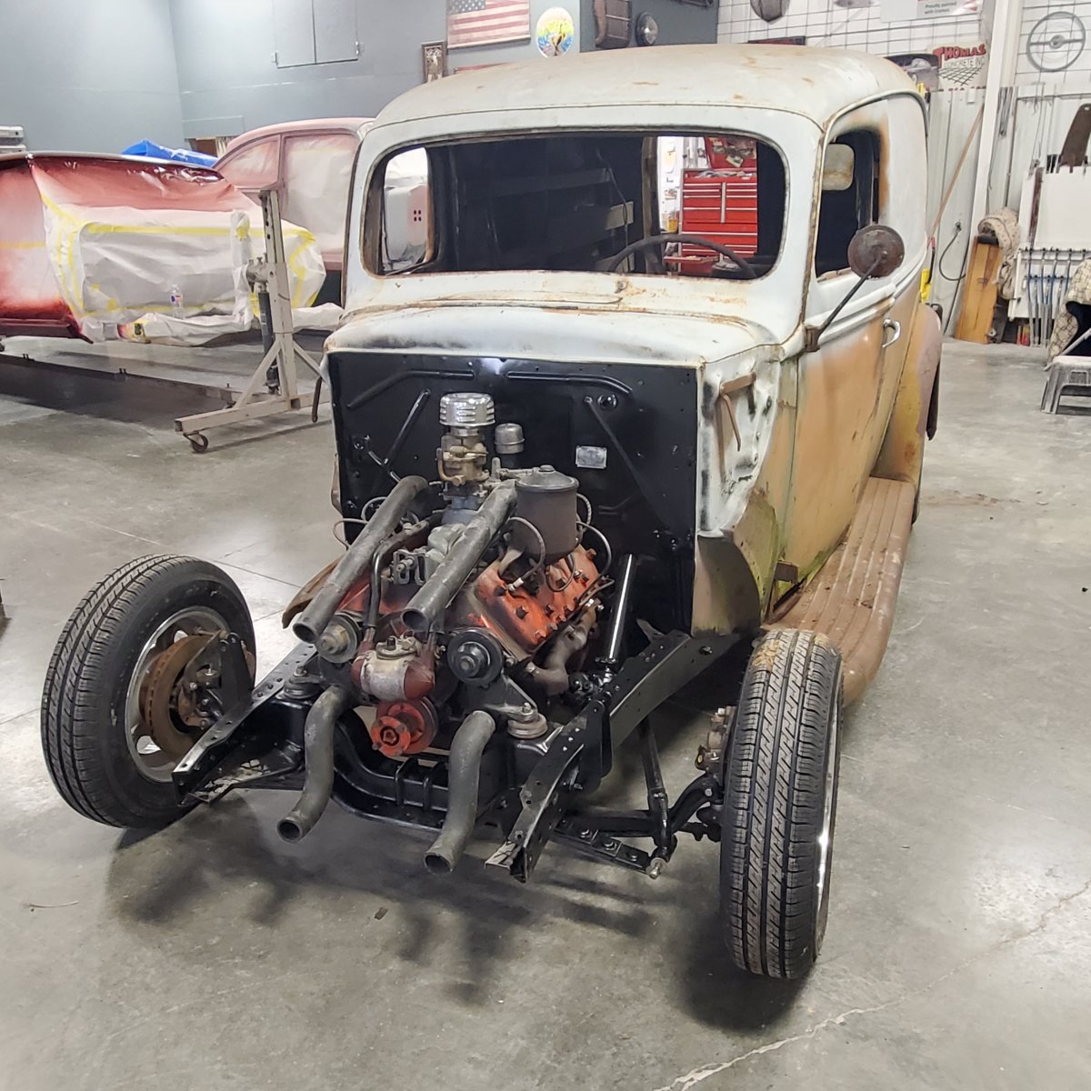

    I got a call, last Wednesday, asking if I had a spare driver's front '40 p***enger fender, so yesterday I picked it up from Doug's shop and brought it to Springfield. Mike said he wouldn't be to his shop, where we're working on the panel, until after 11am.
    I dropped by the guy's house who was wanting the fender, on the way out to Mike's, and one thing led to another and I wound up not leaving his place until about 11:30. When I got to Mike's, he already had the panel truck moved from the cattle barn over to the shop and had tacked the toe boards and lower firewall back together and was making a patch to fix about 5 holes that were in the firewall, apparently for a heater.
    After he got that knocked out, we pushed the panel outside and rattle canned the front frame rails and the firewall, so that we could set the flatty and the Saginaw 4 speed into the frame. One thing I learned from this is that it places the Saginaw's rear mount about an inch and a half further back from where a SBC/Saginaw would bolt in. With any luck, I am hoping to find the driveshaft that I had shortened when I did the initial 3 speed swap into my coupe, as I think it should be a direct fit.
    We did have to notch the X member a bit to allow room for the shifter. With the Hurst shifter mounting kit that came with the transmission, it places it on the rear of where the stock transmission tunnel bolts to the floor (sorry...didn't take photos of that when we were test fitting the floor panel.)
    Anyway...with the engine and transmission in, we were able to measure for the driveshaft, if the one I have doesn't fit. It isn't quite as low in the front as I would normally like a '40 to be, due to having a '41 6 cylinder style front crossmember, but it still does have some rake. I was slightly concerned that it would sit level or a little more nose high.
    I initially intended to paint the firewall Almond color, with some Rustoleum appliance epoxy, but decided that as much blow by that comes from the oil cap that black would be a better choice. LOL
    Next on the agenda is plumbing the brake lines and finishing up the floors.

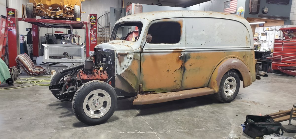

    This afternoon, I swung by Doug's shop and found the old driveshaft out of my coupe that I had shortened for the first round with the 3 speed and series of SBC/early Ford/early Ford/Chevy manual transmission adapters. When we put that setup in the coupe, we made a transmission mount adapter to bolt the transmission to, then bolted it to the holes in the split wishbone mount. That same adapter is being used with the Saginaw behind the flathead, so the only variable should be the placement of the rear end on the rear springs. (when we pulled the adapter setup out of the coupe, and used a Chevy bellhousing, everything lined up where it was supposed to and I had to get a new driveshaft for it the same length as I had before shortening this one!)
    Dan Hay likes this.
  28. Dan Hay
    Joined: Mar 16, 2007
    Posts: 6,464
    Dan Hay
    I know this sounds like hackery, but I think it would work fine... If the front ends up too high for your liking, you could cut out the top of the flat part of the CM where the spring rests against it, and "raise it up" so to speak with a piece of square tubing with the bottom cut out, weld in to your desired drop. Looks like there's a country mile between the CM and the pan so clearance should not be an issue.
    I hope that made sense, it's hard to describe what I'm seeing in my head sometimes.

    Yeah we shortened the driveshaft on Colby's 58 when the axle was flipped. Took 2" out of it. Had to flip the axle back and the guy at the driveshaft shop is looking at us crossways. "Didn't I just take 2" out of this last week?" Yeah, you still have it?
    Dan Hay likes this.

    Yeah, I have considered that, and it isn't totally out of the question, but I think it will be fine. The old truck is gonna be a driver, and I bang the grille on the coupe enough to make up for what I don't in the stake truck and the panel combined. LOL
    Dan Hay and Tim like this.
