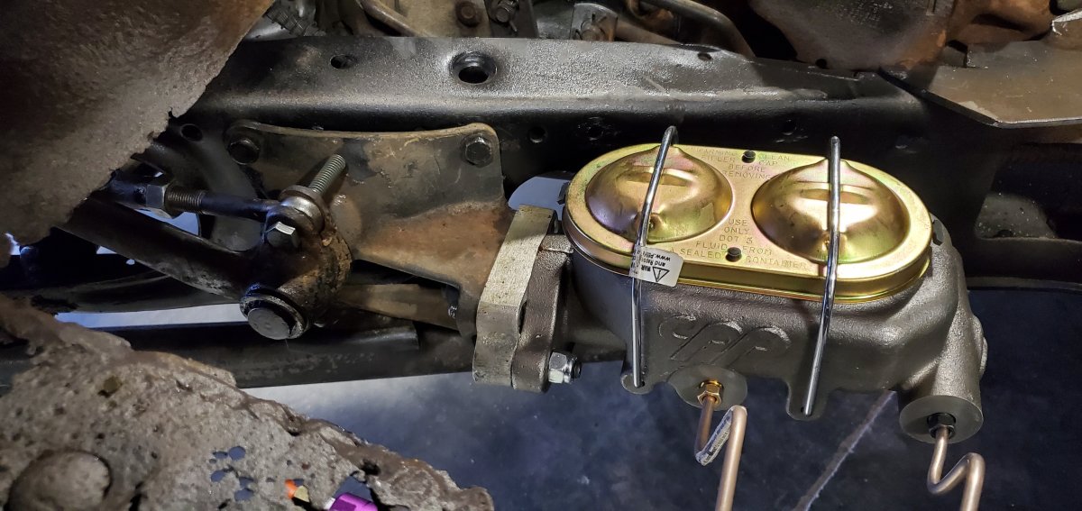

    Only one photo from this weekend's work. Brake lines are plumbed from the rear up to the master cylinder and from the master cylinder to the front 2lb residual valve. Unfortunately, the Fair Grove, MO O'Reilly store didn't have the necessary T fittings to add the brake light switch and to connect both front brake lines.

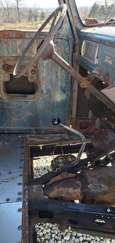

    Swapping out the shifter should be a fun experience, due to the fact that the clearance in the frame is pretty limited. While I have the shifter off, I am going to go ahead and remove a little more off of the frame lip to allow room for a wrench to fit in there to remove the lower mounting bolt. To get it out, we will have to remove the transmission mount bolts from the crossmember and either raise it or wedge it over about 1/4".

    Is that master cylinder for an AMC? After I had plumbed the Mustang MC in my 40 and snaked the lines around the other side I found out there was a MC available with the ports on the other side.

    It came with the brake/clutch pedal kit from Pete & Jake's that I wound up not using. It is a Corvette style. It is a little longer than the Cordone 1907 that I normally use and interfered with the floorboard of the coupe, but the truck bodies sit on wood blocks so I had room to use "spare parts". The routing is nice with the ports on this side. Just had to remember to allow room for the exhaust.

    Dan I’ve come across quite a few of the corvette style masters that are set up to run lines from either or both sides.

    That trifive shifter is just too cool in that truck. I'm loving it !

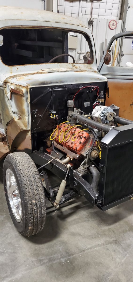

    Finally made it out to Mike's to work on the panel truck with plans to wire the engine bay and work on the front floorboard. We also installed the radiator and hoses today.
    The yellow ignition wires were the ones that I ran on my coupe from 1995-2002, when I swapped the 283 out for a 350. I used them "temporarily" on the stake truck when I was running a '42 crab style distributor, which I will be running on the panel truck. I'll run them until I take the time to put some appropriate length black wires on it.
    I had intended to use a later style coil mount, along with a GM 6 cyl coil mount, but quickly realized that I didn't have enough room. After a little discussion, Mike suggested I take a peek at some of his parts car stash, and I snagged this one off of an early 60's Ford truck. It's mounted to the firewall using one of the emergency brake handle mounting bolts. I need to make a long coil wire to reach to the front mounted distributor.

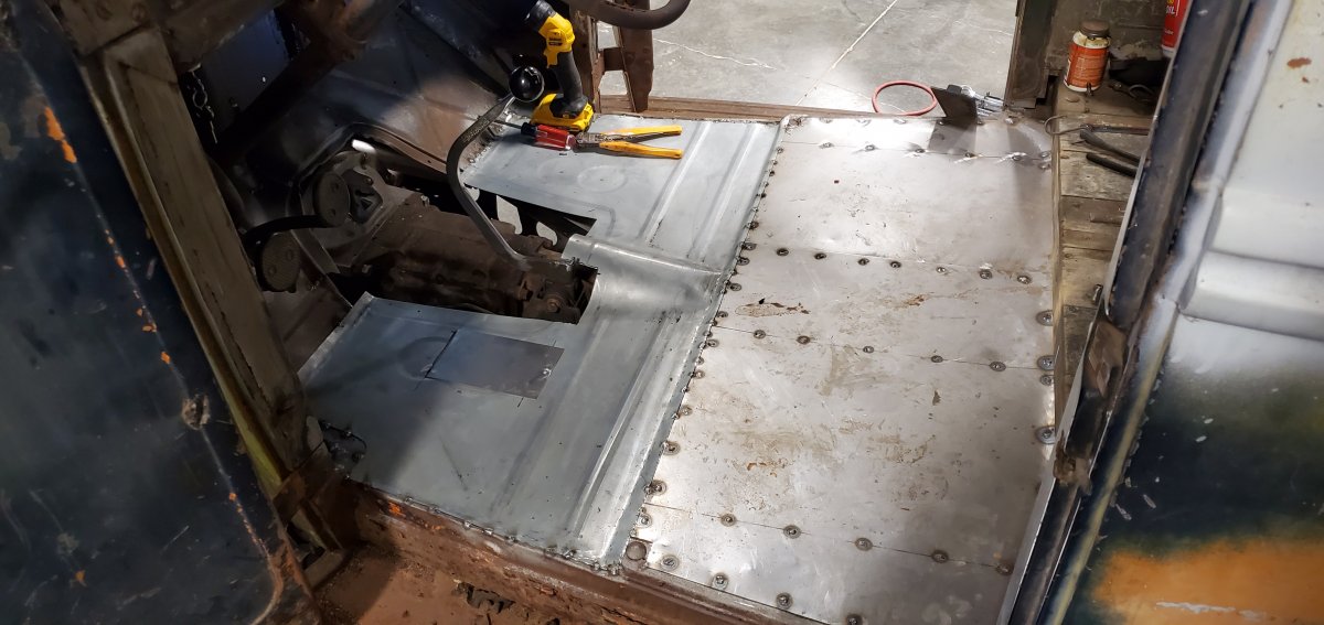

    I bought the front floorboard section from a vendor on E-Bay for less than it costs for either side of the floorboard. It was supposedly for a '42-47 cab, but we went with it anyway, since the truck is a beater. Mike got it tacked in today, and made a door for master cylinder access. We'll use some seam sealer around the floor and paint it before I use some peel and seal to help kill some road noise and insulate the floors.
