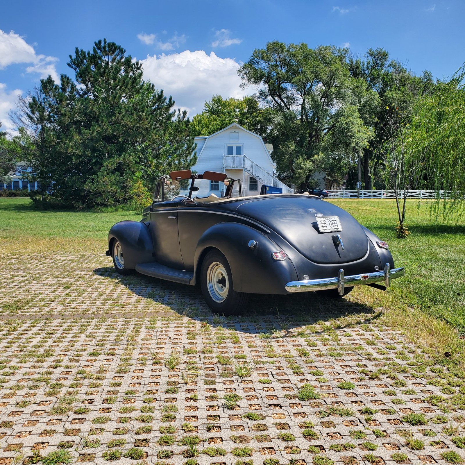

    Spent a little time rolling around on the garage floor this afternoon after church. Got the new Posies reversed eye spring and regular length shackles installed. I did make sure to swap the top two leaves to below the spring, to help it sit better once the spring settles.
    Currently sits a hair lower out back, but the change in driving characteristics is night and day with losing the long shackles!

    Looks much better! Well, other than the exhaust hanger. :rolleyes:
