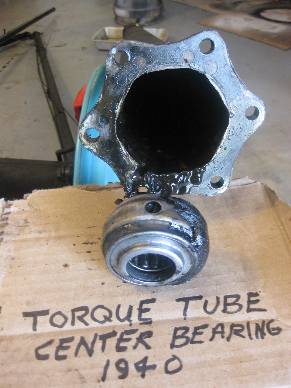

    Keep in mind that with a "raked" stance the gear oil, from your differential will drain out and run down the interior of you torque tube and eventually dissolve the rubber encasing the torque tube center bearing. There is a replacement bearing available from Skip Haney on Fordbarn. Plus, I recall seeing a thread where a fellow in FL actually recast the rubber around the OEM bearing so it can be reused. OEM Ford center bearings are no longer available and are very expensive and rare. You can tell the bearings "bad" when you feel and hear the solid driveshaft vibrate as it whips inside the torque tube.

    @hotrodpro Danny Burroughs at Bruce’s Hot Rods makes a torque tube seal to keep the gear oil in the diff. I used on of those on mine and then greased the center bearing at the zert and hoped for the best. I think it’s still going strong as far as I know.

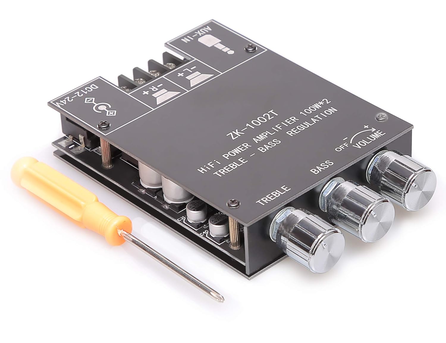

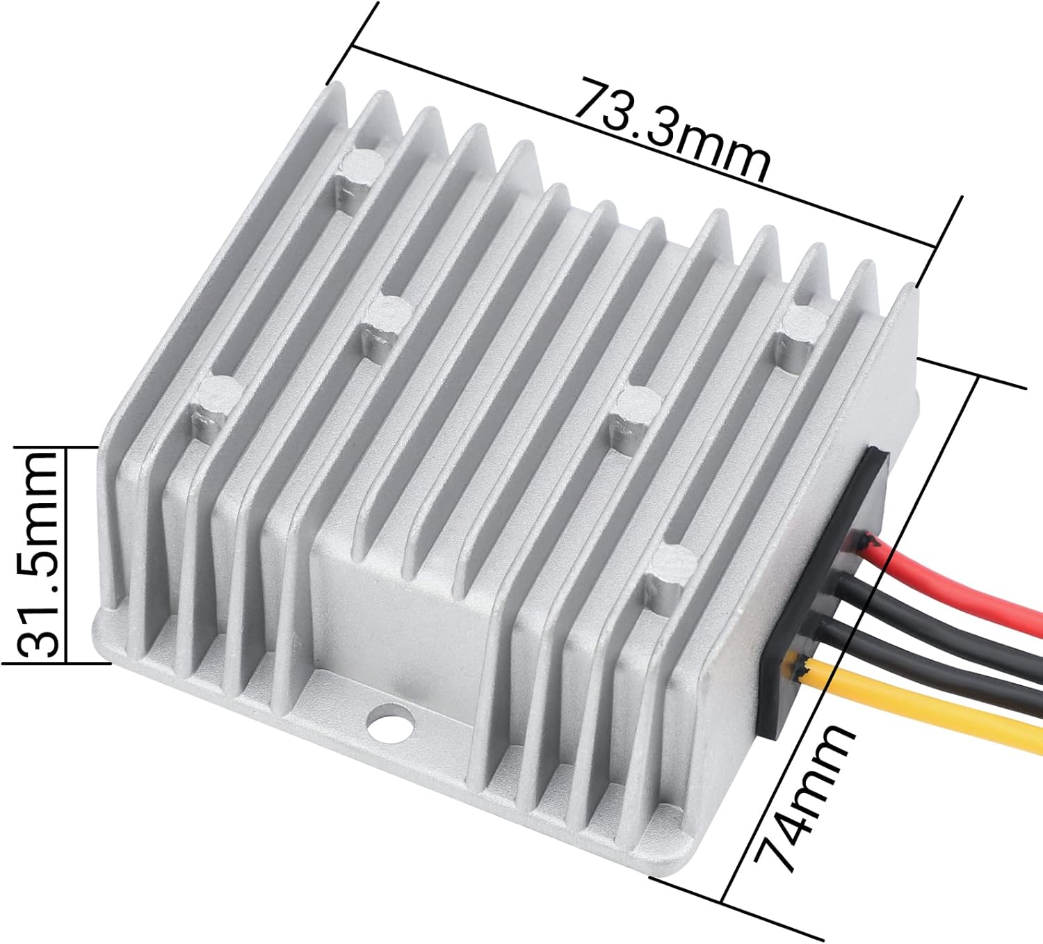

    Road tripping in a '40 convertible with 6v electrical is going to be a new experience. When I got the stake truck on the road, I rewired it all 12v with a Chevy internally regulated alternator, just to make "power" related failures a fairly easy roadside fix. I haven't thought through that process yet, with the convertible, but one of my other concerns is that I have an older cell phone that doesn't hold charge very well, and I will need to somehow be able to charge it.
    I also remember that when I rewired the stake truck, my Uncle Bob had an AM radio out of a late model hung under the dash and used a 6v to 12v power inverter to power it. I searched high and low in the garage trying to find it, since my pack rat nature tends to never throw stuff away. Unfortunately, I had no success finding it, so I resorted to Amazon, where I bought one of these.
    https://www.amazon.com/DROK-Converter-Waterproof-Stabilizer-Automotive/dp/B0BQJ4G77B
    as well as one of these:
    https://www.amazon.com/dp/B0B1V92QBR?th=1
    And since I was blowing money like a sailor on leave, I went ahead and grabbed one of these for future use.
    https://www.amazon.com/dp/B08R3Y5WXH?th=1
    Just trying to figure out where I can hide that power inverter and fuse box, but as long as I run my power and grounds from the 12v items to the fuse box/bus bar combo, I should be able to wire up an accessory outlet to plug a USB cord into to charge the phone. The bluetooth amp will be saved for a later date when I can figure out how to mount a 5x7 dual channel speaker behind the speaker grille, so it remains out of sight.

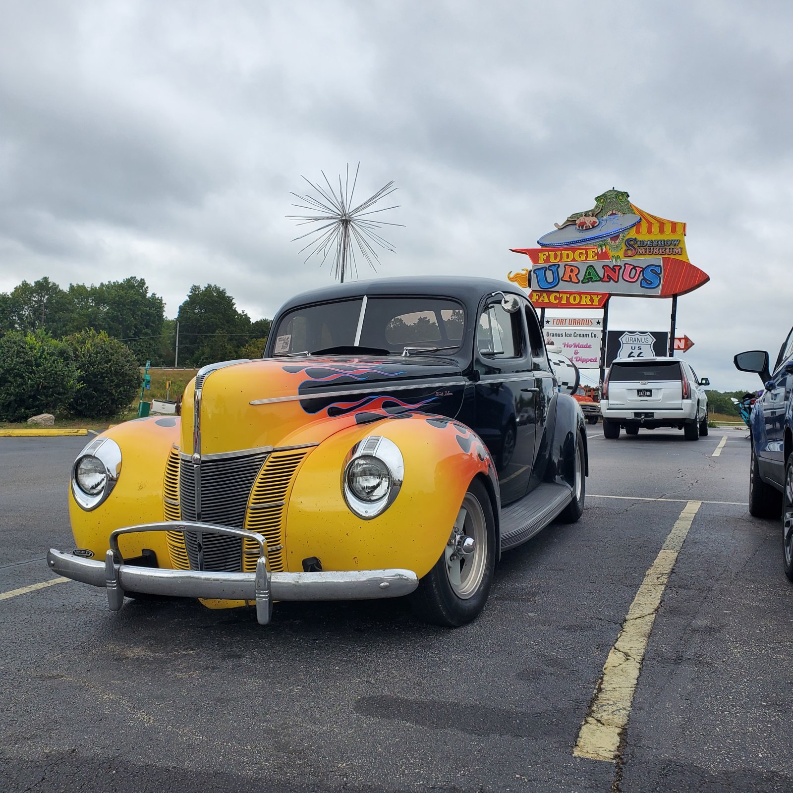

    Headed out to the St Louis Hot Rod Hundred, keeping a close eye on the oil pressure gauge. Had some sprinkles from the remnants of Hurricane Francine, but things seemed to be going great.
    Then I lost all oil pressure but at least made it to Redmon's Candy Factory, 50ish miles from home. I finally put the top up for the very first time.
    Got a ride on a rollback over to Mike Meeker's shop, threw all my **** into the coupe, and got back on the road.
    It's not a trip to St Louis unless you make a stop to inspect Ur****.
    Got to Washington, MO and had to make a stop for dinner. If you've byp***ed Lion's Choice on your way through the StL area, you're missing out on some great roast beef sandwiches.
