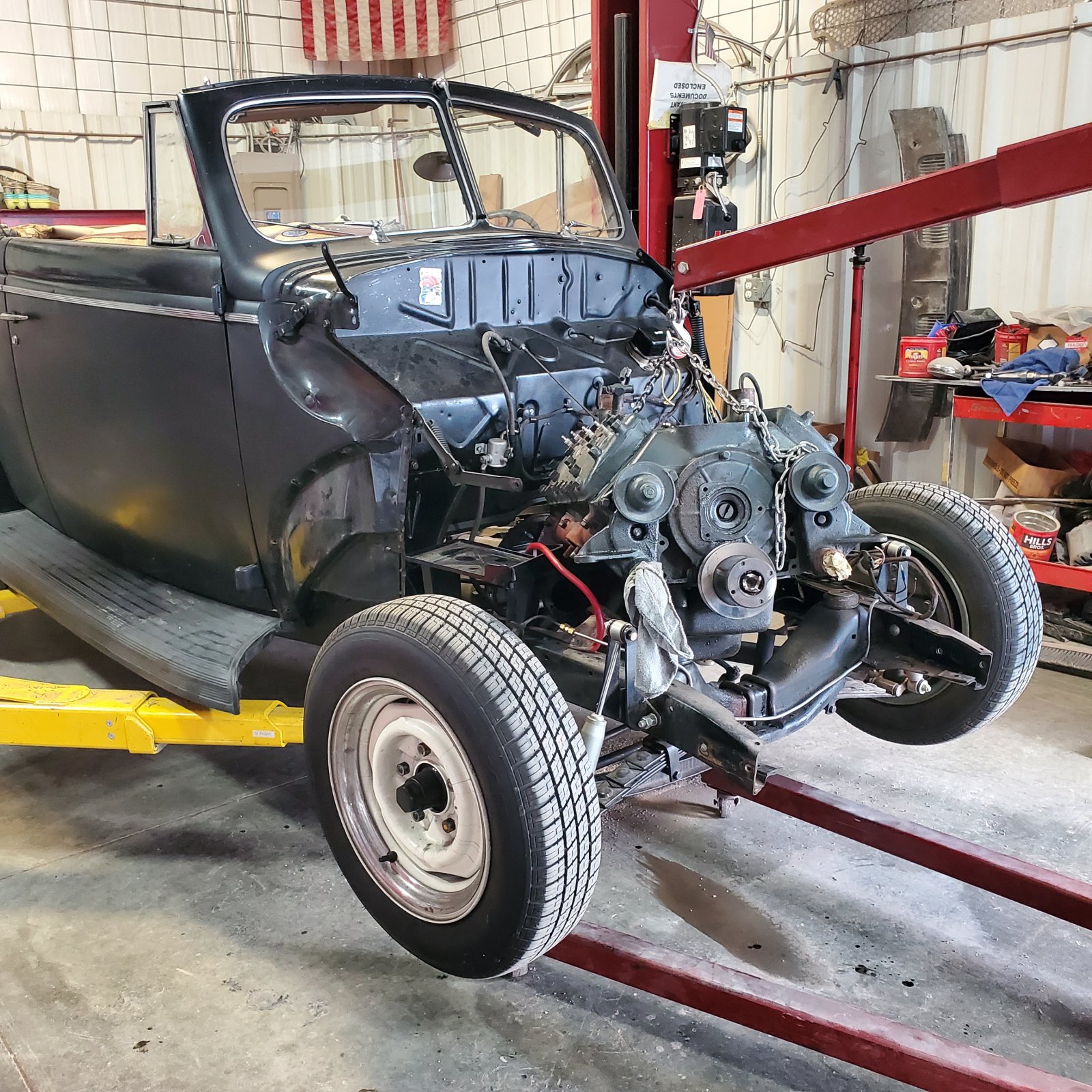

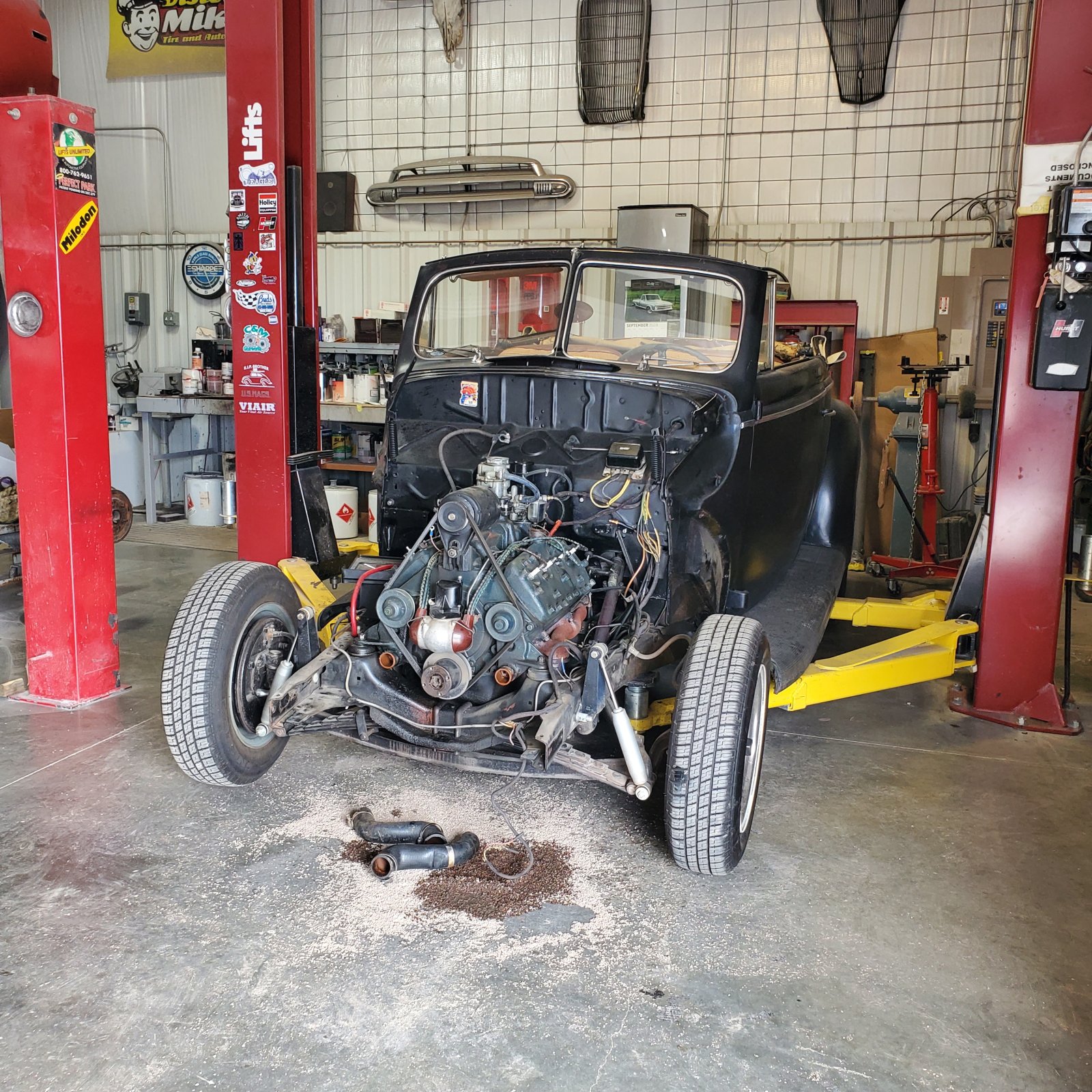

    Mike and I didn't get started on the car until around 1:30 this afternoon. Got the front sheet metal off and got the old motor pulled out.
    The new motor will be going in tomorrow evening after work. Hopefully we can get everything buttoned up by Tuesday.

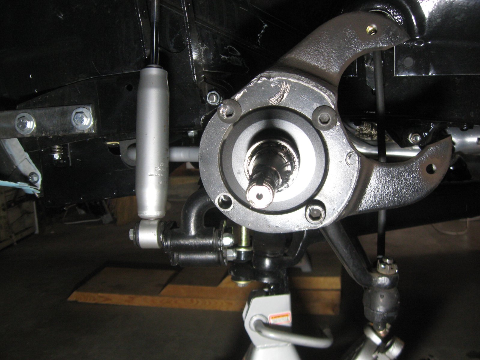

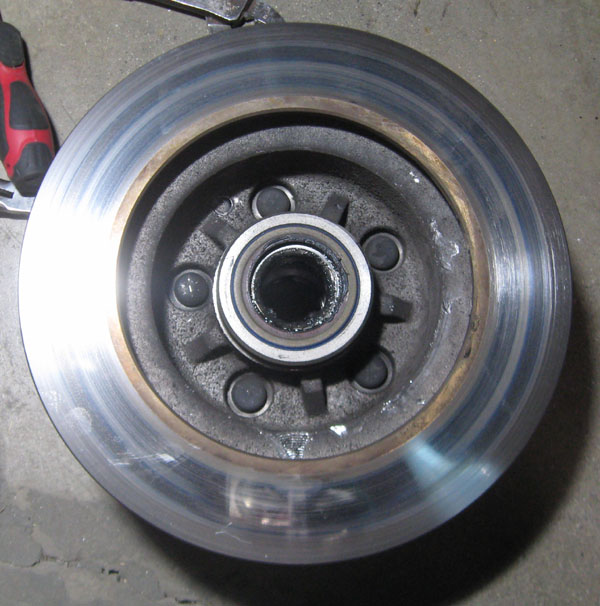

    I had a problem with my bolt on steering arms coming loose not too long after completing my 40.
    The bolt came out while traveling at 60 miles an hour. You can see it's thread imprint at the bottom of this rotor. It stuck there started machining itself down. I was fortunate that I didn't wreck the car and kill some other people that were sharing the road with me at the time.
    I reinstalled the bolts with copious amounts of thread locker and added safety wires to be certain they would not come out again.

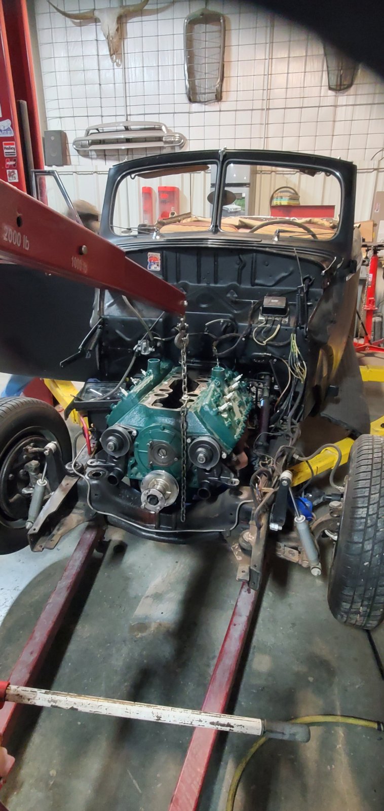

    Got the flywheels swapped and was able to set the flathead in. Hopefully I can sneak out early tomorrow and get it together enough to fire it up. Won't be ready for the MidWest Forty Ford Gathering event this weekend, but should be good to go for The Gathering at the Roc.

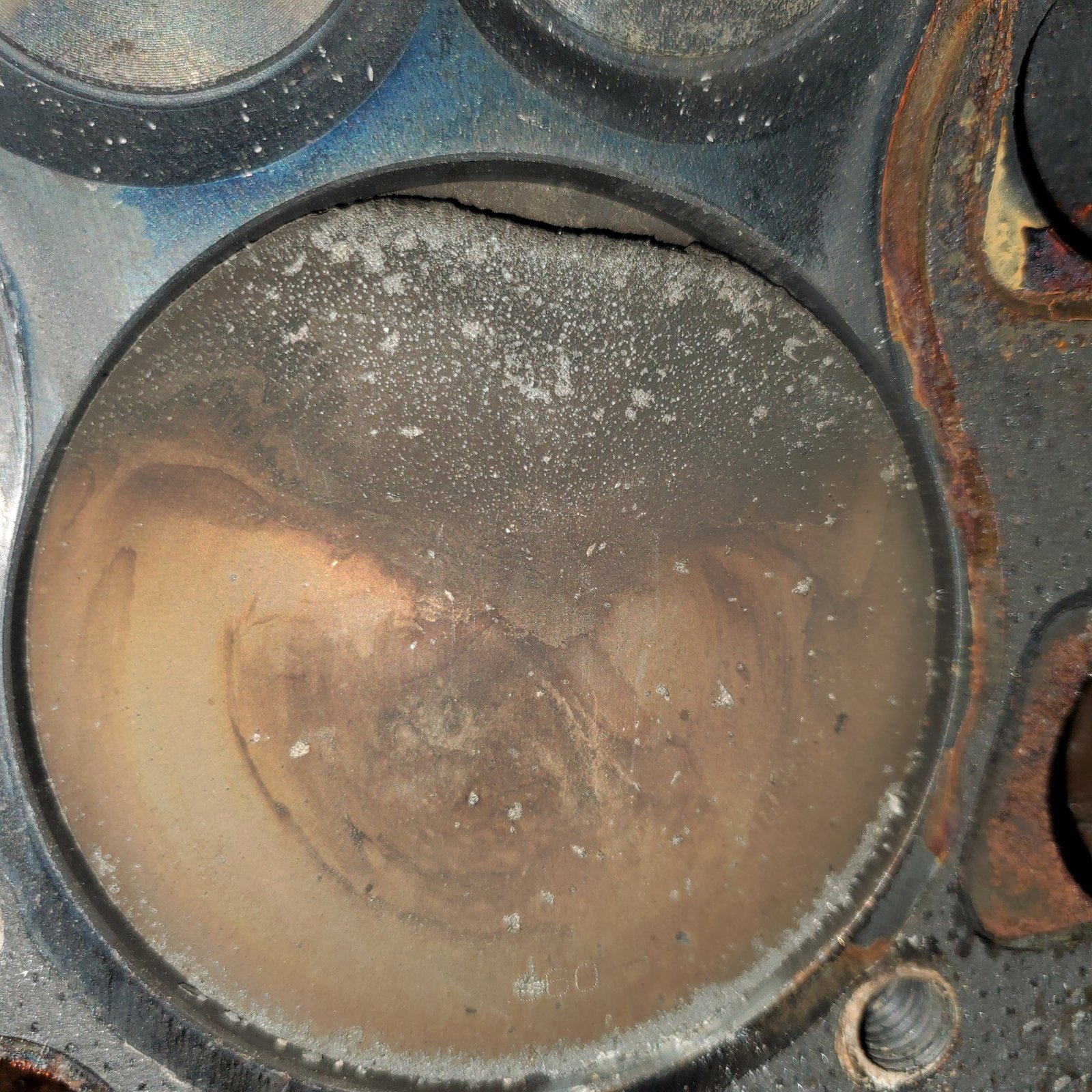

    We made it into Springfield when things went "pear shaped", as my buddy Wayne would say.
    Apparently the driver's side water pump wasn't doing it's job and I smoked the #6 piston, and wound up riding home on the back of a rollback.
    After a week, I finally drained the oil to see how much carnage was evident in the oil. Surprisingly, I think the lower end is good.
    Current plan is to wait until I'm in "vacation days buring mode" in November, have Meeker come down and load the convertible up on his trailer, and have a week of yanking the flatty and putting new pistons and rings in it, putting another water pump on the driver's side, wire up my gauges to work, add some manual temp gauges, then putting it back in and following MUCH more careful procedures once I get it running again.
