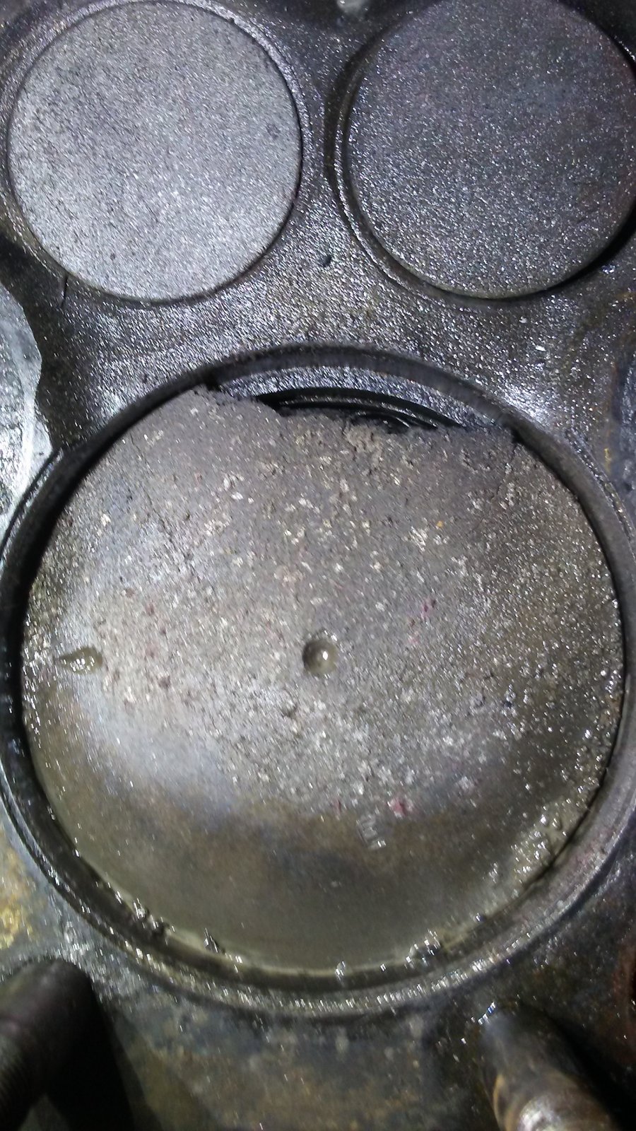

    I will see your piston
    And raise you mine
    And the culprit two holes down. See the crack

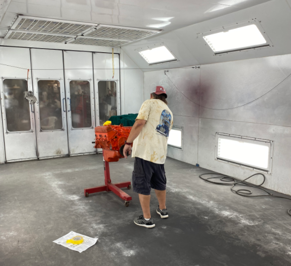

    A few weeks ago, we rolled the 283 into Meeker's paint booth for a rattle can rebuild. I also attempted to get some broken studs out of a set of log style exhaust manifolds, but had no success. The decision was made to order a couple of NEW late '60's C10 p***enger side manifolds, so I can use one on the driver side to clear the steering box, and a matching one that will dump to the back on the p***enger side. I'm going to run a set of early SBC Cal Custom finned aluminum valve covers on it.
    I did talk with Mike over this past weekend. He was busy loading up his trailer with stuff for the Springfield swap meet next weekend, so we made plans to have him come down the following week so we can load up the 'vert and take it back up to his shop. I have scheduled myself for vacation days for the first week of September so we can pull the flatty out, put the 283 in, and haul it over for some twice pipes to be installed.
    The goal is to have it moving under it's own power by September 6th, so I can put a few miles on it before deciding if it is going to make the trip to the St Louis Hot Rod Hundred. IF the goal is missed, the backup goal is for Midwest Forty Ford Day, and the "can't miss" target would be Gathering at the Roc.
