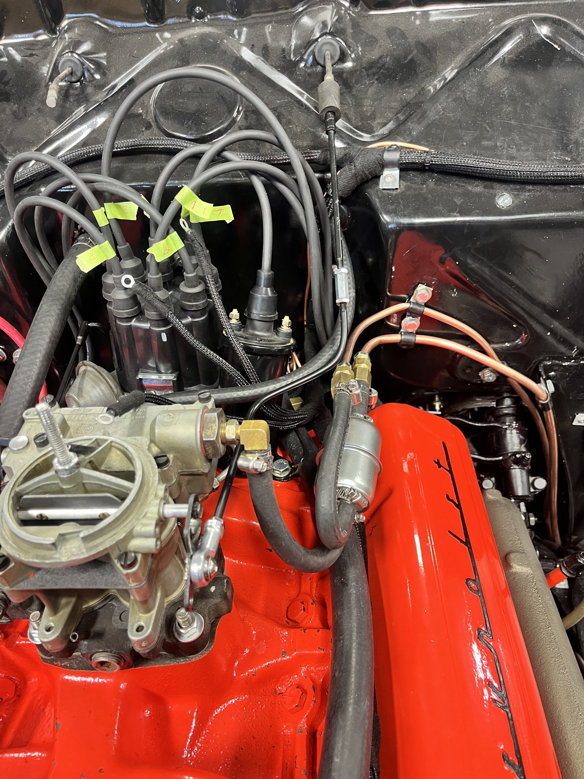

    Well, ****...I forgot to give updates, which I have no idea why I even TRY to guess on the timeline for my projects, but...after 8 days...the 283 is in and running.
    Rolled out of the back of the garage waiting for it's ride to Meeker's shop
    While most of the old wiring is decent, there are several wires that are beyond repair, so I decided to start fresh. Out it came!
    And so did the burnt up flathead!
    Getting ready to put the Powerglide ring, flywheel, pressure plate and clutch.
    Motor is sitting in the frame, but there is a problem!!!
    The extremely cool looking adapter that I have sets the front of the engine about 2" too high, leaving NO room at the back of the engine for my p***enger side valve cover or to even drop in the distributor. I pulled the mount off and swapped it for an old Hurst mount that Jim Pike had, and that solved the problem.
    I failed to get any additional pics from Tuesday afternoon until the "first run" video.
    Here's a video of the "first run"
    https://youtube.com/shorts/kDewnpmgWjI?si=O5xoVyRYh93d8e5X

    Upper: Gates 23234
    Lower: Gates 21505
    Alternator bracket is an Alan Grove and I am using a Gates 7508 belt.
    Also, when we removed the old fuel line and replaced it with 3/8" line, I used an ATC 3/8" x 1/4" compression fitting a few inches outside of the tank. I got it at the Ace Hardware store (mfg part number: 6JC120110701050) That seems to work like a champ.
    The radiator, I believe is a "Champion" 3 row that I bought on E-bay back in 2020, for $140. It was intended to go into the '40 stake truck, but I never got around to doing anything with it until now. ;-)

    Oh...and "YES", the carburetor is mounted backwards, so the linkage is on the p***enger side. When we did the initial swap in the '40 stake truck with my '58 283, I didn't want to change from the stock throttle linkage. After a little measuring, I realized if I used the lower hole on the throttle linkage, I could turn the carb around backwards and it would give me full throttle travel with the stock linkage. The truck still had enough power to bust the teeth of the 2nd gear, so I would ***ume that it didn't impact it's performance too much.
    winduptoy, dwollam and Tim like this.

    Posts: 2,809
    dwollam
    I run a WCFB 4bbl backwards on my 286 flathead in my '40. Been that way for years and works great.

    Such a smart move, I’ve been cutting and welding the Z bars to move the throttle to the correct side. Turning the carb around seems like a no brainer.
    Do you just run an electric choke?
    winduptoy likes this.

    My coupe and truck both have Edelbrock 1406 electric choke carbs. This Rochester 4gc came with the '57 283 that is in the car and still has a heat riser choke that isn't hooked up. I do have an electric choke set up on my '58 4gc, but it has a 5/16" fitting on it, and the '57 had a 3/8", which is what we ran from the tank to the carb. I'll likely swap carbs whenever I take the time to grab a 3/8" fitting that will work in the '58 carb and wire up the electric choke.

    Good call on the backwards carb thing. I did the same to keep the throttle on the correct side additionally it put the fuel inlet right where the the old flathead one was. I also converted the choke to manual as mine was the divorced choke with the coil in the manifold.
