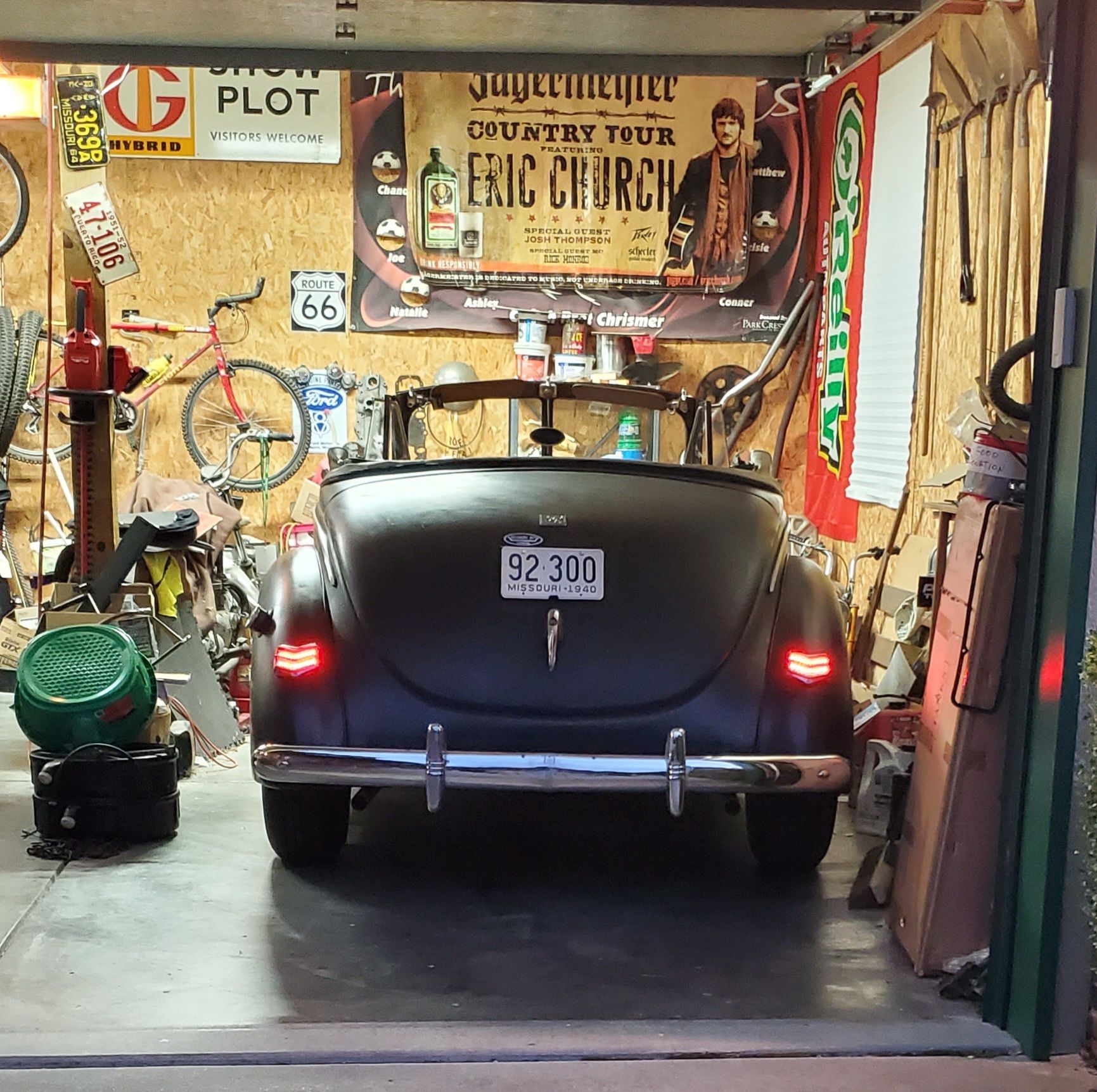

    Because '40 Ford stock tail lamps tend to direct the light UPWARDS, they are nearly invisible at night when they are on. I decided that I probably should steal the United Pacific LED lenses out of my coupe and put them in the convertible, and ordered a new set to go back into the coupe. Heck, I might even fix the p***enger side fixture in the coupe so it ALWAYS works now, too.
    This afternoon, I made a run over to the hardware store to buy some copper fittings to allow me to install an early Ford oil pressure switch in the 283, so all my stock gauges work with the exception of the volt meter.
    After fixing the gauge wiring, I remembered that Ben Sandy had given me some 60ohm resistors, so I soldered up a lead wire to run to my voltmeter, but haven't installed it yet.
    winduptoy, Tim, Stogy and 3 others like this.
