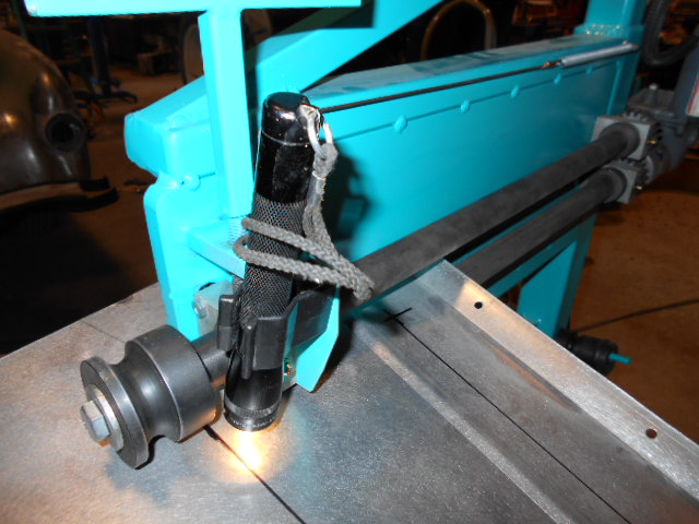

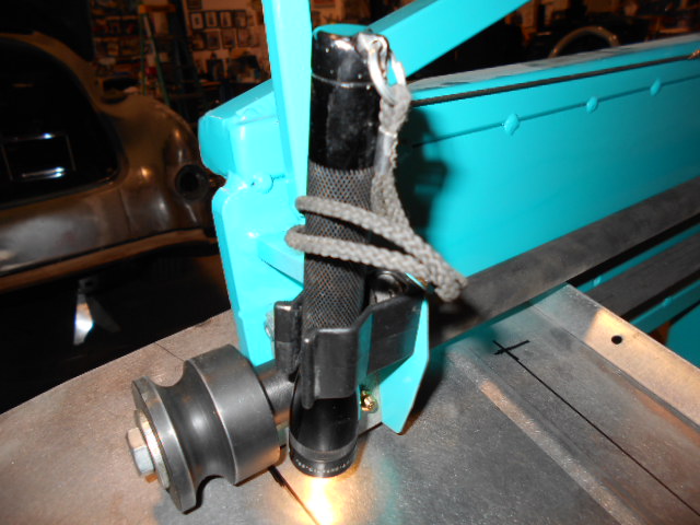

    While I was messing around with the bead roller I came across another little problem that needed a solution- my shop has high bay lights and they cast a lot of shadows. Since I couldn't use a fixed guide on the roller and had to freehand the beads I needed all the light I could get on the subject area so I made up a little fixture for my Maglite. Works pretty good and now I can clearly see the layout lines. I know you can buy a flexy mag base light but I've already got the Maglite (and the $30 it would cost for the other)

    Here's the maglite mod and an overall view of the beader. DSCN0966.JPG DSCN0967.JPG
