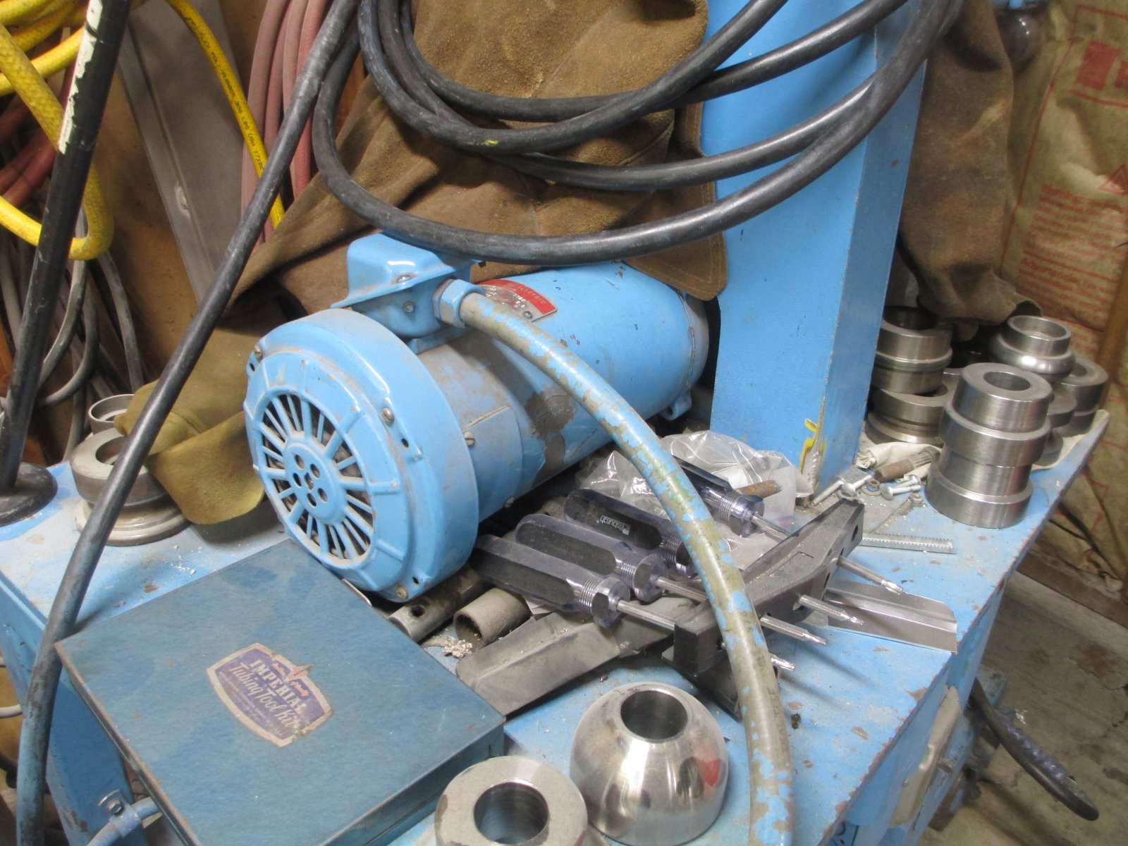

    1. Redoing my bead roller, Woodward Fab, got it braced so there is no flex and I got a question on the motor. I have 2 identical motors, they came off some kind of machine don't really know what kind. I had one hooked up direct and even though it's variable speed it was way to slow. Also they are not reversible or at least I don't know how to do it. I'm going to ad sprockets and a chain and try to figure out how to wire a foot pedal in, the box it's got has a know to control speed and to shut it off so I figured I'd eliminate it and wire in a pedal with variable speed. I'll try and post pics and maybe somebody will recognize these motors and shed some light on how to wire them.im no electrician. Also would 10 to 18 or so rpm be about right, I'm using bicycle sprockets and I need to figure out what size on those also.

    Hope this is pics.

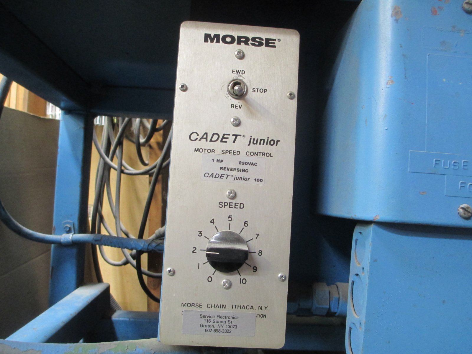

    This is what I use on my DC motored bead roller. There is one on EBAY for 200. The good thing about DC, is you can slow it down without a loss of power. IMG_9915.JPG IMG_9916.JPG

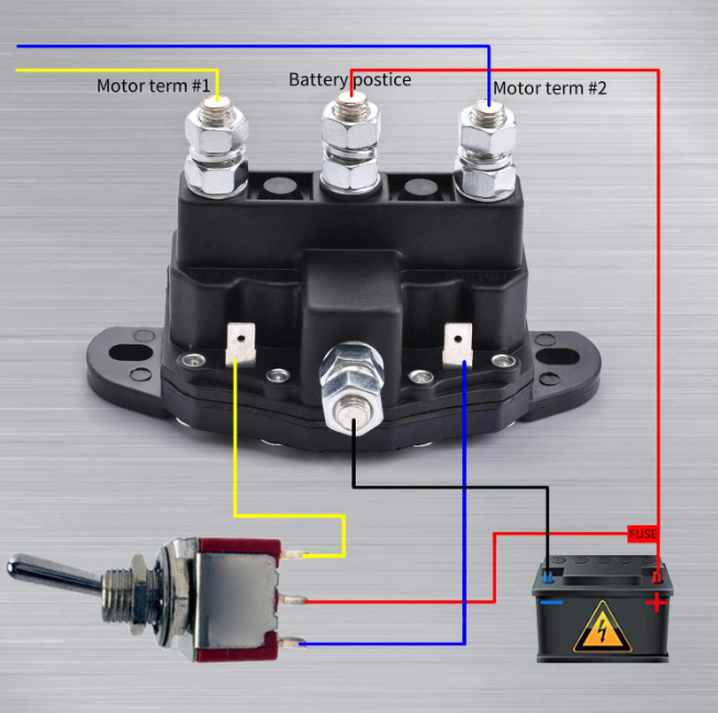

    A 12v winch is an easy method [with a 218:1 reduction planetary gearbox] for a bead roller
    D/C motors can be connected with a simple relay
    cheap here : https://www.amazon.com/dp/B08CD9SJ4S/?tag=atomicindus08-20
    The toggle switch can be subs***uted for a rocker "foot pedal" switch .

    I’m confused Marty, the controller says AC and the motor looks like an AC motor (can’t see the name plate) but you mentioned DC.
    Would you clarify for me?

    Budget, it is a Niagara machine, and yes it has a DC motor. The foot pedal operates only as a switch, with the speed controlled by the rheostat. IMG_7843.JPG IMG_9923.JPG
