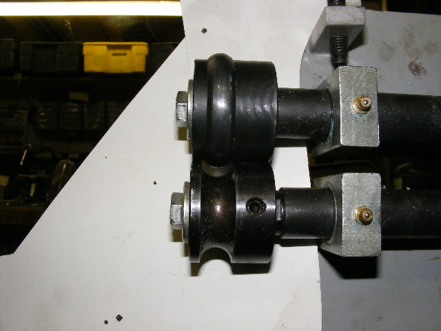

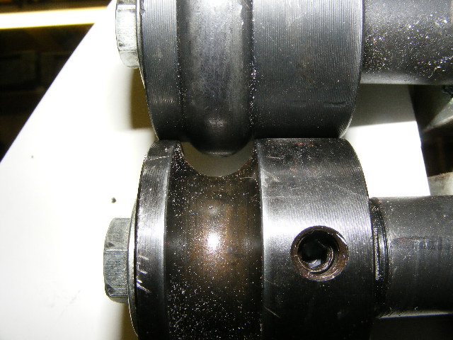

    I would try pairing up your largest male die with your next size smaller female die. If I understood Lazze right in that video, that's what he was suggesting, and it makes sense. In fact, I'm going to try that on a piece tomorrow just to see how well it works. No matter what, keep working at it, and you will land on a technique that works for you. Keep us updated on your progress.

    "I would try pairing up your largest male die with your next size smaller female die. If I understood Lazze right in that video, that's what he was suggesting, and it makes sense. In fact, I'm going to try that on a piece tomorrow just to see how well it works. No matter what, keep working at it, and you will land on a technique that works for you. Keep us updated on your progress."
    Yes I seen that and will experiment with that idea soon...............................

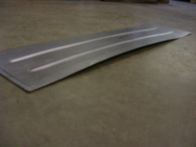

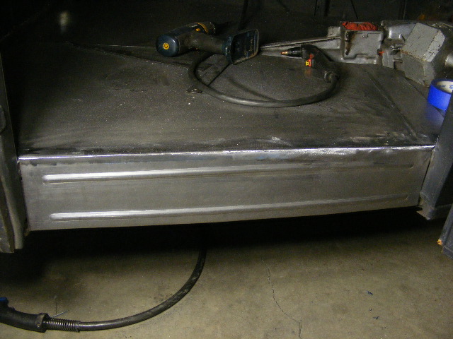

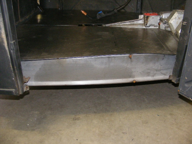

    OK, Got to play around a little bit more today with the roller. Needed a 27"x6" 18 gage sheet for the door threshold with just 2 beads. Something very simple I realize! Since I haven't had time to buy some tools mentioned in this thread I used some info here instead. I reversed rolled the beads lightly, flipped it over and finished the bead, than "coined" the bead ends with a makeshift gasket cutter just like the big boys. After all that I even rolled the bottom edge inward to give it a more finished look. It seemed each process got the panel a little flatter, enough so that I didn't have to do any m***aging afterward. I am still getting dimpled lines along the sides of the bead caused by my dies rear shoulder digging in, will have throw them in the Lathe and round them off. I know, Baby steps..................................
    EDIT; Forgot to mention I did pair up the biggest male die to the smallest female die, like mentioned above in another post and in the video.......................

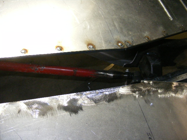

    Got the floor and door threshold installed, I have some shrinking to do in the "field" of floor panels to get it to lay a little flatter. Do I heat a dime size spot and hammer or heat a dime size spot than air cool with compressor or heat a dime size spot and quench with a cold wet rag? What are the good & bad of each process? Thanks................................................

  12. brigrat
    Joined: Nov 9, 2007
    Posts: 6,056
    brigrat
    from Wa.St.
    You had me up until the last pic!
    Which of the 3 processes I mentioned above do you like using? Since you only mentioned Hammer does that in your eyes rule out cold air and or a wet rag?
    Believe me I know how long it takes to respond to a question especially as detailed as you are and it is very appreciated! Thanks.........................................
  13. I've said that for me and me skill set that heat shrinks are like planting roses with a back hoe or killing flys with a shot gun. Meaning that it makes way more work , ****ogy:: patching backhoe Ruts and shot gun drywall damage vs a spade to plant and a fly swatter to squish them.
    Heating then Hammering the rise seems to work the best and easiest. Quenching the red hot spot with a rag makes the steel hard to work again or further.
    Why don't you post up a pic of the floor with some marks where you think the heat shrinks would go. Maybe one of the other guys more proficient can chime in.
    Why did the last pic throw you?

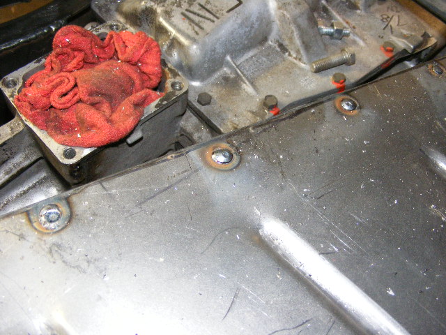

    I've been brainstorming how to do my trans tunnel too. Came across this pic rotten Leonard posted which inspired me to think different. Although I don't want to build the tunnel like Leonard did, I realized I could make it in two or more pieces
    I think what I'm going to do is 'roll form' the tunnel in two halves (running lengthwise), and put a step in the center with the bead roller for the two panels to intersect.

    brigrat
    from Wa.St.
    DSCF7787.JPG DSCF7786.JPG Not my style of tunnel either. Started making a wood buck the shape I need, will make a card board pattern over it and try to transfer that to 18 gauge. Maybe need more wood support in the middle but haven't figured out how to get that angle...................

  21. It looks like /appears the firewall side of the Buck is not a true semi circle.
    That's going to make your buck & tunnel and life more complicated.
    It's not, but-
    If it were a true semi circle, the buck mid way standard wound go at 45* and be exactly the same size as the center with the inside corners cut at 45* and the paper/metal would roll right around- you could probably do that over your knee.
    In your case the mid standard would still go at 45* with the corners beveled the same however the taper of that standard would be different than the center with the firewall side being taller. Taller means that there's physically more wood (obviously) than the center standard. Logically and a natural consequence of this is that there needs to be more paper, more metal there at that point than the center. How is it that you can have the center with less metal and gradually adding more metal few inches around the curve ???
    3 ways-
    1 The center needs shrunk so the sides HAVE more metal surface than the center ,,,
    2 the sides need stretched so the sides GET more metal than the center ,,,
    3, the the tunnel needs to be in two pieces with a joint down the center. Here The weld joint would be straight, but the patterned pieces would be gently curved and forced into a straight line
    For a visualization, Take a plastic funnel and force it out of round to simulate your curve change on the fire wall end. You'll get 3 ugly bumps or a triangle of deformation.
