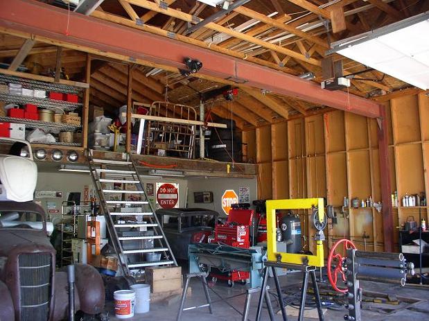

    rassled a beam into my shop Saturday,
    should make life easier,
    picking bodies, frames, engines and whatall
    the posts will get braces angled from near the top down to the floor
    prolly 2" pipe at about 50 degrees...
    and a one ton electric hoist

    I used a 28' stick of W12x26 for the main beam
    but you could go lighter if you didn't need to make it so long or pick anything too heavy..
    I just handed my spec's to one of the engineers here to give me a load capacity..

    ok, just got some numbers back,
    W12x26 ASTM A36 28' long
    with factor of safety of 2
    Failure= 7157 lb
    I spliced my beam at the center,
    didn't have a trailer to carry the 30' sticks..
    so I beveled the joint for a full pen. weld used 70-18 rod
    and added a 5/16 plate to the bottom flange at the splice
    so it may be a little less than his number..
    I do believe this should be able to support two tons safely though
    and will shop for a one ton, maybe ton and a half hoist.
    that should be plenty for a little home shop.

    Exactly what I want to do on a smaller scale. Only need to span about 13' and will be using a hand powered hoist. What size beam do you think I could get away with for pulling engines or lifting the front of a car? Maybe "get away with" is a poor choice of words, but I obviously don't need something as big as yours?
    Also do you think the uprights need to be I-beam too or would the right sized tubing work?

    That stick of steel took more than a little rasslen to get it in and then up into place! That beam "only" weighs 728 pounds! Not too shabby work. You have to let us in on the pictures of HOW you installed it.
    I'm jealous! Your garage is too tall for my neighborhood.
    With that beam, what else are you planning on building in your "garage"? Are you planning on installing an Allison in anything or building a jet engined car for Bonneville? If you are you sure have the capability to lift whatever.

    The right size tubing would work fine, after all they hold up houses with lally columns.
