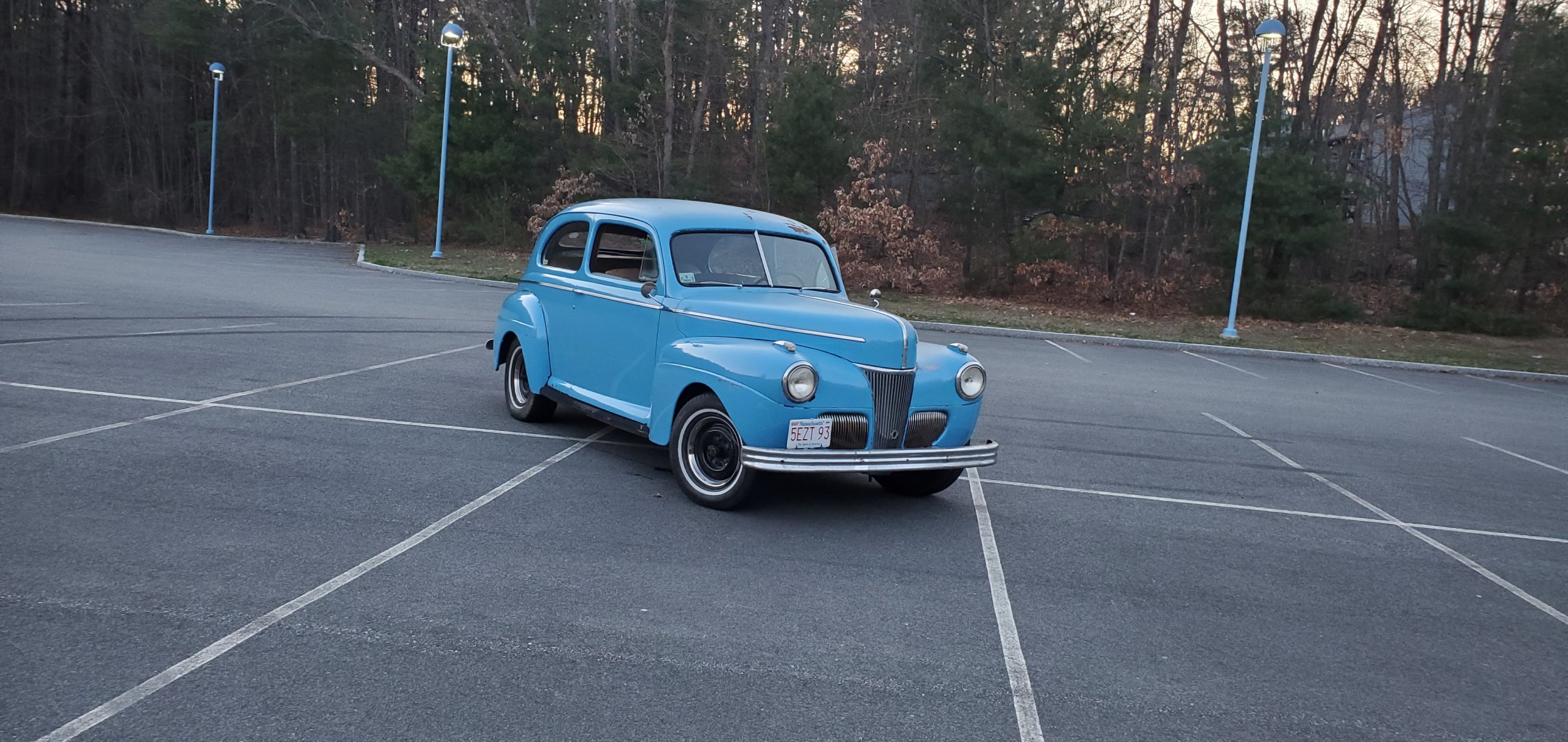

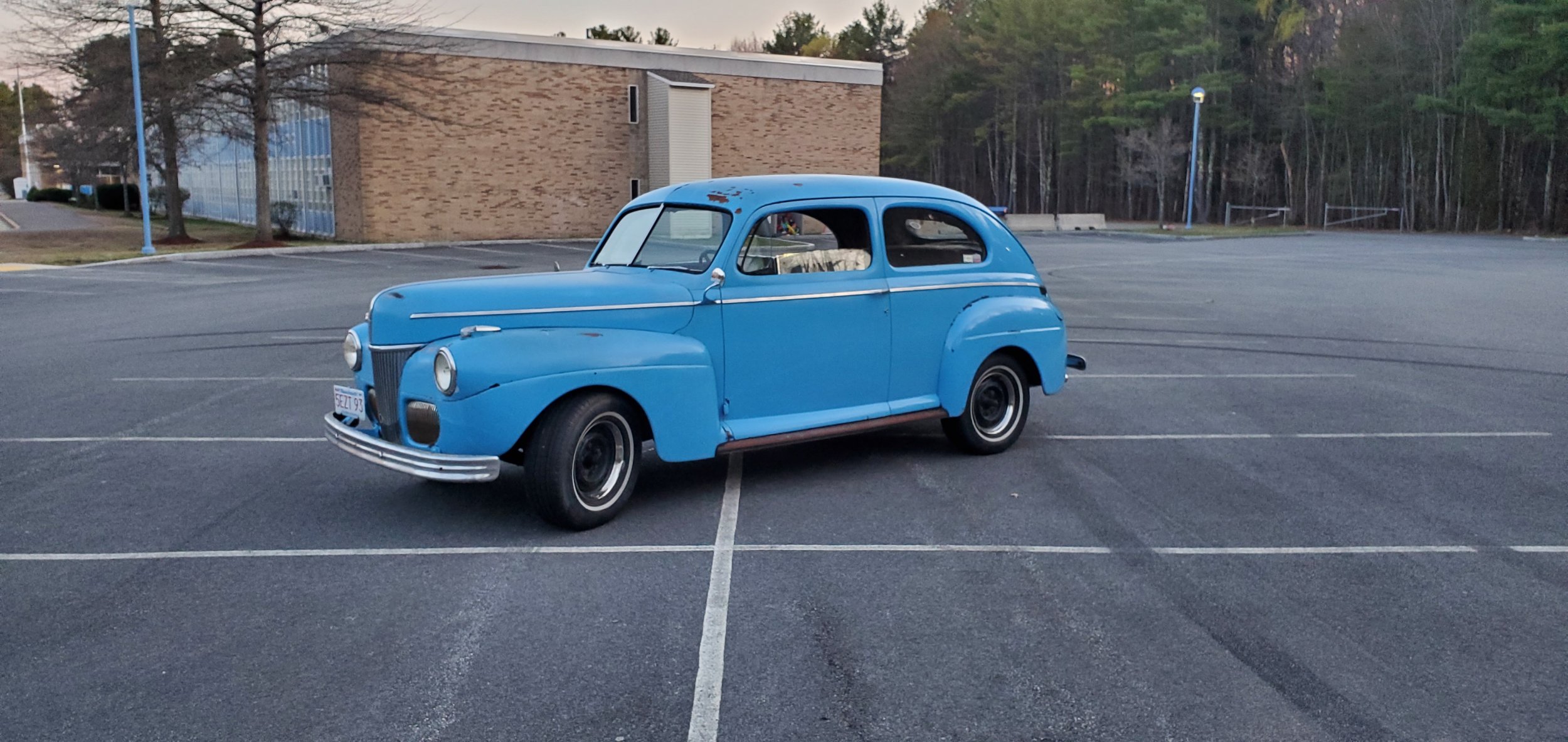

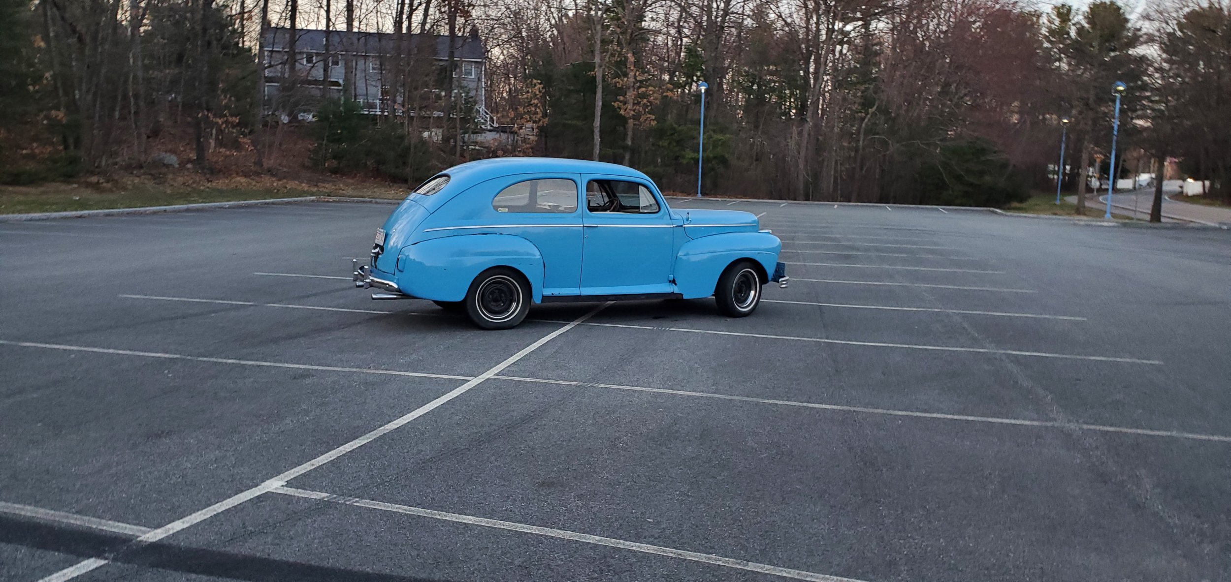

    Bean machine is on the road. Finially took it for its 1st real drive today. 20250417_192741.jpg 20250417_192752.jpg 20250417_192805.jpg
    I think the car definitely needs a clutch, still need to install the taillight harness in it and redo some brake lines in it. Gonna change all the soft lines in it just for my piece of mind, probably will redo the oil filter lines on it too, simply because I don't like how whoever did it last had done it.
    I have a question for the more experienced than me, would it be easier to pull the trans off the back of the engine with it in the car or should I pull the motor out the front of the car?
    Car makes me very happy overall.
