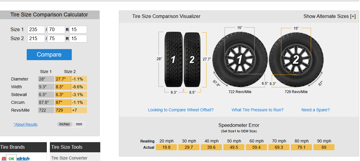

    Fun looking cruiser. On the tire size thing. Play with this tire size comparison chart a bit.
    A 235 tire is going to be right at 9.3 inches wide no matter what the aspect ratio is A 215 will be about 8.5.
    https://tiresize.com/comparison/ It's interesting to play with and helped me pick the tires for my 48 the other day. Screenshot (1276).png

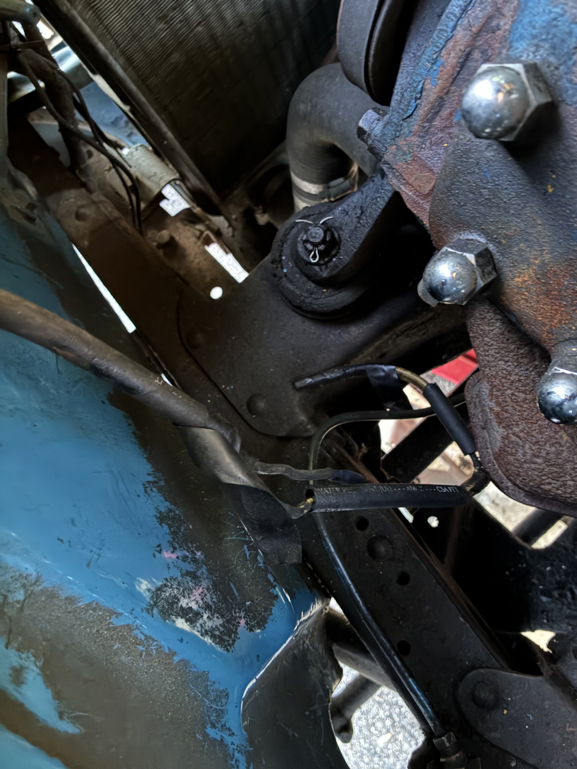

    the big thing though, tonight I was trying to fix my issue with the lack of brake lights and I have figured out the actual problem. The entire wiring harness has been completely butchered in the car. Parts are spliced and hacked up, there wire nuts in it everywhere. Every non factory wire in it is black, there is 0 guesses in it to top it all off (something I find very scary) in conclusion there I think I’m going to end up re wiring most of the car, I wanted to start cleaning it up a bit today however I don’t want to go cutting **** willy nilly without knowing what things do/ where they go.
    I’ve found some photos of diagrams on Van Pelt’s site, however the resolution isn’t great on the photos and I can’t quite read the text on them, does anyone here have higher resolution scans of them?

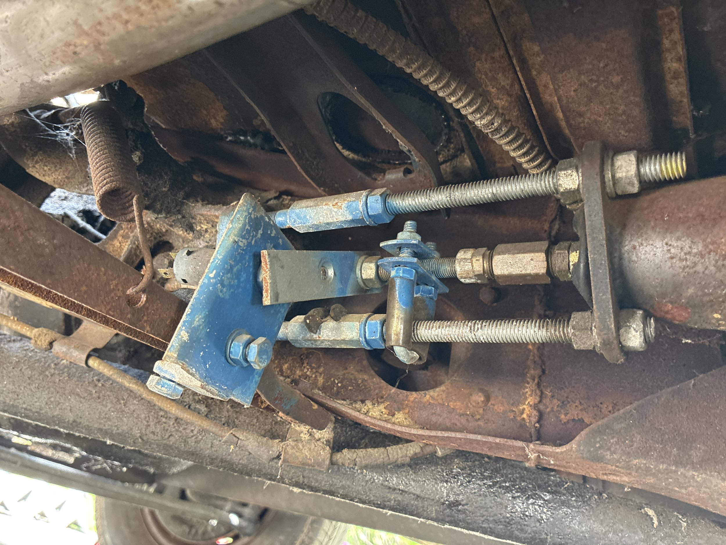

    I think another part of my issue I am having with the brake lights is the really questionable power brake setup someone has installed into the car, it has a very one off bracket to push the master cylinder far enough back that the booster can fit between the frame rail and the X frame, it has an odd taillight switch setup on it that may or may not actually function correctly. To top all that off it had a really ugly vacuum canister poorly mounted to the firewall, I’m removing all of that, going back to manual brakes and an original style switch. I think it will not only make the car simpler but also help aid in being able to fill the master with fluid.

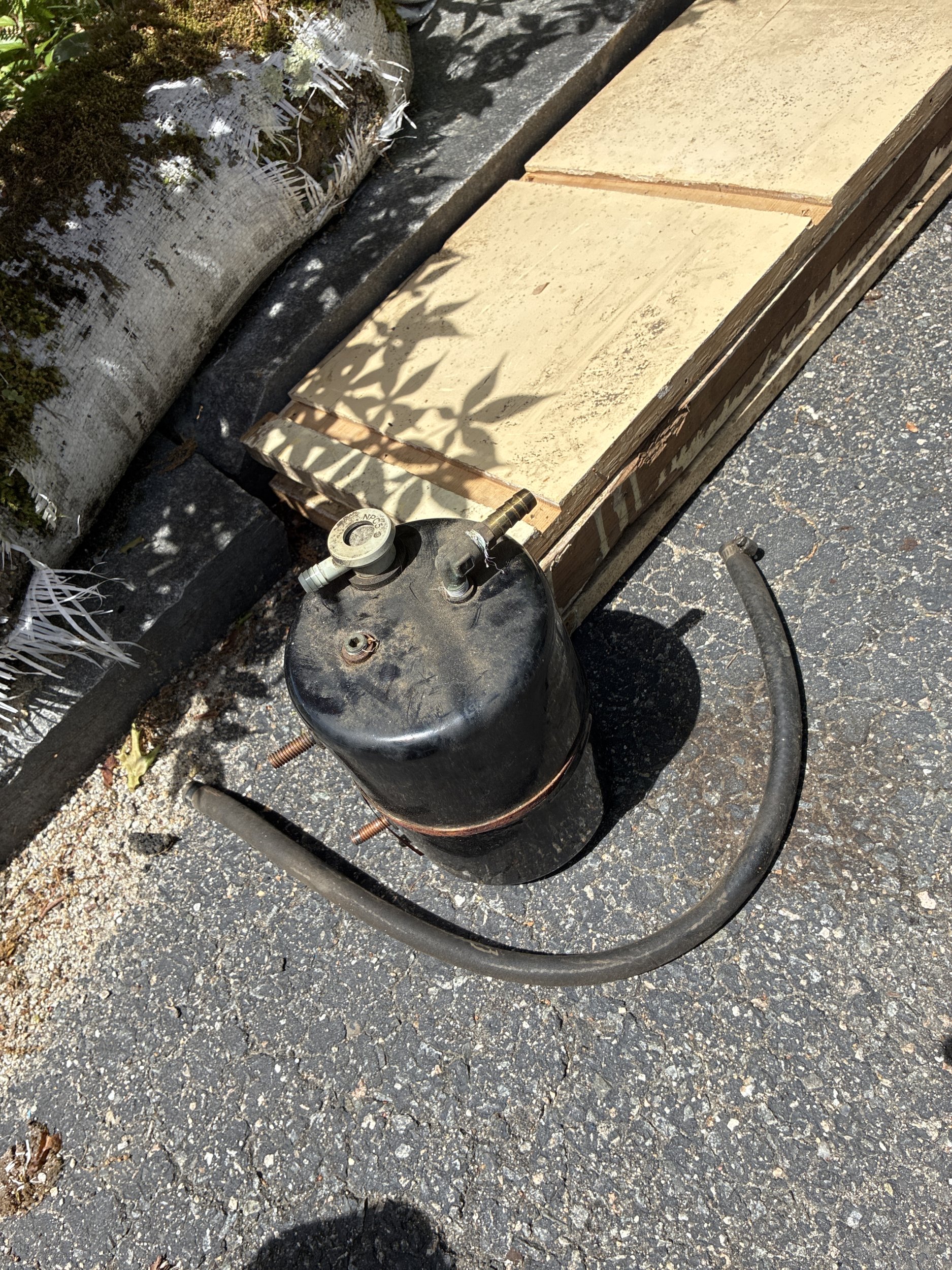

    have been having a ton of gremlins with the fuel system on it, put a pressure regulator on it to help the carb not flood, 3 different carbs that all seem to be… not great. None seem to make it want to idle. Despite that I’ve put a couple miles on it so far, everything else seems to be pretty ok except one of the brakes sounds like it is metal on metal.

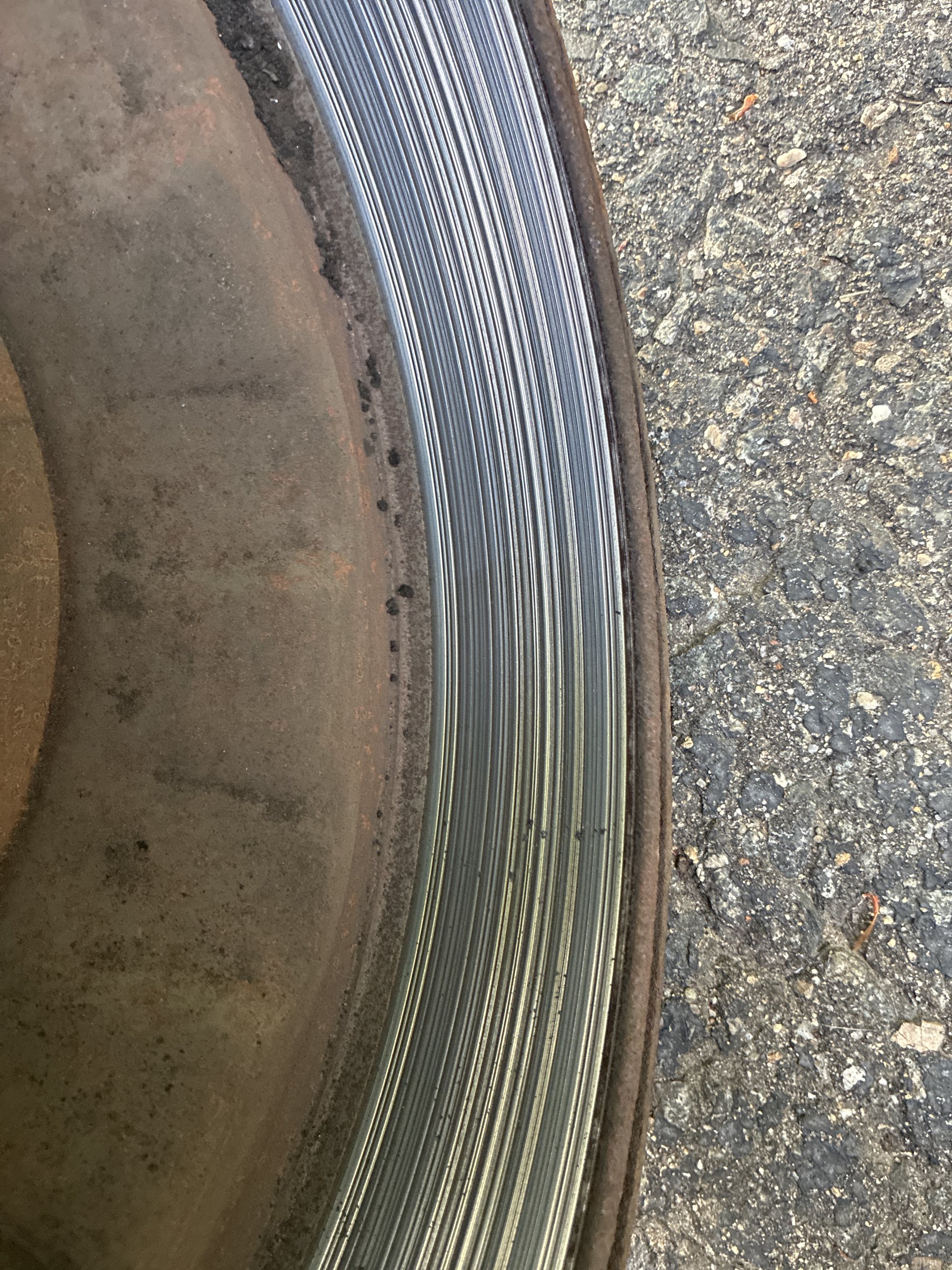

    I have pulled it apart and found this
    I think I’ll call that “suboptimal” getting new shoes is no problem, millworks has them on their site for I believe $80, they’re somewhat local so I’d probably have them in a day or two and could bang it out after work. However I’m not putting new shoes on drums that look like that lol. I think they’re grooved too much to turn even, not that I know of anybody local that turns brakes anyway. I’m kind of weary of buying aftermarket parts for things like this on these sorts of cars.. I’ve been down the road with **** Chinese parts too many times before as is. So I’m not quite sure what I’m going to do yet I guess.
